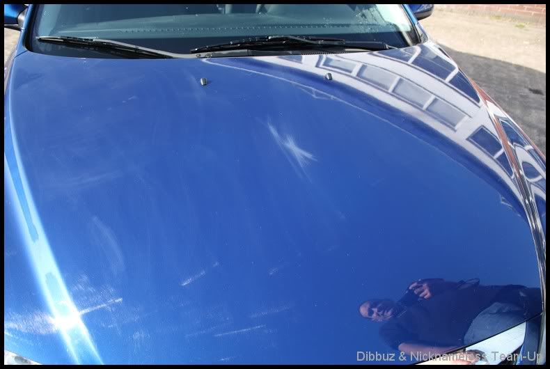

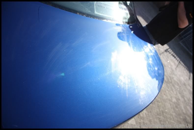

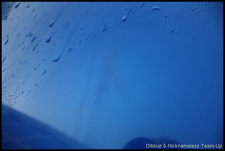

    The car is been washed with an abrsssive sponge by a women....
    I do not know the English word for it, but it is the same as below...
    Pics taken bij member "Dibbuz"

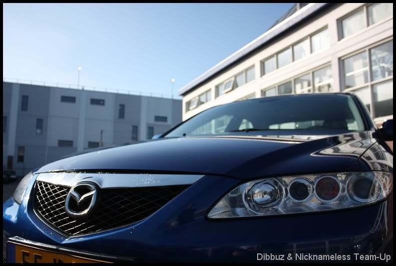

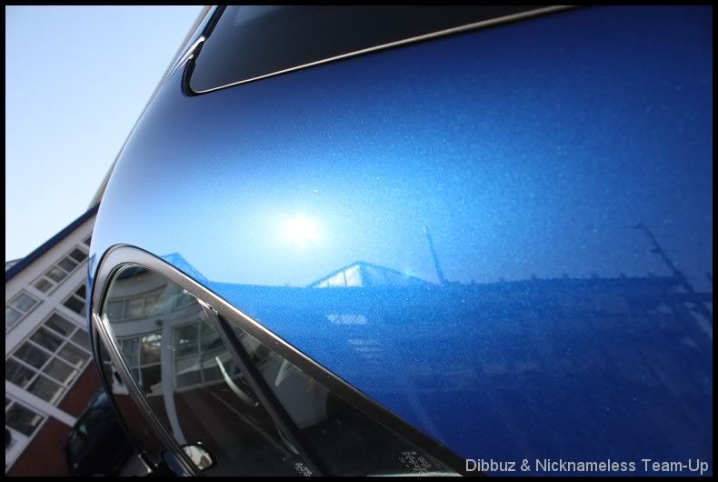

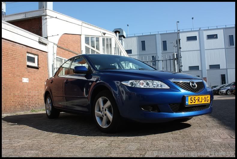

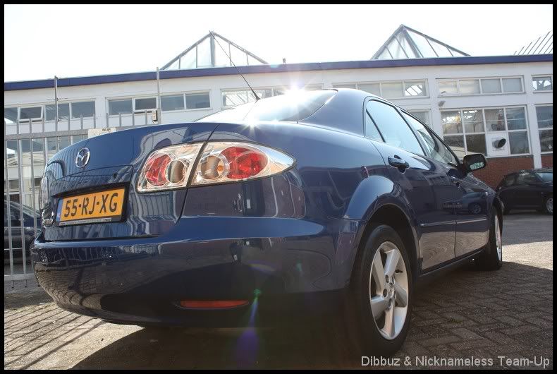

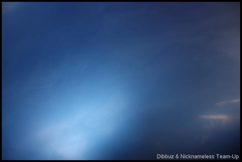

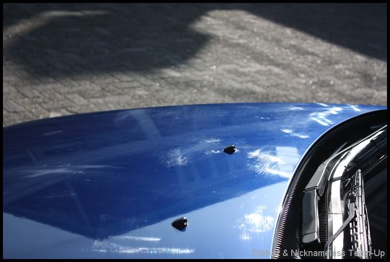

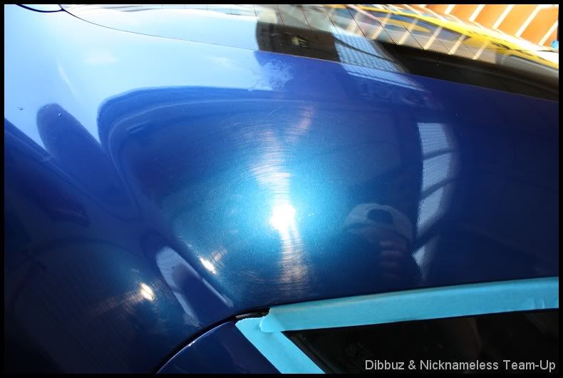

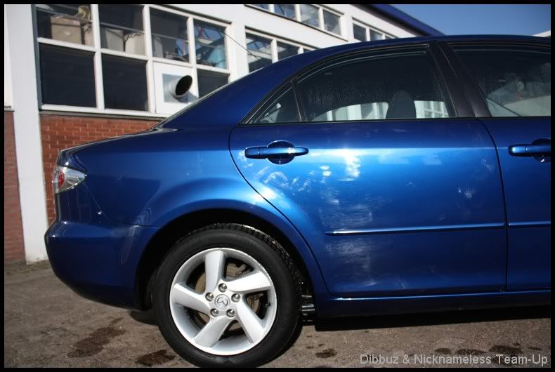

    From a distance, the car looks beautiful.
    But if you look closer...

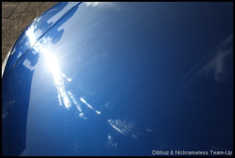

    Heavy clay was needed...

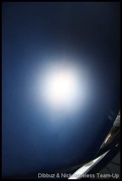

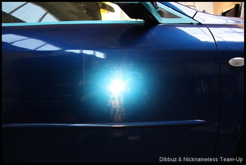

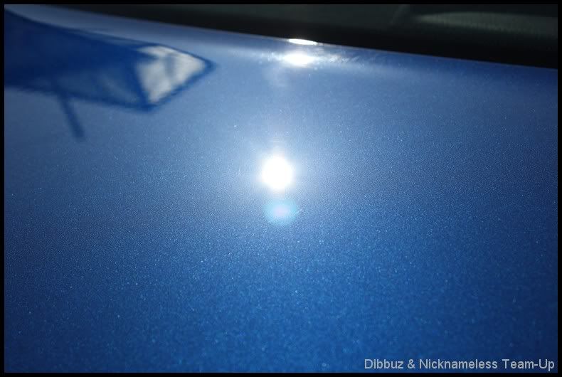

    Paint after using the claybar

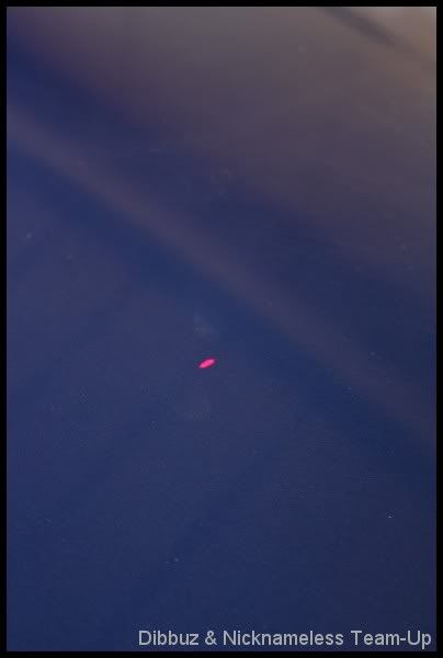

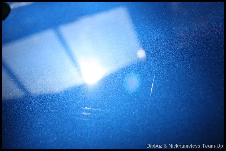

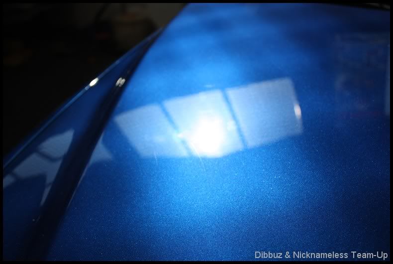

    We used a laser to mark the same spot. So we can messure the same spot after wetsanding
    Wetsand gear

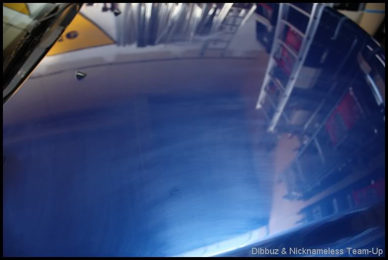

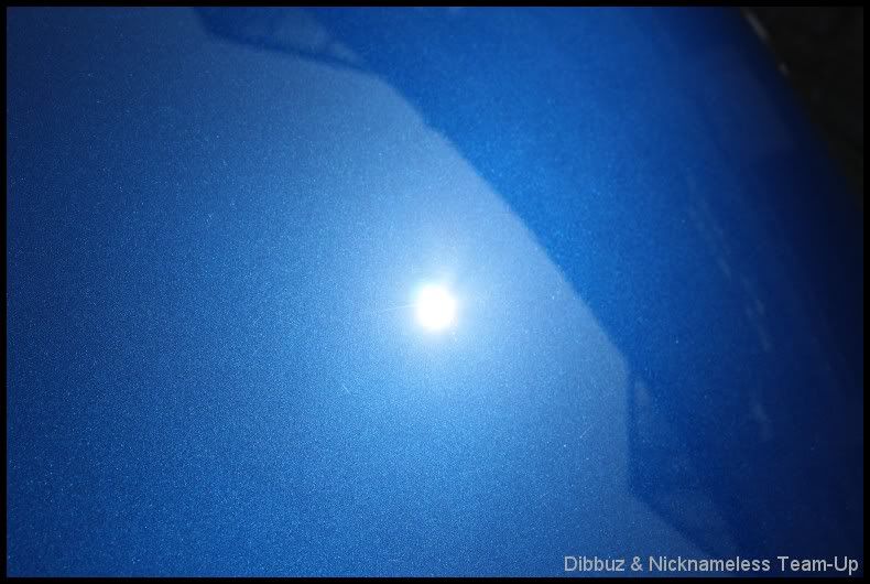

    Before sanding
    After sanding

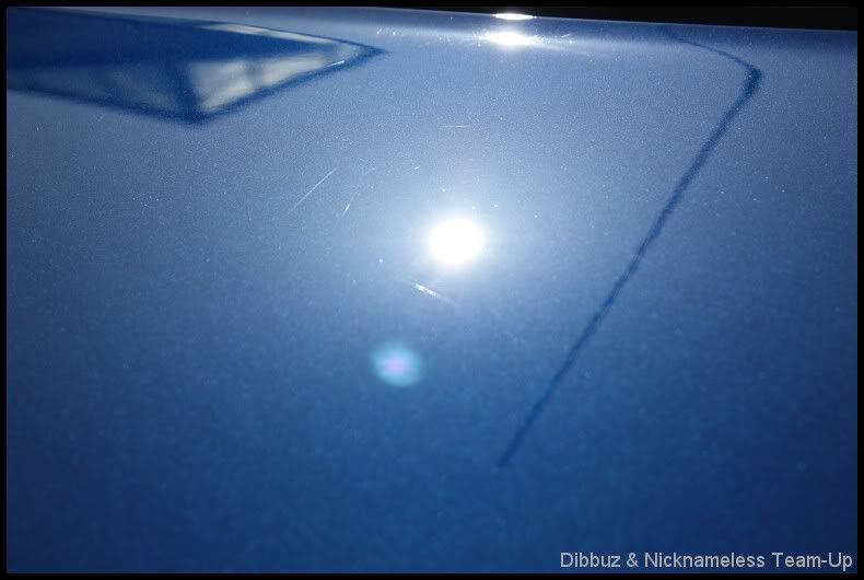

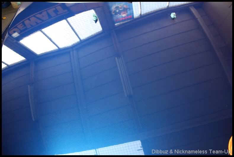

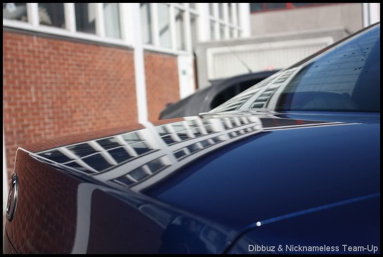

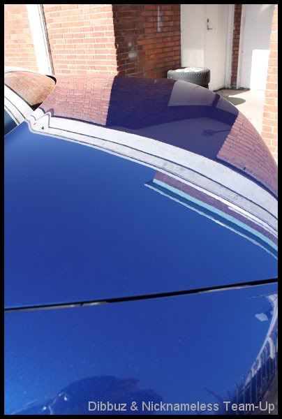

    After polishing
    We could not take it all out...we did not had enough time....

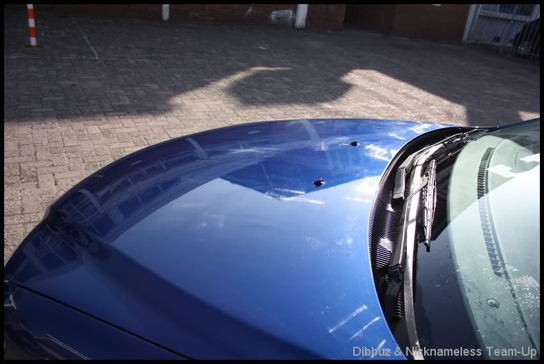

    50/50
    Before
    After

    Wash the car after polising to get the polish dust of.
    Nice beading, only after polishing the car. There's no wax on it.

      OMG!!!! HAHAHAHA! We call that sponge "Un Brillo" here in DR that thing is used to wash the dishes.. I cant believe she was washing her car with that. Where is peoples common sense? hahaha...

        On average how much clearcoat did you remove?

          Very nice! I hope you educated her on how not to wash her car, confiscated the sponges. We use those to scour pots and pans. Looks great!

              What a tremendous improvement. Hard to believe she was using a scouring pad on her paint. Great improvement guys. Way to go.

                      If the car is wet, you don't see the damage of the sponge. Untill it drys ....
                      We took about 5-10 microns of the paint. Not much.
