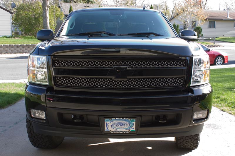

    So a good friend of mine bought a G110 a couple years ago but never had much luck with using it. After seeing the results I was able to achieve on his wife's vehicle, he asked if I'd be willing to detail his new truck and at the same time show him how to use the G110. I immediately though of Mikes phrase "each one teach one" and said no problem.
    I really had no intention in documenting this process as we were very short on time but after seeing the difference in the test spot the owner asked that I take a few....the amount of pics are very limited though.
    Since we were pressed for time only a 1-step correction would be possible and we decided to go with Menzerna Power Finish on the G110 equipped with white LC pad's. Some areas were hit more than once but this combo gave great correction and left no micro marring at all. After showing the owner how to properly use the tool I cut him loose, supervised for a short period of time, and then got to work on the other side myself. LSP was Blackfire Wet Diamond. After about 7-8 hours of work the end result was about 90% correction with only a few RIDS her and there.

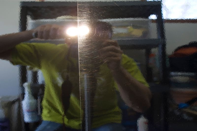

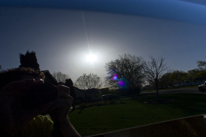

    50/50

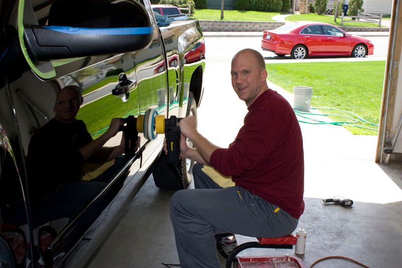

    Owner hard at work...I'm sure his arms are sore today!

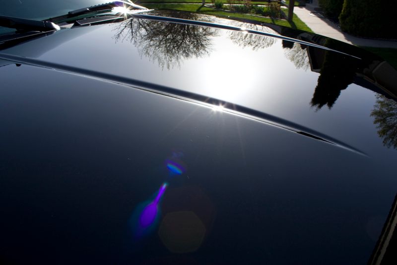

    All done!
