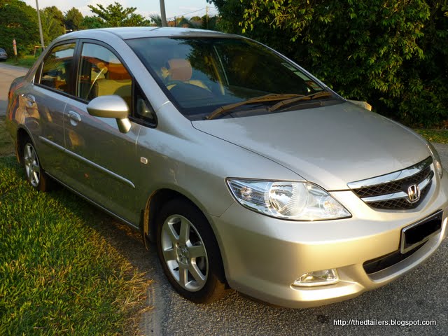

Honda City just detail by KC -perfect is always spell as PASSION
  • Honda City just detail by KC -perfect is always spell as PASSION

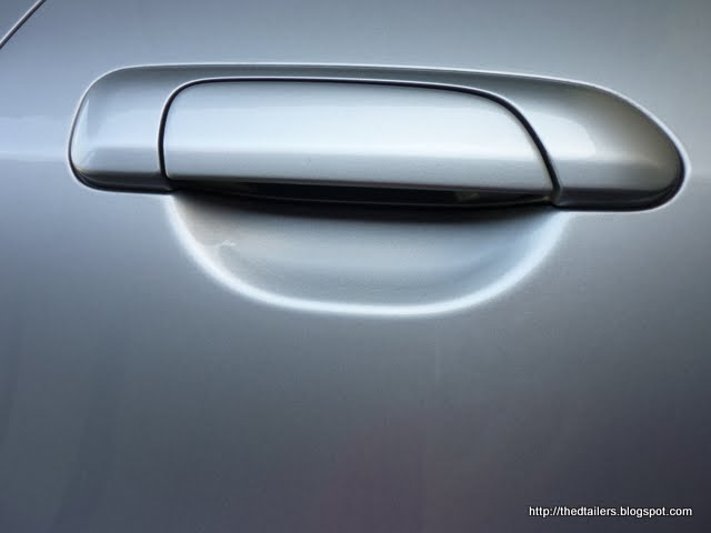

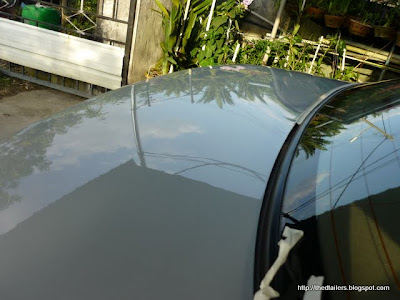

    Just Barely 2 years old - visible swirls hardly found...except close inspection under sunlight...a very good colour for hidding swirls
    Mission - to restores her to show room condition.:love:..this was my 1st detail over chinese new yr break

    under sun...not too bad looking

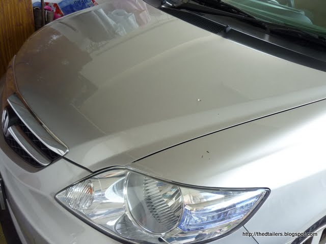

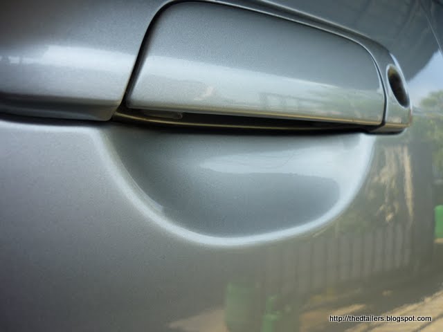

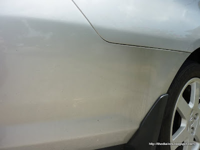

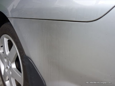

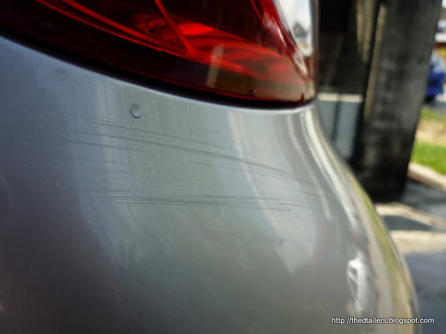

    just got it on CNY - 2 yaers old car - lady driver - fequently wash by road side car wash & resulting....swirls & deep scratches
    this is one of the rarest moments - finding swirls under bright sun light
    2 months not wash
    stubborn stains
    looking good from a glance
    wheels before
    a bit more before pics

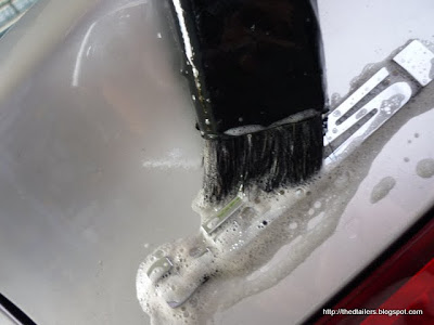

    Osren Multi purpose cleaner with assorted brushes to cleans emblem & hard stained area

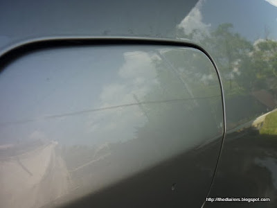

    Paint correction - Rotary with Lake country Yellow colour cutting foam for removing swirls & Random Deep isolated scratches (RIDs) with Meguiars M 80 Mirror glaze polish ....speed 600 to spread, 1000 with gradual movement & speed , finishing off at 1400 with moderate movement
    paint polishing - rotary & Lake country polishing foam pad at speed 600 to spread the products & Speed 1000 move moderately with pressure & backing off to speed 600 with light feathering off

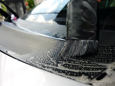

    Osren MPC at work
    mkore MPC at work agitating
    front bonnet plastic fender

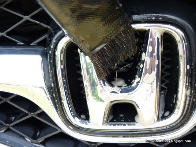

    front emblem cleaning

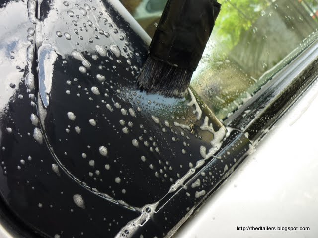

    d window frame plastic stained cover agtating with MPC

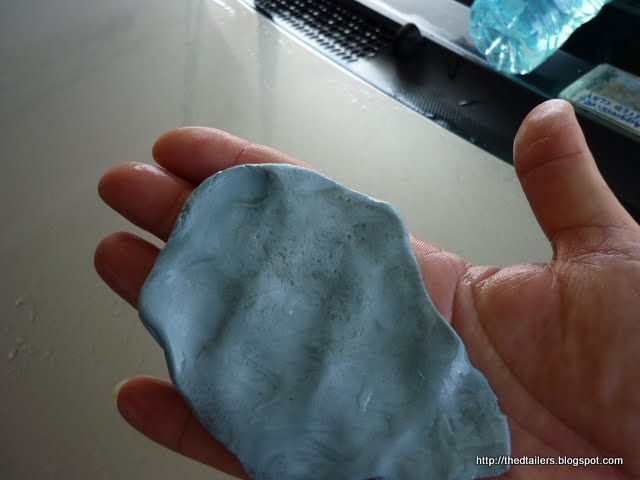

    claying - prior before paint correction to pick up - upper paint contaiminants - like brake dust, industry fall out & tar
    optimum no rinse wash diluton 2 oz per 450 ml of water as lube
    clayed pick up
    now after a clean wash...closer inspection on lower paint contaiminations
    lots of stains - hardly can be removed by mere washing & scrubing
    i tape to shoot this comparrison area (left before & right after)
    clearer 50/50 area
    close up picture comparrision on
    paint correction began - fuel cap area
    before

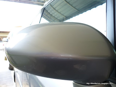

    side mirror before
    after detail

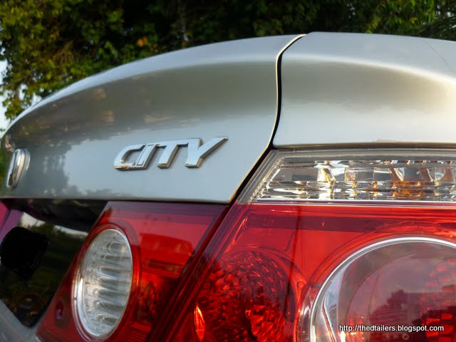

    some sun light shot at the rear
    side view
    before
    now the rear look
    ta ta ta
    side gloss restores & depth is visible

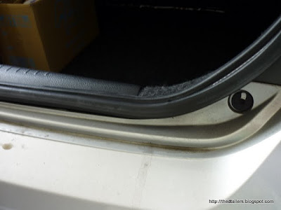

    door jam area -
