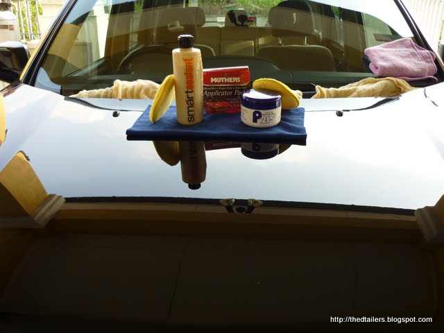

    this was his LSP (protectiion he choose & i as usual.....suggest another side by side ...so we had 50/50 now
    I told him how to fold his cobra micro fibers....edge in ....to prevent ...any side edge scratches

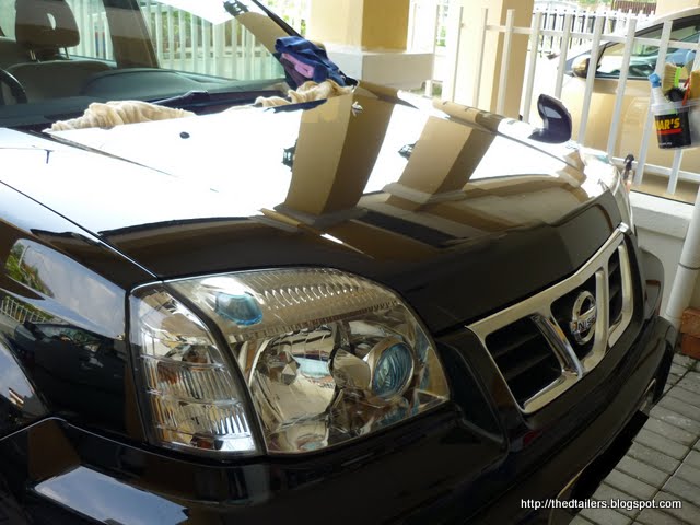

    This is what all driver long to see.....milki way galaxy ....
    this is one of the Renaissance moments....
    testing results
    just like stary sky
