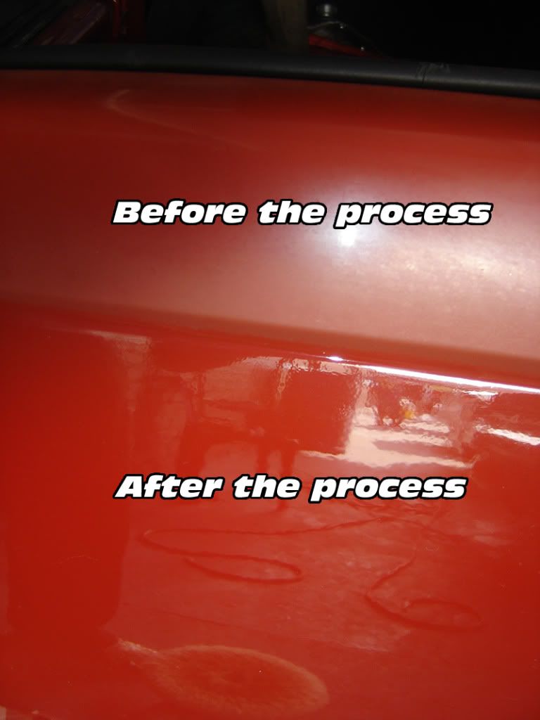

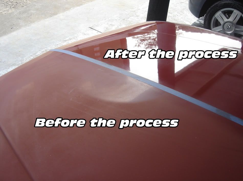

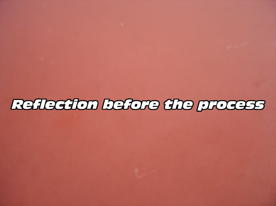

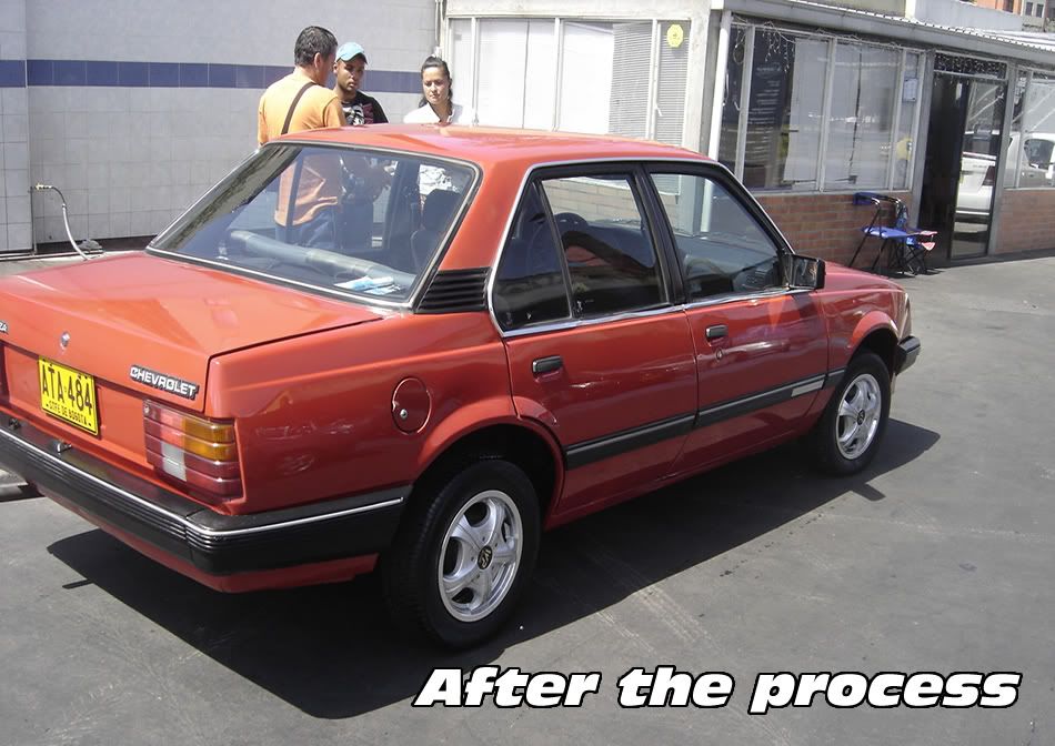

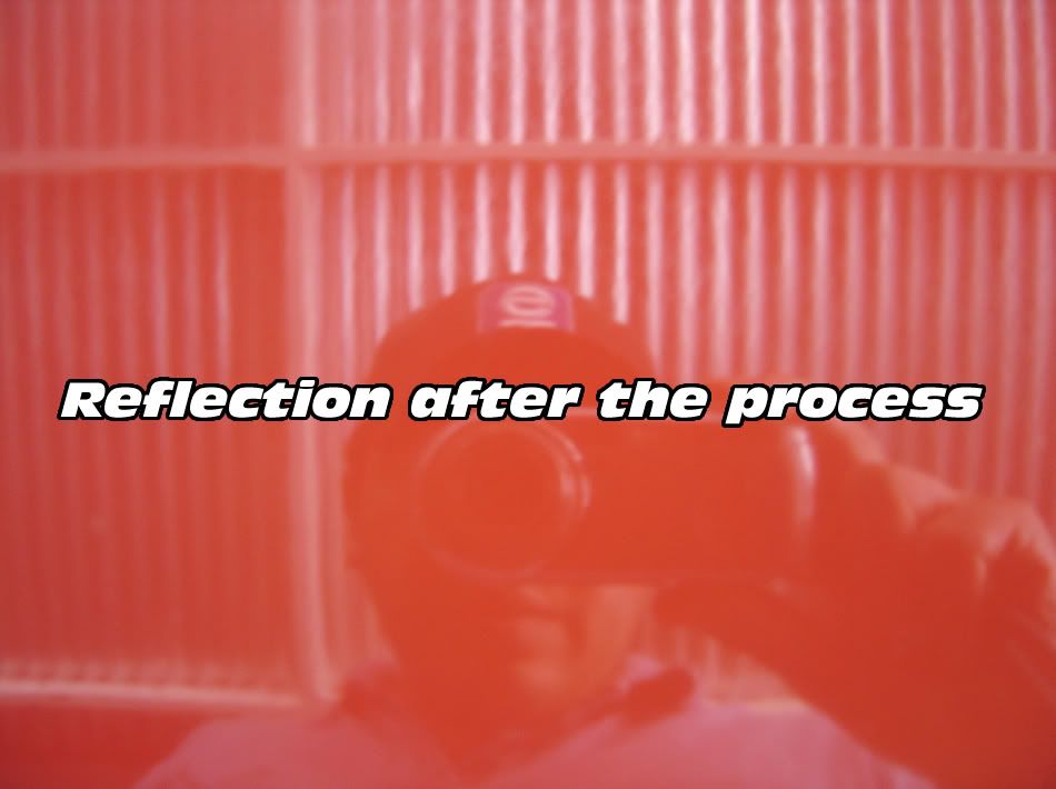

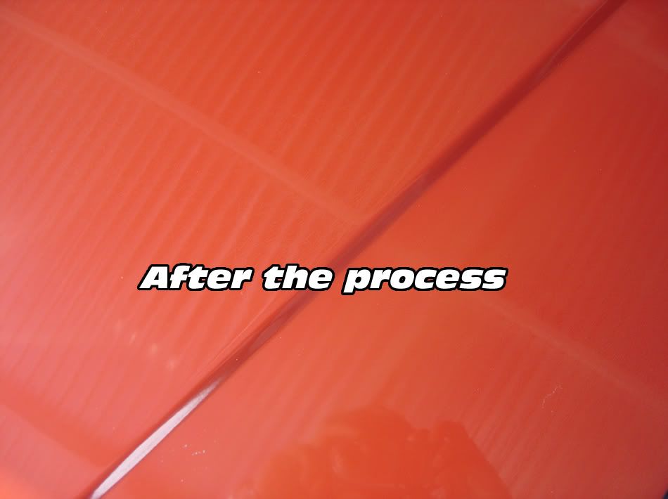

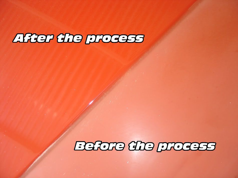

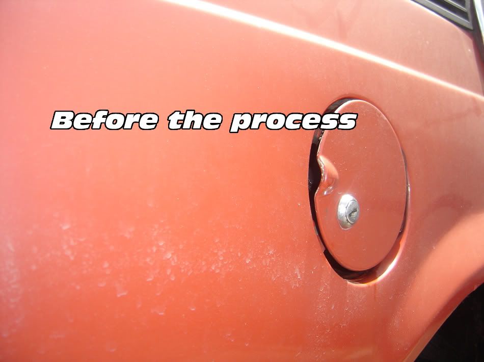

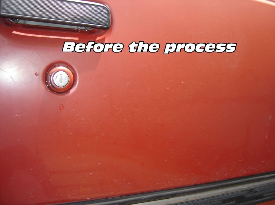

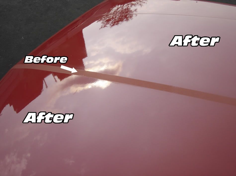

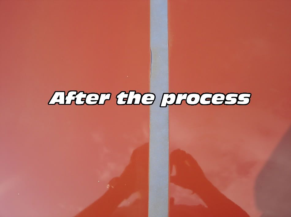

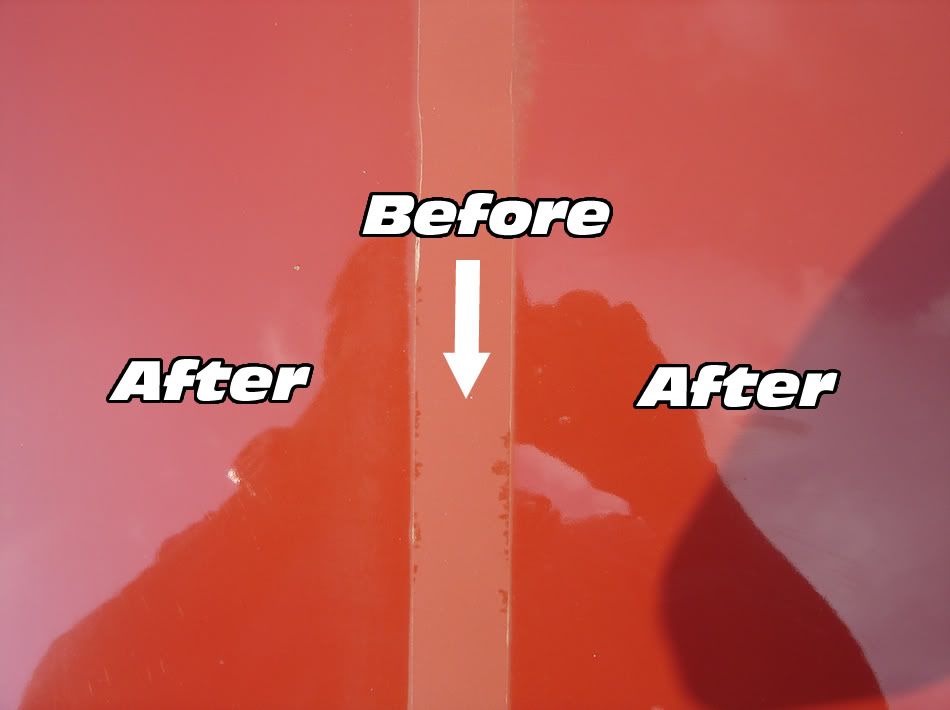

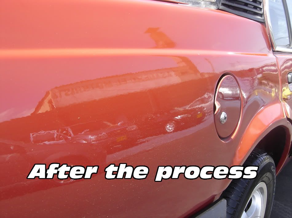

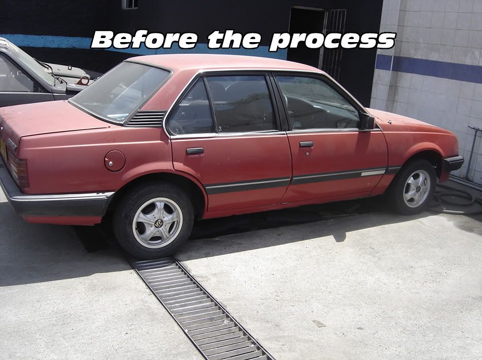

    Hi everybody this is our new work... Another paint restoration this work is from Bogota Colombia south America !
    :::: Duster Car Clean Experience ::::
    we just work with meguiar“s products
    soooo start!!!

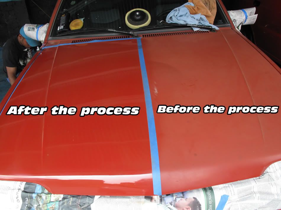

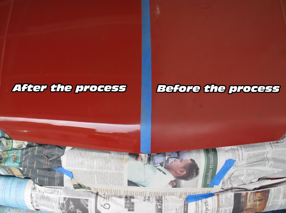

    Body process
    1. wash with meguiar“s gold class car wash
    2. detailing clay (red one)
    3. 105 ultra cut compound with rotatory and wool pad (1 times)
    4. 205 ultra finishing polish whit rotatory and soft buff 2.0 yellow one (1 times)
    5. Synthetic sealant with DA and soft buff 2.0 black one (one time)
    6. #26 with DA and soft buff 2.0 black one (one time)
    NOW THE AFTER A BEFORE PROCESS ON ALL CAR!
    THANKS A LOT FOR SEE MY WORK !!! SEE YOU IN ANOTHER DETAILING PROCESS!!!!
