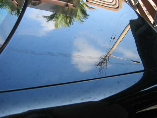

    very severe water stains

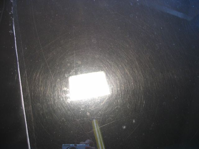

    more pics before...more severely scratch pics
    some correction request to be done
    severely scratched contributing from washing technics
    spotting contest????
    Decorated with water spot ....

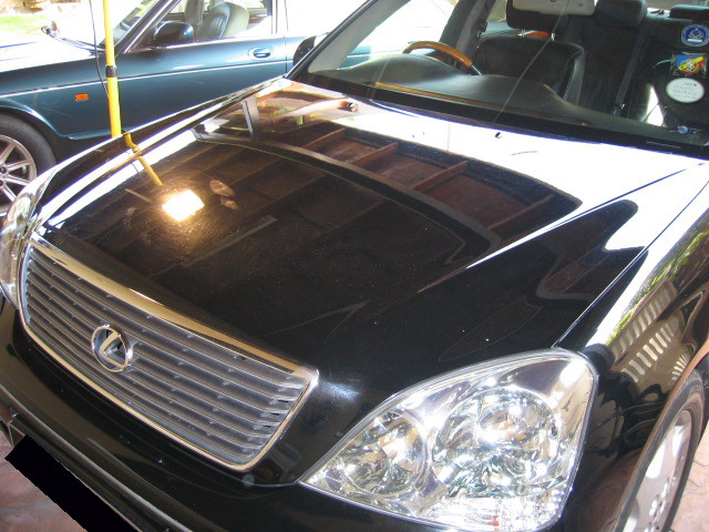

    clayed front bonnet
    a bit more after clay pics

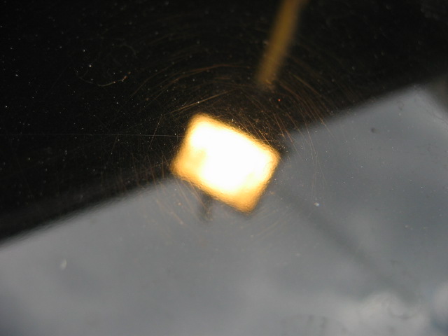

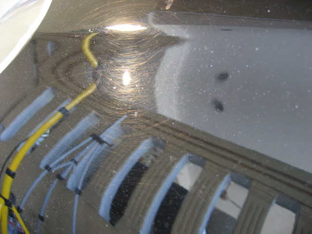

    pics taken from afar & the amount of scratch

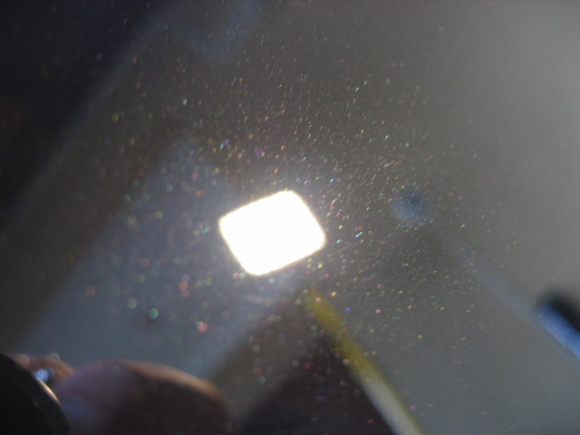

    Hologram is also visible
    visible swirls roof
    this is how it look like
    before pics
    close up pics

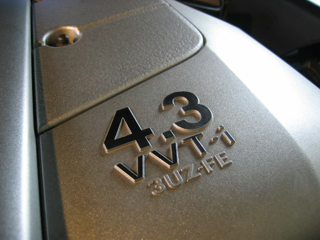

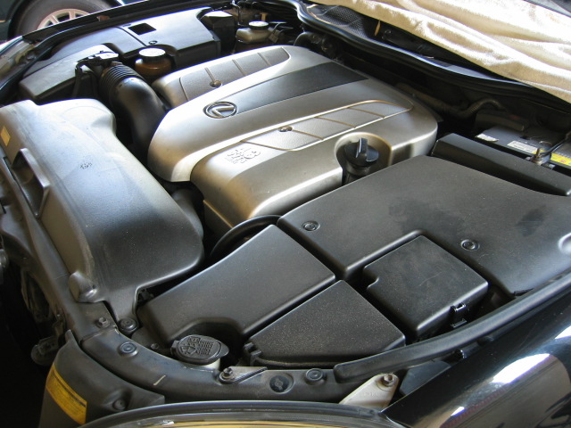

    pics of engine before
    pics engine before

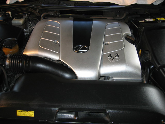

    before engine detailing
    after

    Menu for the paint work -
    ONR rinseless wash - 3 micro fibers

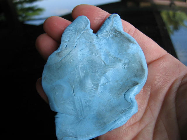

    Clay with mild clay - with ONR wash as lube
    Quick wipe down

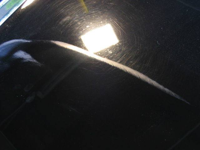

    Test spot....Lake country Cutting pad with Meguiars M 105 - speed 1 to spread speed 2 - moderate pressure - speed 3 slow movement
    resulting 80% light swirls diminishing, but RIDS aka deeper random scratches still very visible
    change to
    Lake country double sided pad with Meguiars M 105 - speed 1 to spread speed 2 - moderate pressure - speed 3 moderate & slow movement
    much more better results but some RIDS is visible 10 % left
    after 3 more passes with LC wool - seems more satisfactory
    now - only when the surface is clean ... wiping off with microfiber, paint begins to smear...night mare begun
    i have to back down with LC cutting pad speed 1 to spread speed 2 - moderate pressure - speed 3 moderate & slow movement
    change all to completely new micro fibers
    polishing with Lake country polishing pad
    Meguiars M 205 with Lake country polishing pad speed 1 to spread speed 2 - moderate pressure - speed 1.5moderate & slow movement
    finishing with
    Meguiars M 205 withlake country finishing pad speed 1 to spread speed 2 - moderate pressure - speed 1moderate & slow movement
    Meguiars M 205 with hand & NXT 2.0
    finishing protection with Meguiars M135

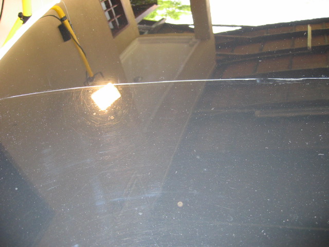

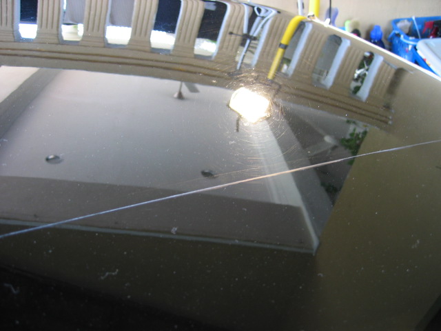

    RIDS still very visible ....as the deeper scratch has deeper roots
    wet sanding begins 2000
    sanding mark
    pics before 50/50 area set

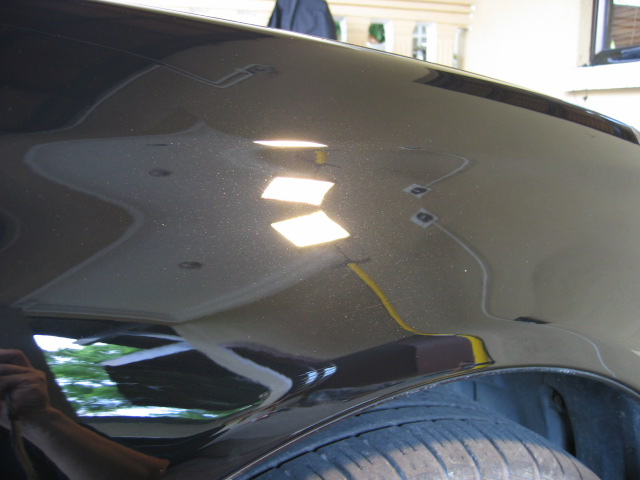

    the wonders of M 205
    after
    pics before....hard stain....water marks

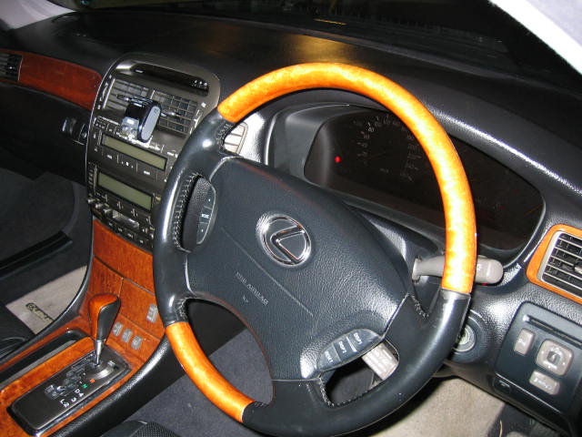

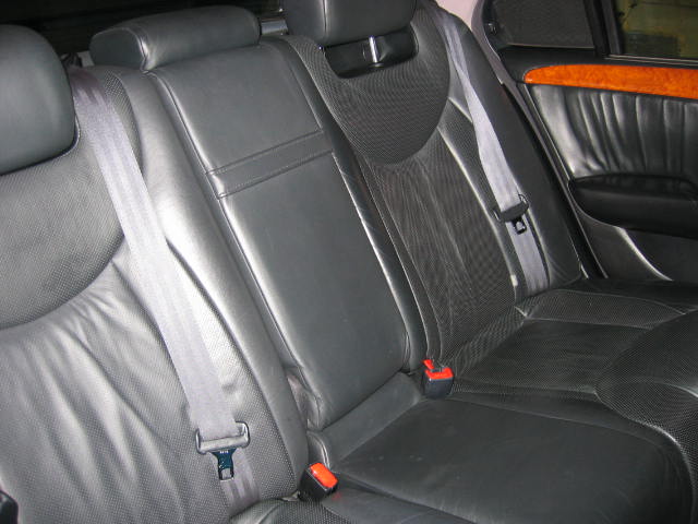

    did a quick interior detailing
    Wipe down
    Detail with meguiars Gold class Interior detailer

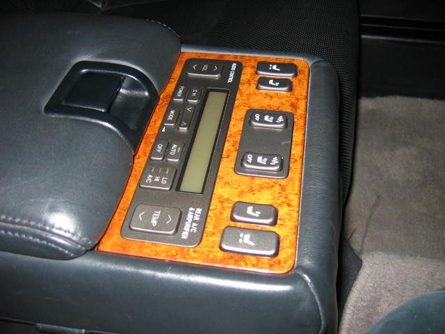

    i had an opportunity to sat at the most comfortable seats
    earlier this morning

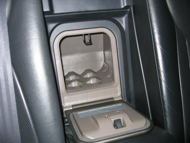

    i had the most luxurious ride....the owner son, actually on the massage chair & console at my disposal
    a chiller...that can hold ice cream
