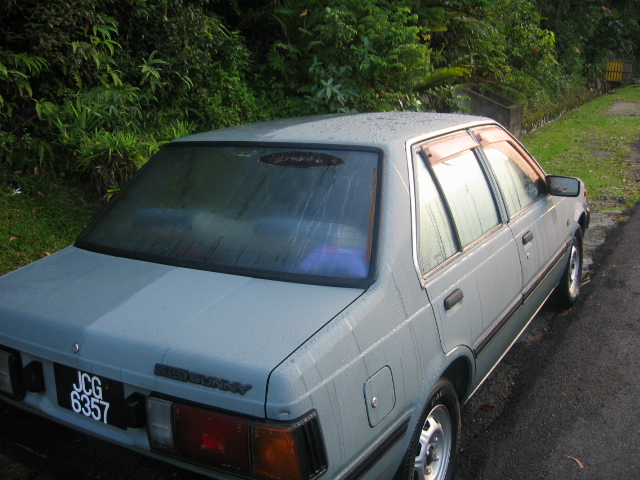

    What do u do when u see your car paint faded?
    oxidized, dull, dead paint....''boss mesti hantar cat la'' mean sorry - need to be repainted...no cure...that is what the paint shop(body shop) advise me -
    even the technician of a reputable international detailing supplies company
    tell me pls get itrepainted
    I was so shocked & i actually copy& paste d respond i got from MOL, he was quiet then
    I nearly gave up detailing if i have listen to some,
    front hood before
    back bonnet before

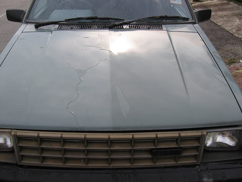

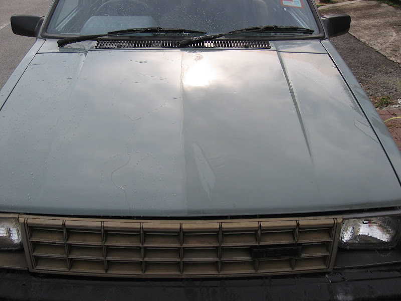

    water test?
    start to pour water
    1 sec later
    2 sec later
    3sec later
    4 sec later
    5 sec later

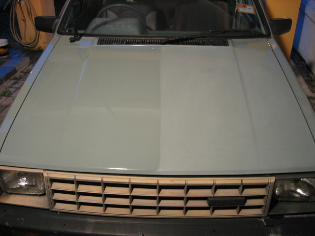

    detail side
    look from the dull side - no reflection
    ta ta - its alive

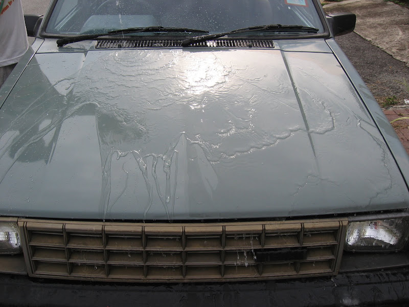

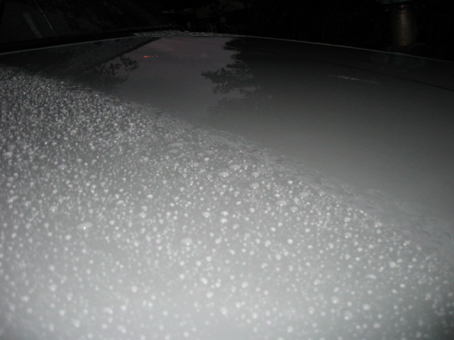

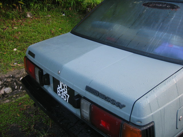

    rain test - water beading
    on the engine hood
    on the roof

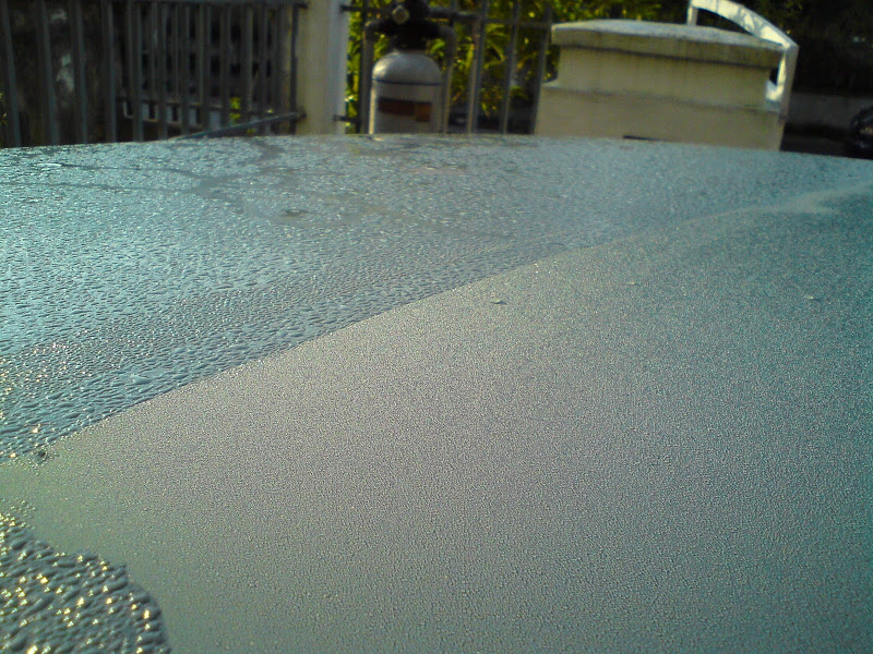

    the very next day - dew test
    close up
    my conclusion, a detail surface is a protected surface & test against the harsh envioromental test -
    before
    now
    before
    now
    before
    before
    now
    water beading well
    how i did it? just be deaf & stubborn to do what i have to do....with some effort & Megs 80, D 151, NXT 2.0, UQD & P.a.s.s.i.o.n

    AWESOME job!!!! I don't know how many times I have heard people say that the only way to fix the paint is to get a new paint job, when all they have to do is use detailing steps to restore the paint they already have!! Detailing works, and you have proved it with your hard work. Looks great to me!

        This is a fantastic testament to the benefit of detailing. 6 months later and it still looks like this? fantastic. Way to go, KC.

          LMAO I did this to my sister's black VW Jetta last year. I just saw it recently and the left side of the hood is still beading while the right side is still swirled up and nasty.

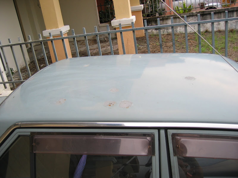

              Wow the outcome was fantastic. Nice job! Was just wondering about those stains on the roof of the vehicle... Do you think they can be removed with any of the products or would they seem beyond repair?

                that's stains is actually rust & some simple touch up paint ...its definitely beyond repair
