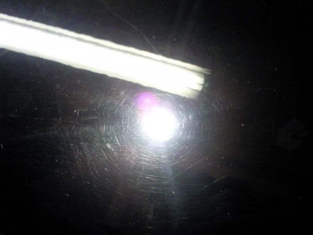

    Did this today, and it was a car that was purchased at a local auction. The owner didn't want me to touch any plastics/glass/tires/etc. Just wanted me to do the paint correction. I guess he always details his own vehicle but the paint correction was just outside of his abilities. So I did what was asked and here are the results.
    What I used:
    ONR wash
    Meg's Claybar
    Meg's M105 via rotary
    Menzerna Nano polish via rotary
    Waxed with Migliore Competizione wax
    Paint condition before any work:
    50/50 of hood (right side was left untouched, right side was after M105 only)
    After m105:
    pulled her outside just to see how well the M105 worked in natural light:
    A bunch of After:
