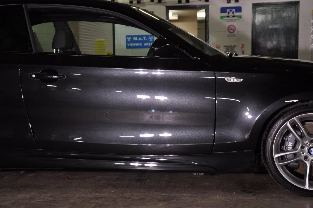

    The passenger door had been repaired for a scratch, and was showing machine polishing holograms from the repair work...
    The hologramming was showing up a little better using the metal halide lights...

    The passenger door that was hologrammed before, now fully corrected (different colour tone from adjustment in camera white balance, the flake in this finish was causing most pics in auto mode to be "washed out" such that you could not see whether or not the finish was free of marring so manual mode was used to give a better idea of the quality of finish):
