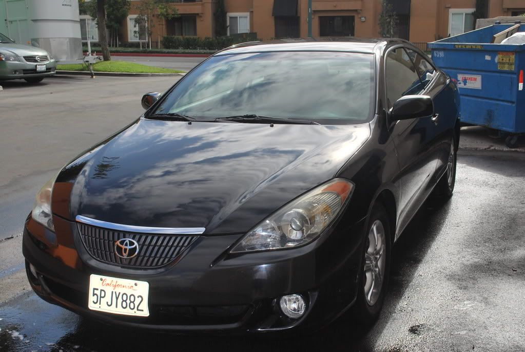

    I received this Toyota Solara to detail, and I have to say this car looked good from far far away, but up close it looked like a disaster. He had the car detailed 6 months ago from a guy on craigslist with a rotary buffer and the results were not good.

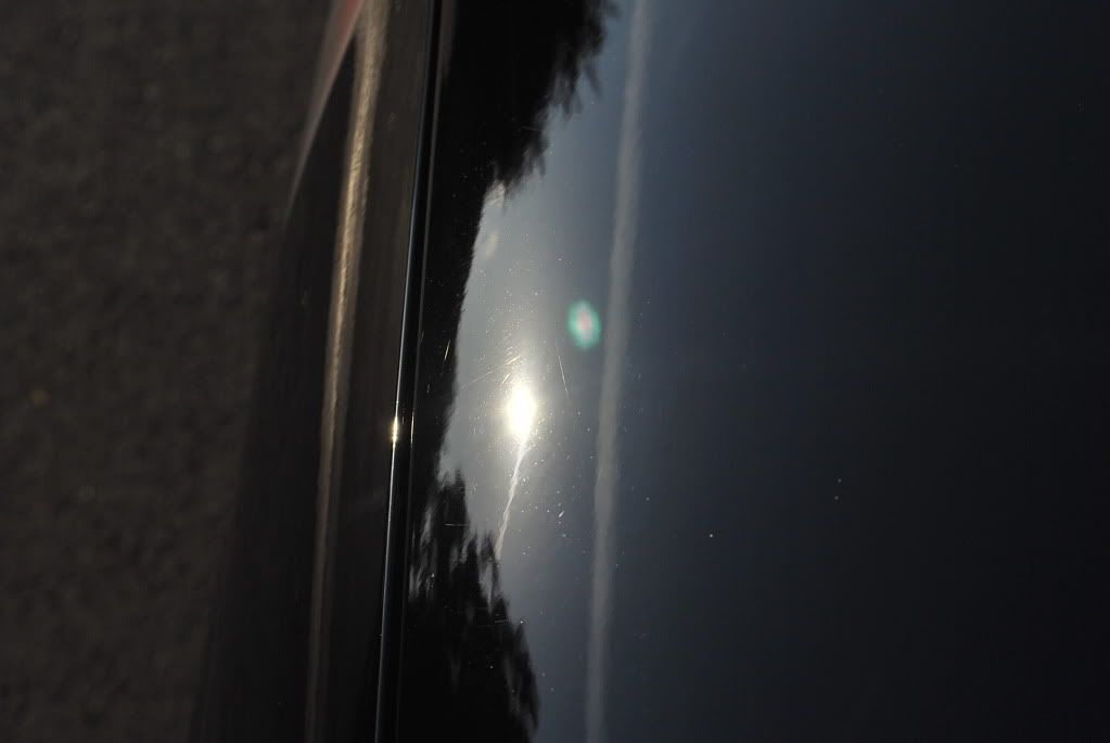

    Saturday morning, I thought it was going to rain.

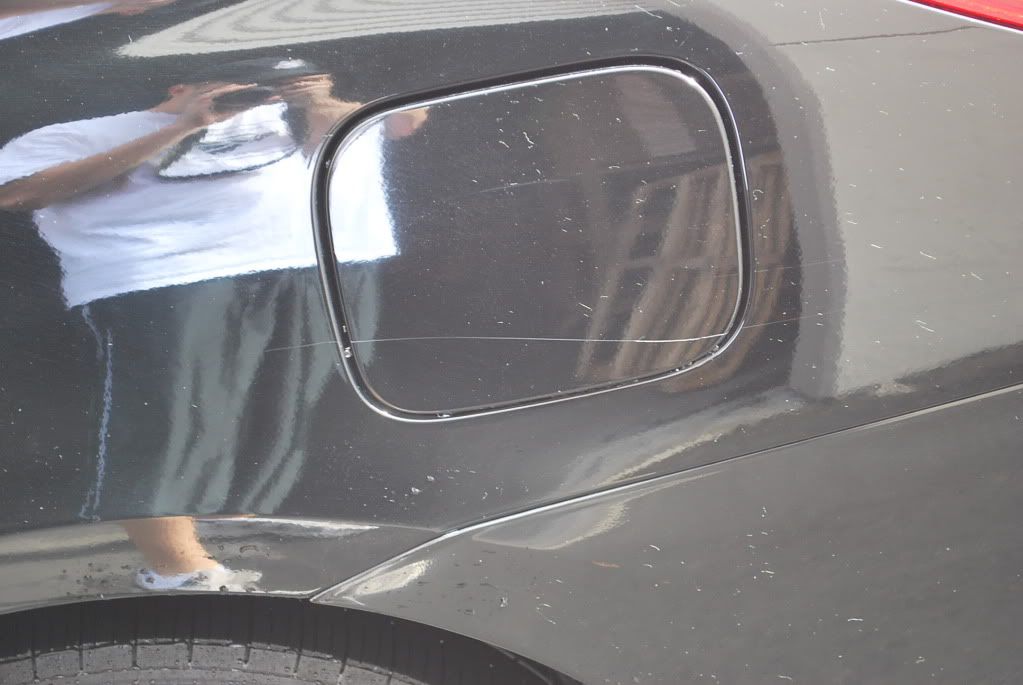

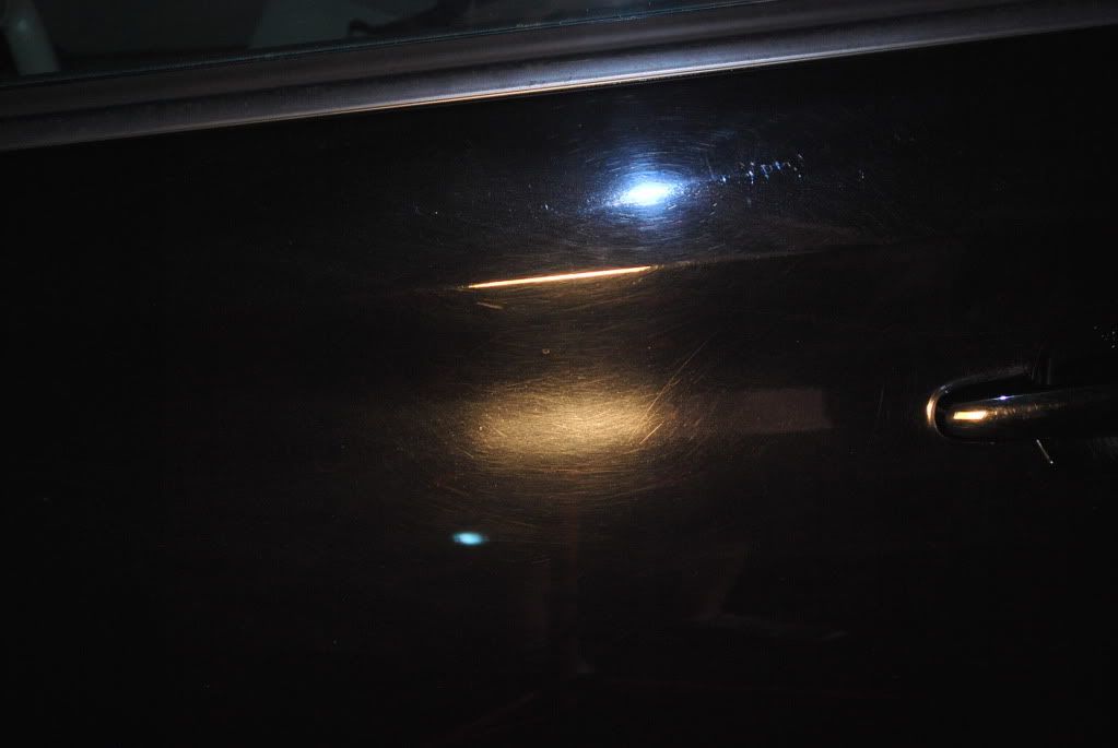

    The car had some serious scratches as you can see.

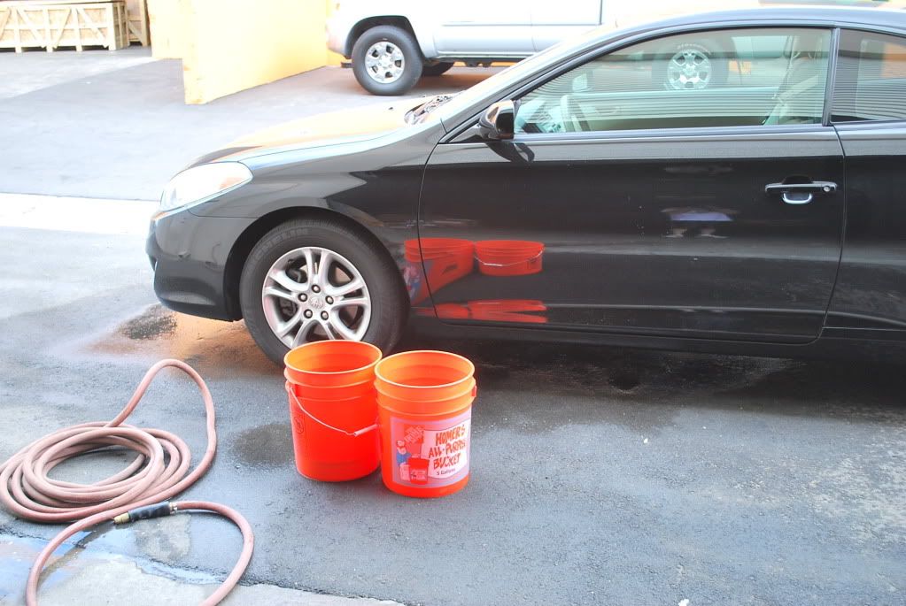

    I used the 2 bucket system for the start of the job.

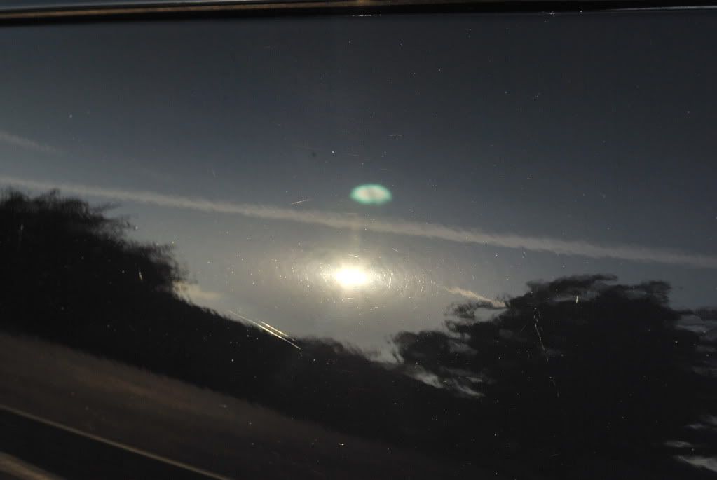

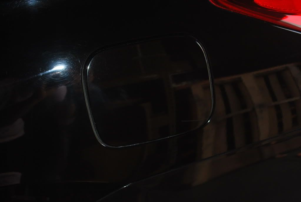

    The car looked good after the wash, but up close you could really see the problems:
    The rear of the car made me think that this car had been repainted on possibly the front and rear bumpers. It looked like a really bad paint job up close.

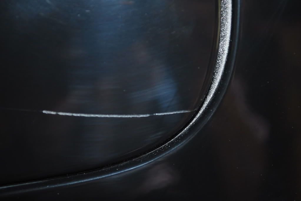

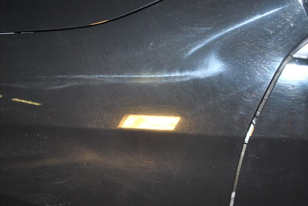

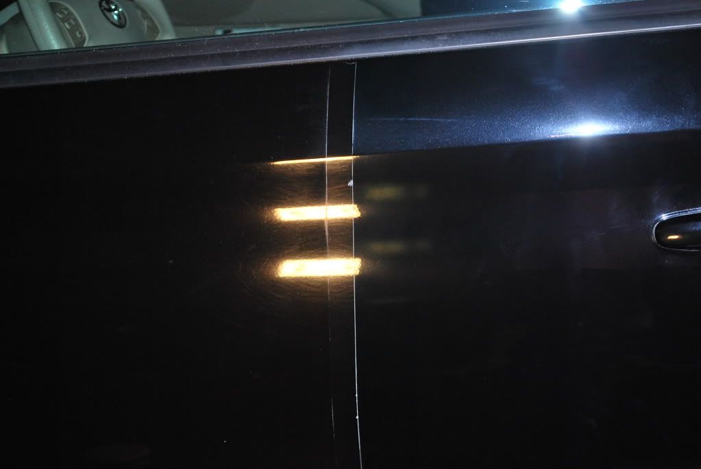

    A nice scratch here:

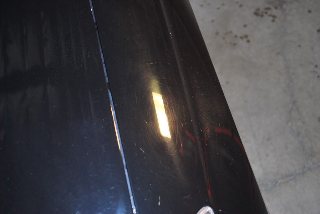

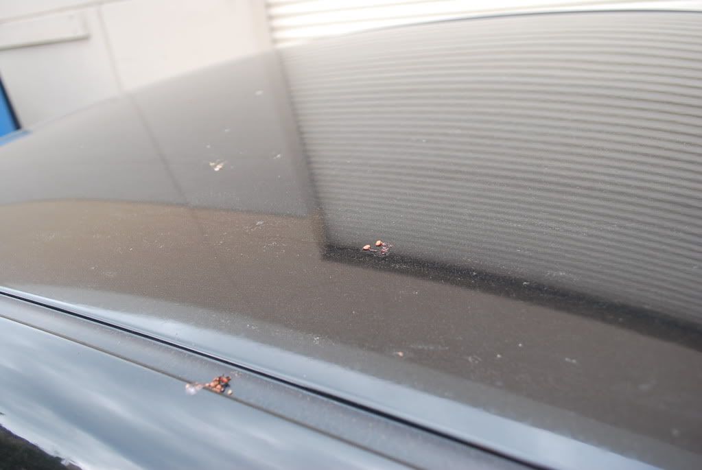

    Car was in bad shape:
    I did a test spot with the ZPC. It did an okay job.
    The scratch after some Meguiars ScratchX:
    The paint was removed so this was as good as it was going to get without applying new some paint.

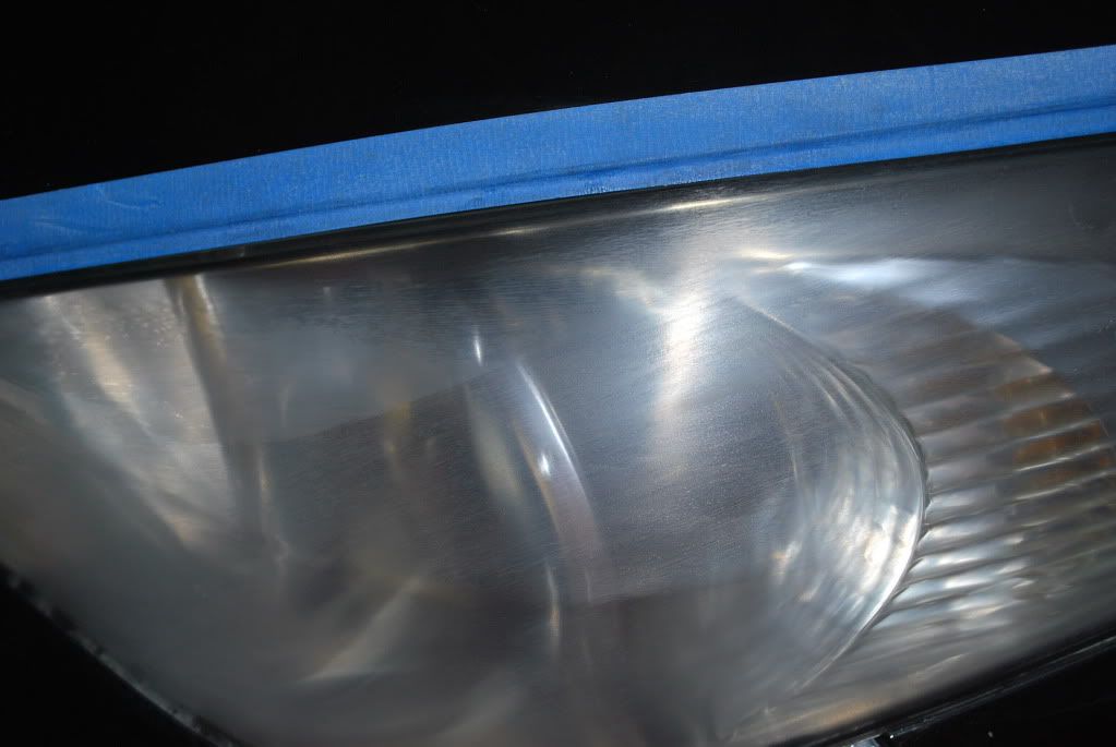

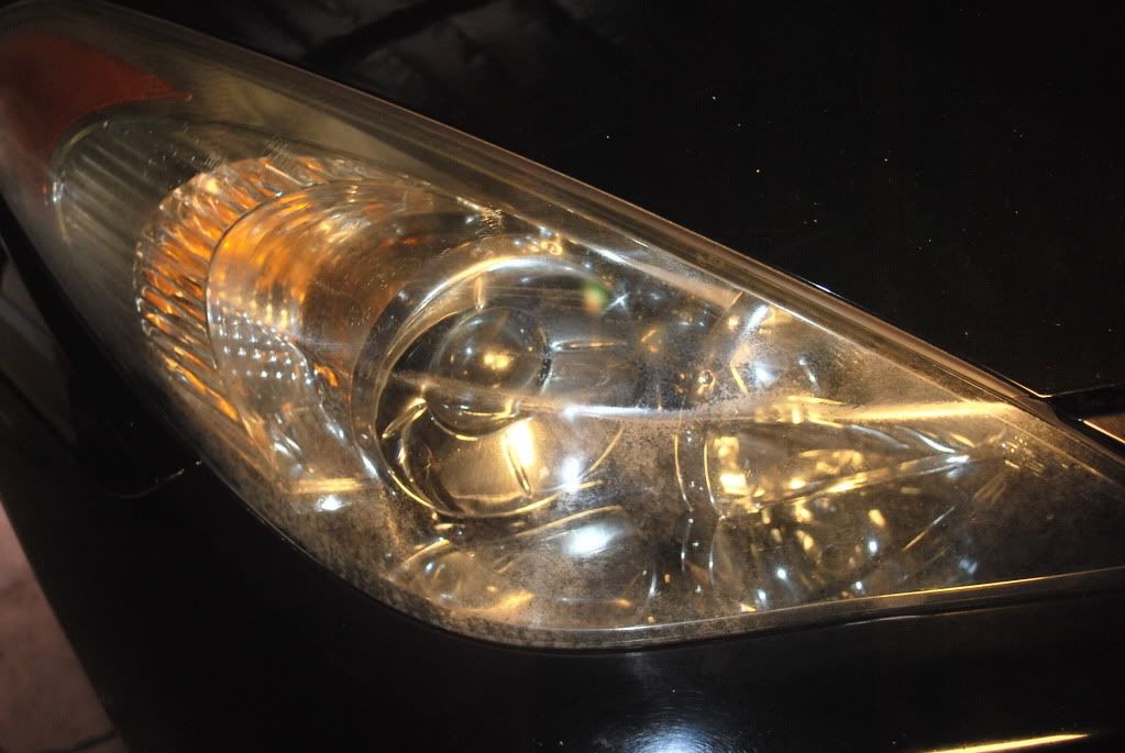

    I also decided to clean up his headlights since they were really bad. Here is after the sanding and some polish.

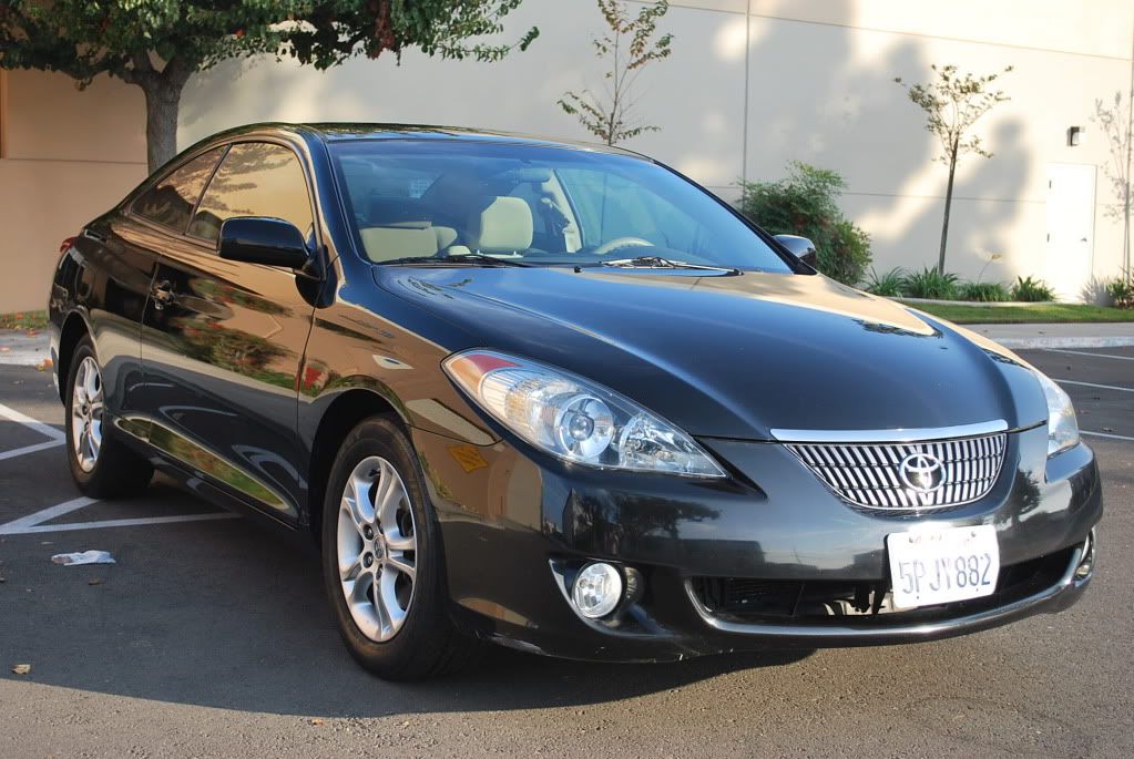

    On to the after pictures: I was a little disappointed because I knew the car needed a better polish in the pre-work, however, he was happy with the correction and it's ready to put a For Sale sign on it.
    Note the level of correction:

    Not every job we take on will be a full correction. I think for what the customer wanted, you hit it out of the park. Very nice job.

      I agree, looks like a decent job for what was wanted.

            I think you probably exceeded the owners expectations. The car looks like it will sell quickly. Good job.

                  Great work on it for sure! I do have to say that to anyone outside of the detailing world, the paint probably looks like the day it did leaving the lot.
