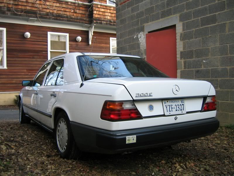

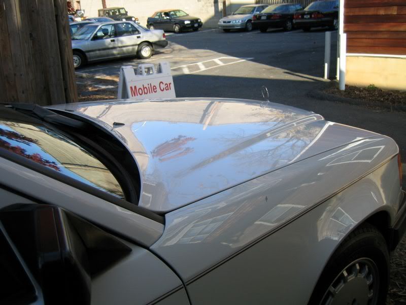

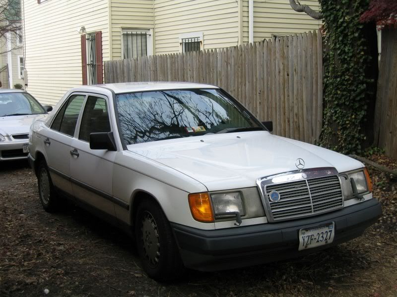

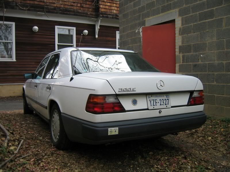

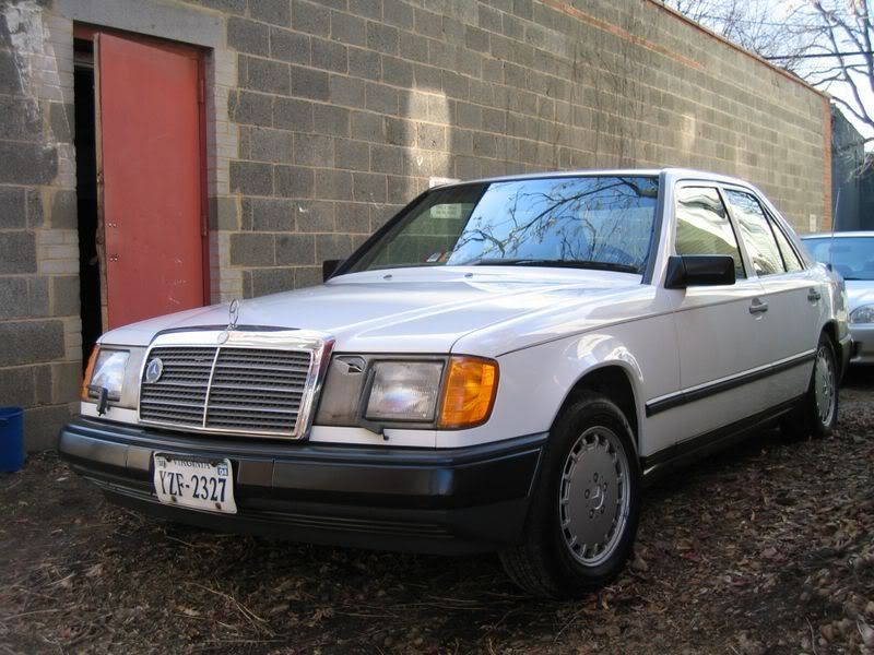

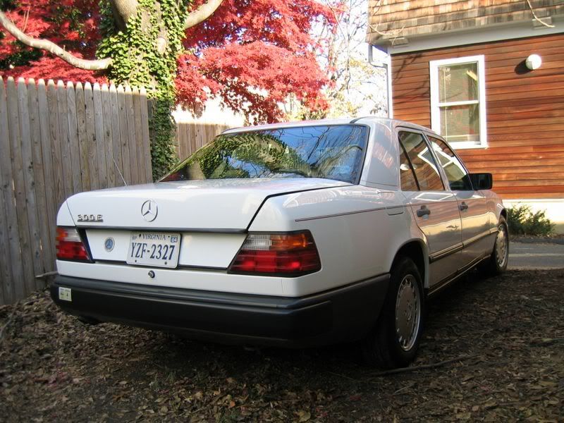

    This was a free detail for my Accountant who has been very good to me and looks out for me. The paint was in terrible shape and looked more gray in some places than white. Unfortunately I still haven't figured out my camera to show dirt on white although the firs picture shows it somewhat in the front fender and rear door.
    The inside was a mess and all I did was vacuum and wipe the dash and clean the windows. It would need half a day to get it look presentable, but looks much better now.
    QEW
    #83 pc white LC pad speed 6
    #80 pc white LC pad speed 6
    NXT pc white LC pad speed 5
    Hot Shine on tires and black molgings
    I had 4 polishing pads with me and had to wash them twice and 1 of them 3 times while using #83!
    before
    after
    before
    after
    before
    after
    More after pictures
