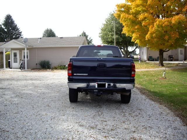

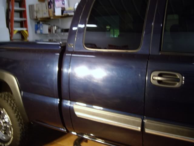

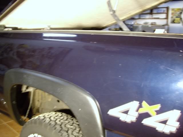

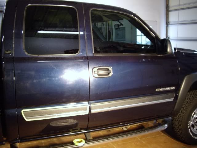

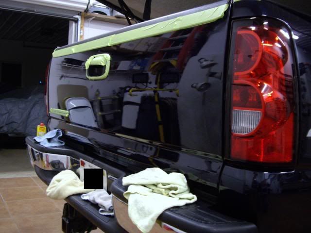

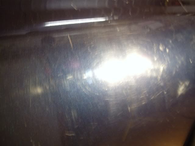

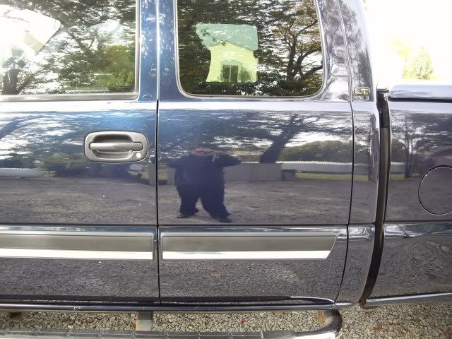

    '06 silverado that was need of some serious attention. There was white overspray all over the truck and swirled very badly. It took roughly 12 hours to complete.
    Process:
    105 on rotary with heavy cut wool pad.
    205 on rotary with polishing pad
    2 coats of nxt
    All season dressing on wheels
    Hyper dressing mixed 3:1 on al plastics and under wheel wells.

    Wow, Tracy, that truck was hammered before you got a hold of it! Nice turnaround!!

        Now that is how a truck is supposed to look. Great work. The truck looks fantastic.

                  I took interest in this post because I drive a 2006 silverado. Very nice work! Was it pretty difficult to get out all of the swirls/scratches?
                    Re: 2006 Silverado full correction
                    It wasnt real difficult to get them out. It took a little bit of time though. I started with 105 on a light cut wool pad and it wasn't quite cutting enough so I moved to the maroon wool pad and things went much smoother.
