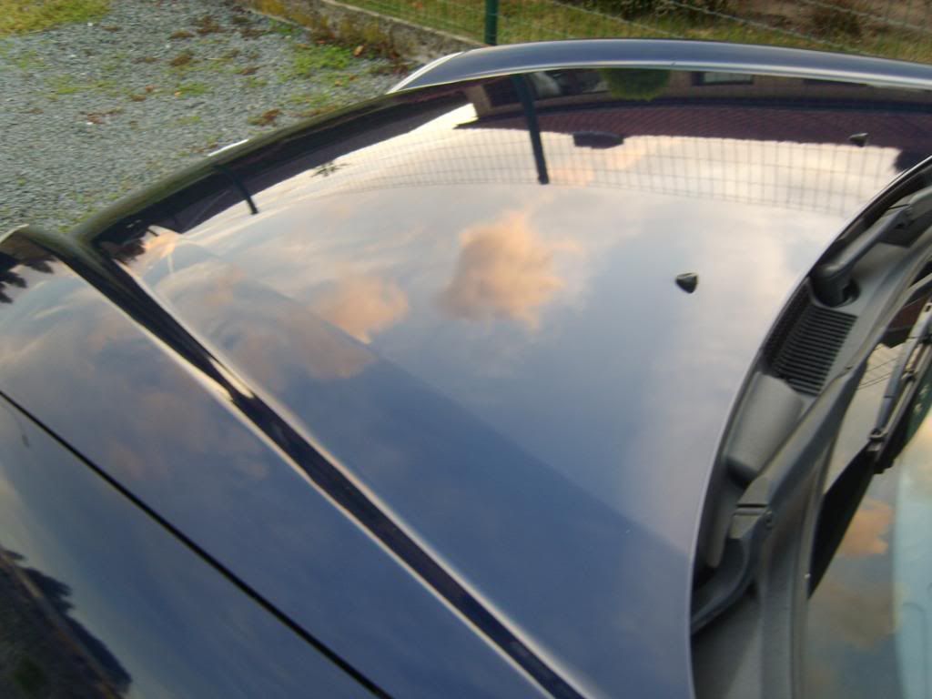

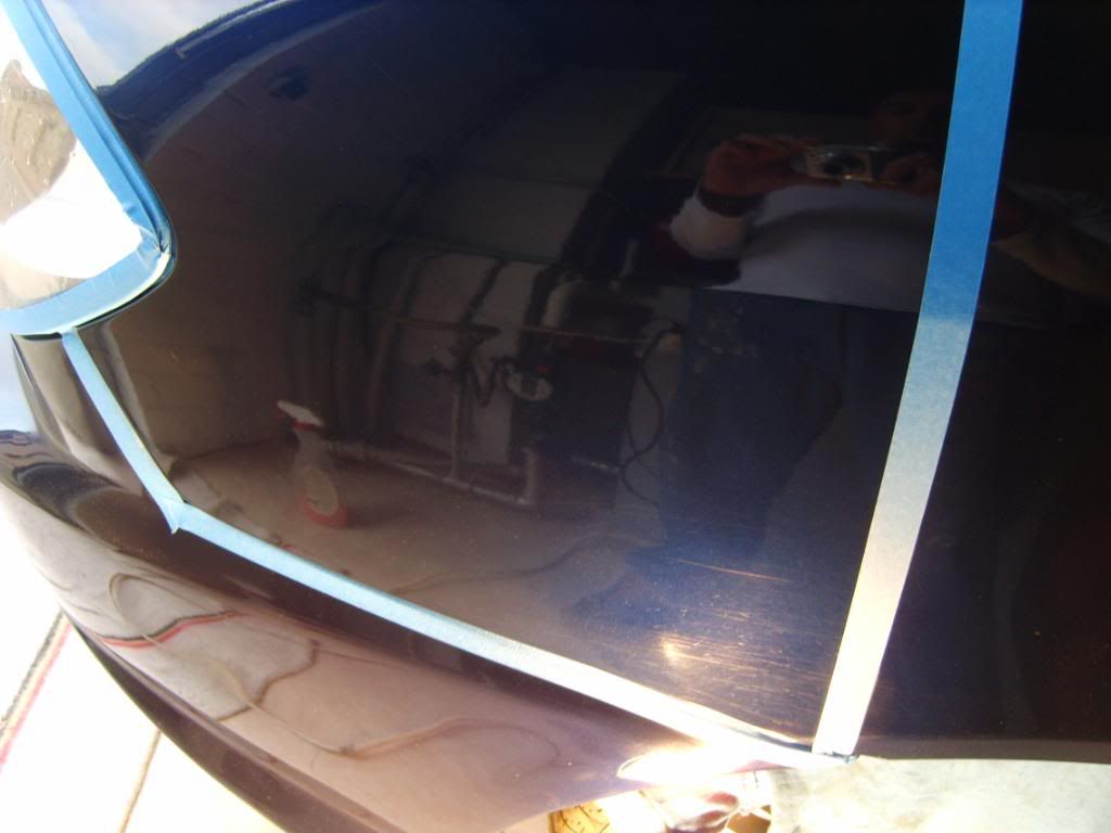

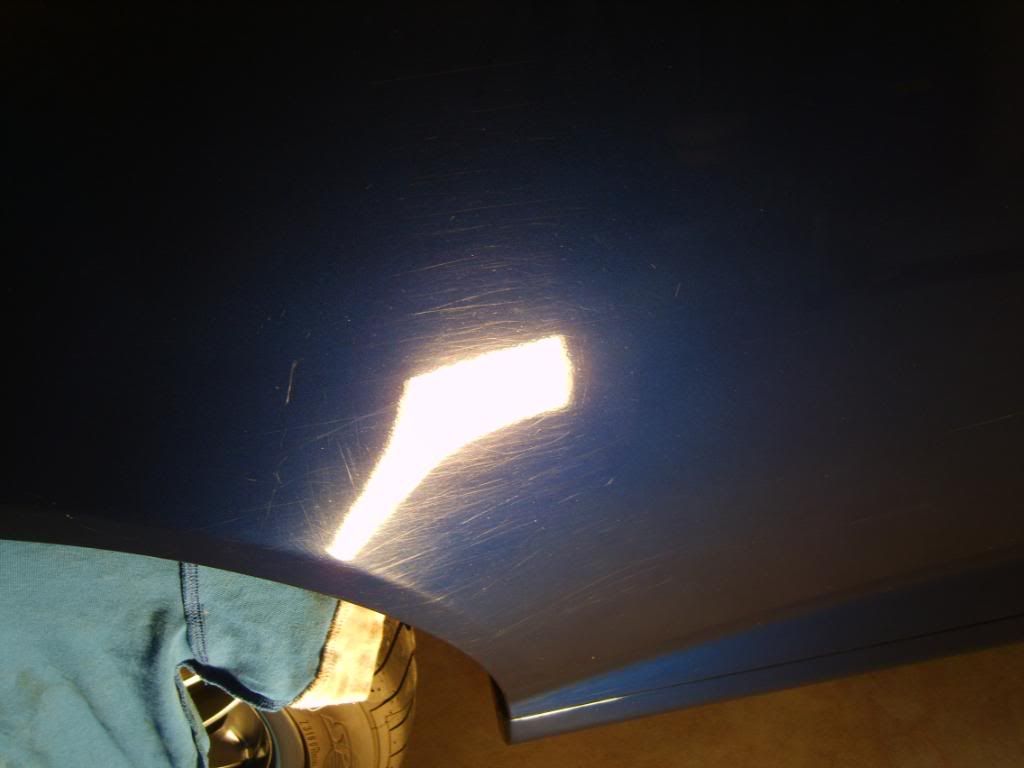

    BEFORE pictures.

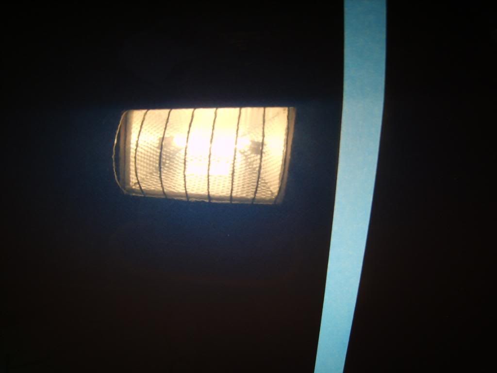

    Bizarre scratches !

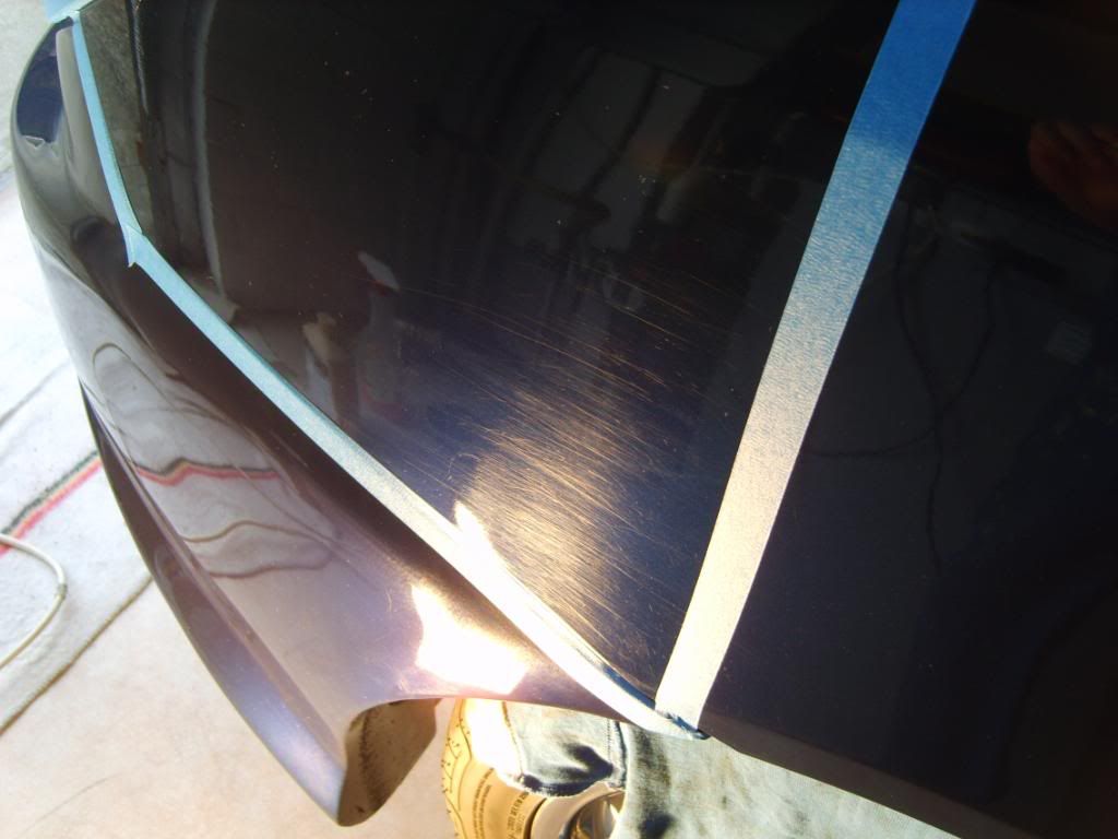

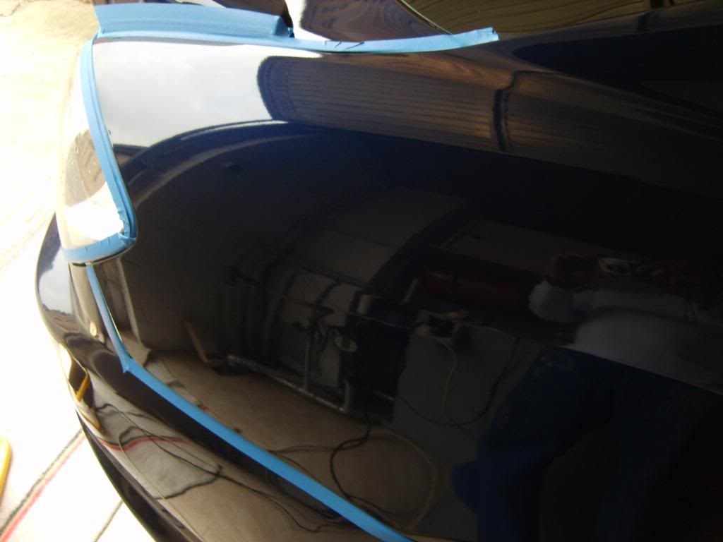

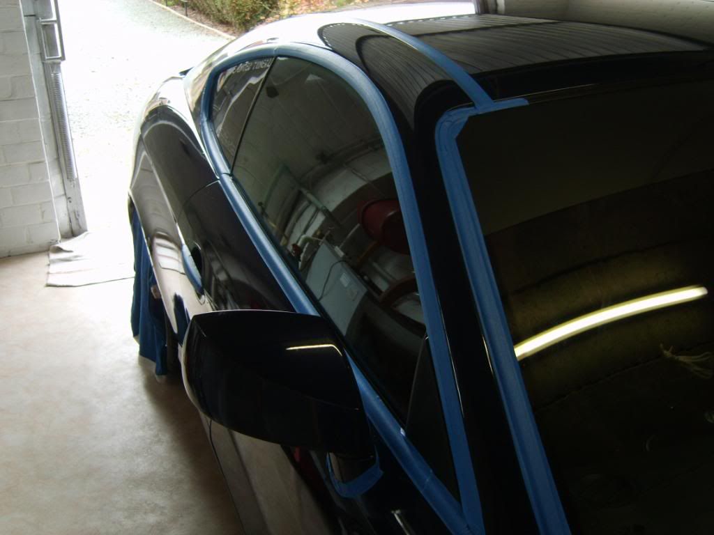

    Taped .

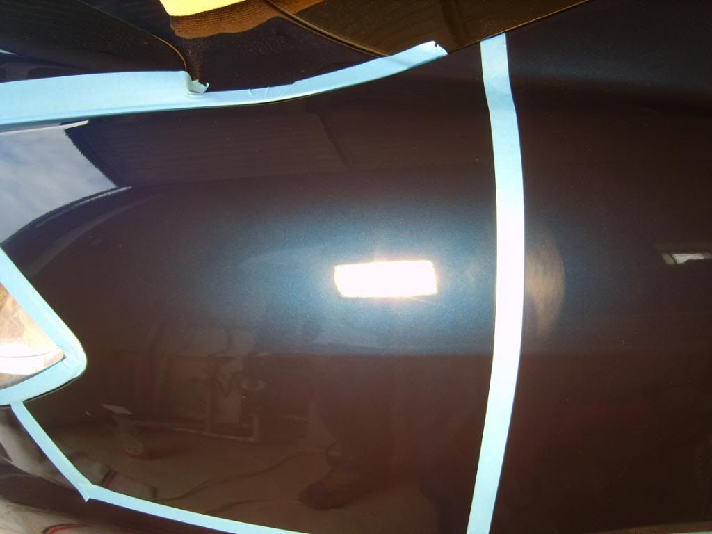

    Testspot after 1 pass with m83.
    Second pass.

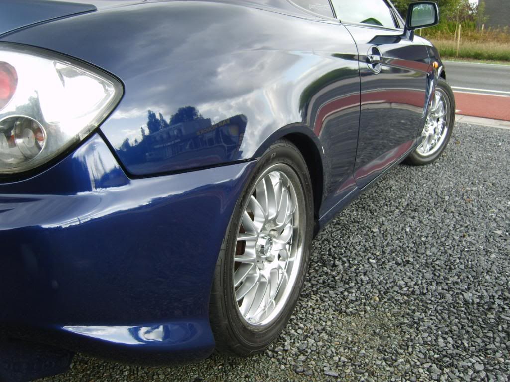

    After m80 1 pass.

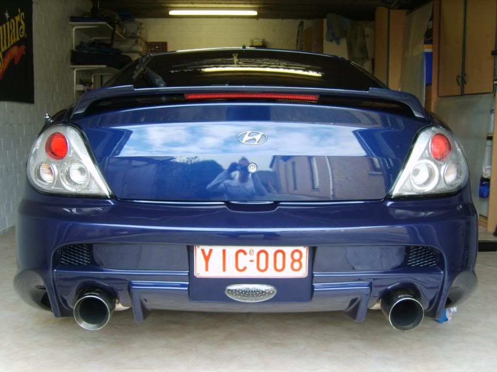

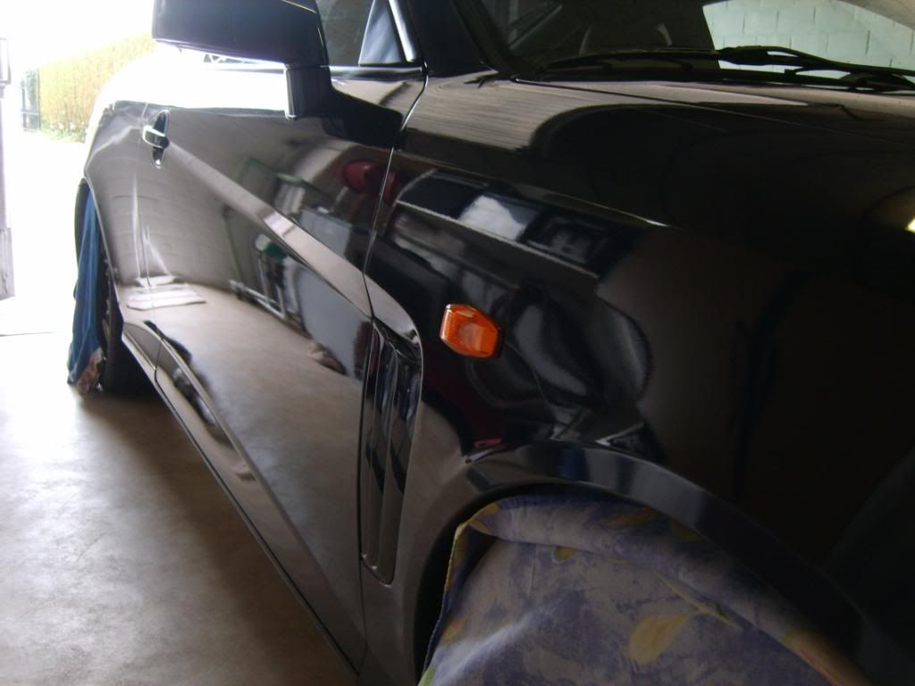

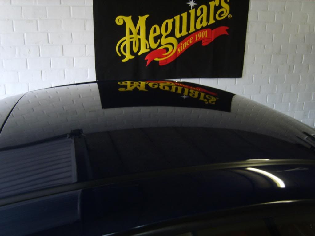

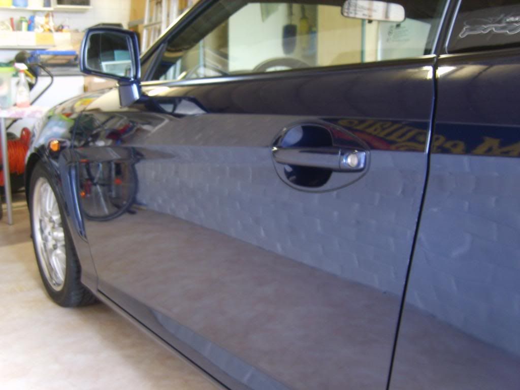

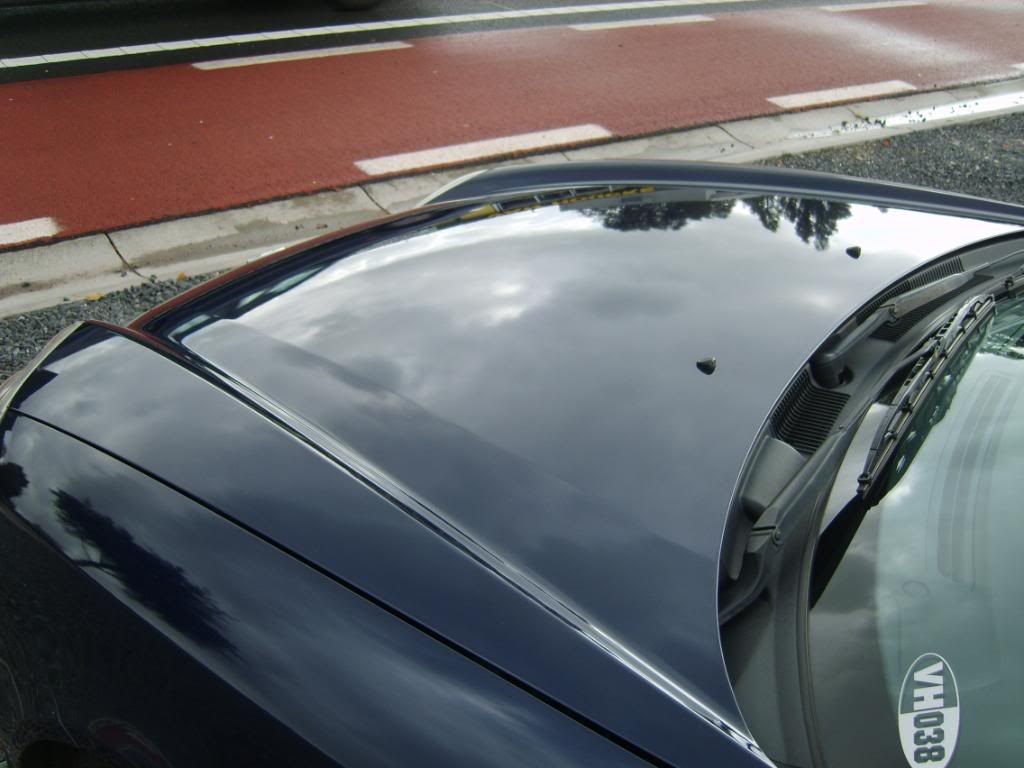

    AFTER pictures, taken indoors because it started to rain !

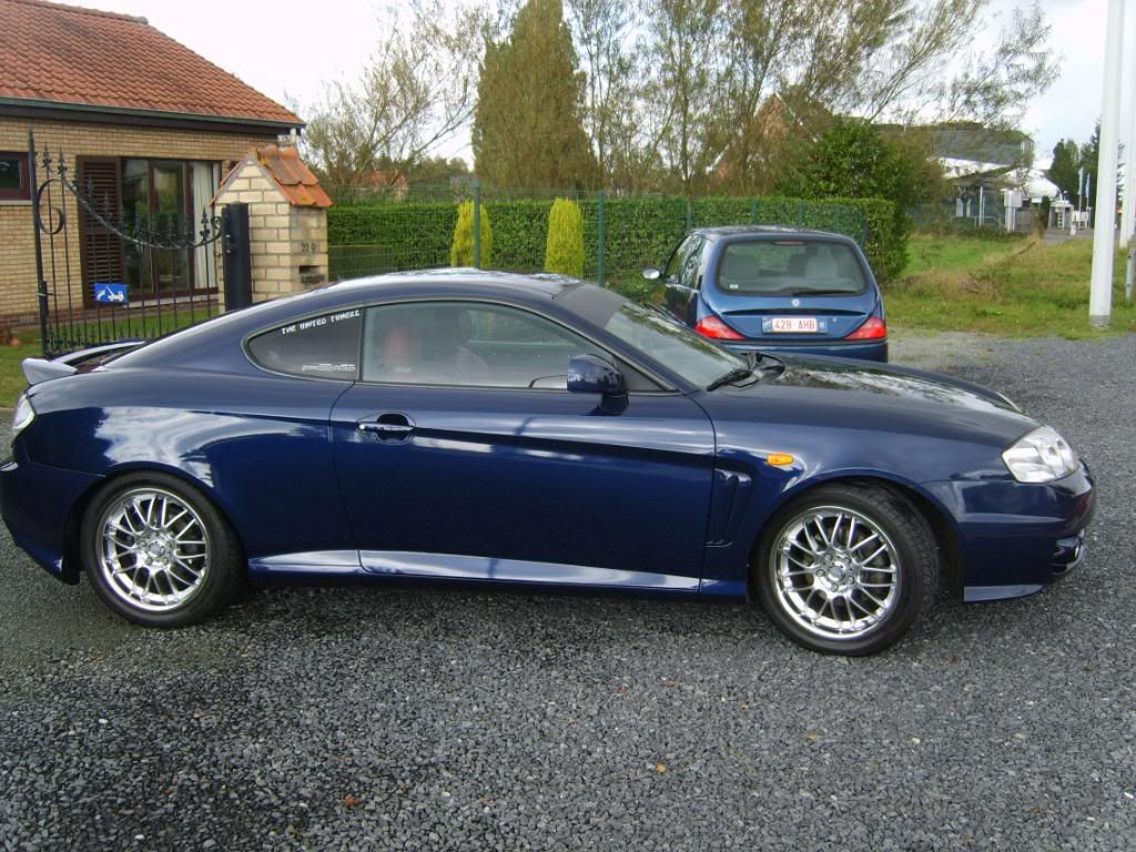

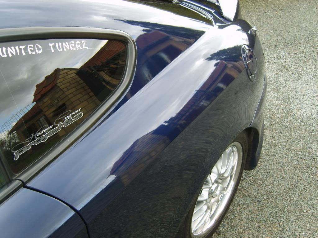

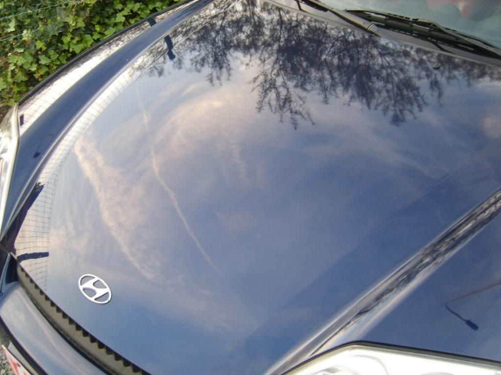

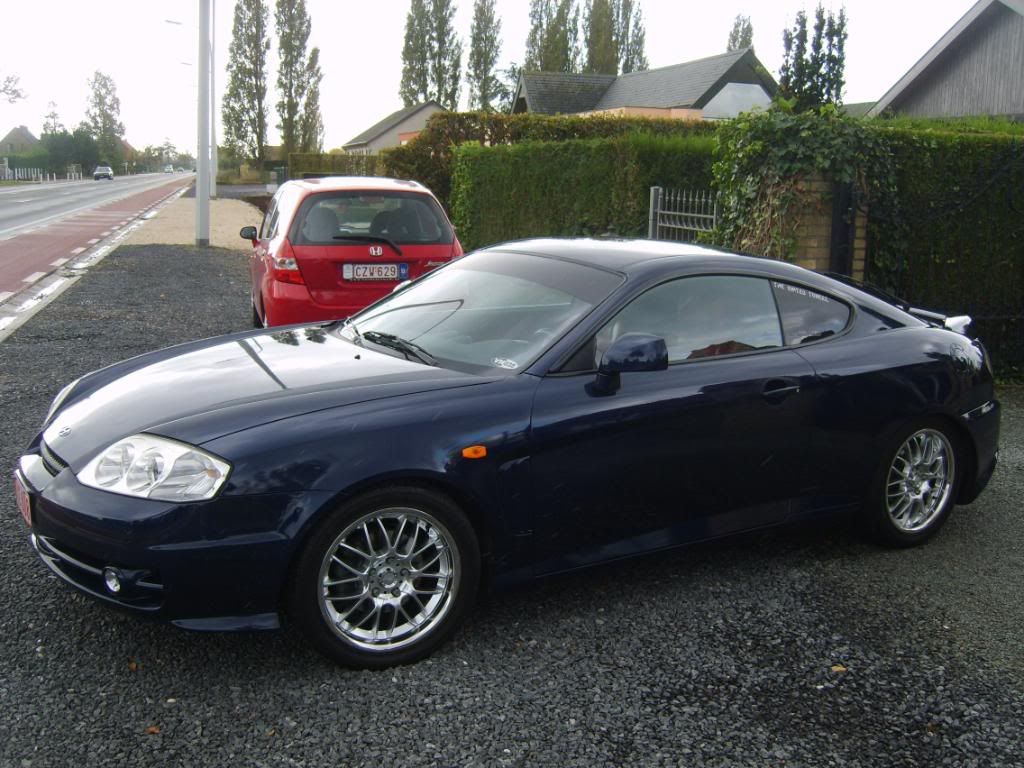

    The day after i took some outdoor pictures ( no sun ,cloudy weather )
