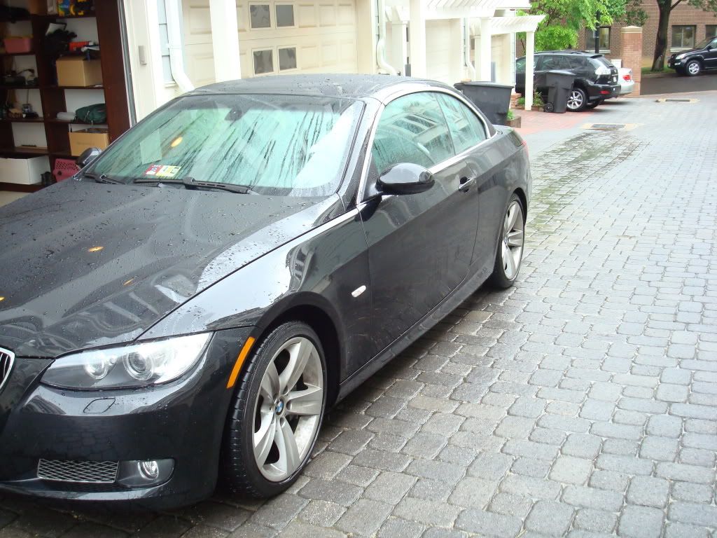

                            Yeah, they sure are envious at my cars! Having the luxury of free time to detail cars is what makes people envy he he he
                            Anyway... got the wheel back, with new tires installed. Took some pictures.
                            Here are the processes:
                            - Clayed, wash, blah blah blah...
                            - M105 SOLO Maroon Wool Pad @ 2000rpm (around 4 passes were needed in order to remove the SEVERE swirls)
                            - Feathersanded RIDS and finished with M105 and SOLO Wool Pad
                            - Ultimate Compound and a cutting pad with DA at speed 6
                            - M205 with a polishing pad with DA at speed 6
                            - M205 with a finishing pad with DA at speed 6
                            - NXT 2.0 with finishing pad with DA at speed 6
                            - NXT 2.0 with finessing pad with DA at speed 3
                            - ****** Pure Wax applied by hand
                            Unaltered, straight from the camera...
                            Unfortunately, the gloss and shine is limited by the orange peel. Also, the metallic is hindering the depth of the color.
                            In all honesty, my daily driver, a solid black Nissan Maxima, has a MUCH more dramatic gloss and depth than this car.
