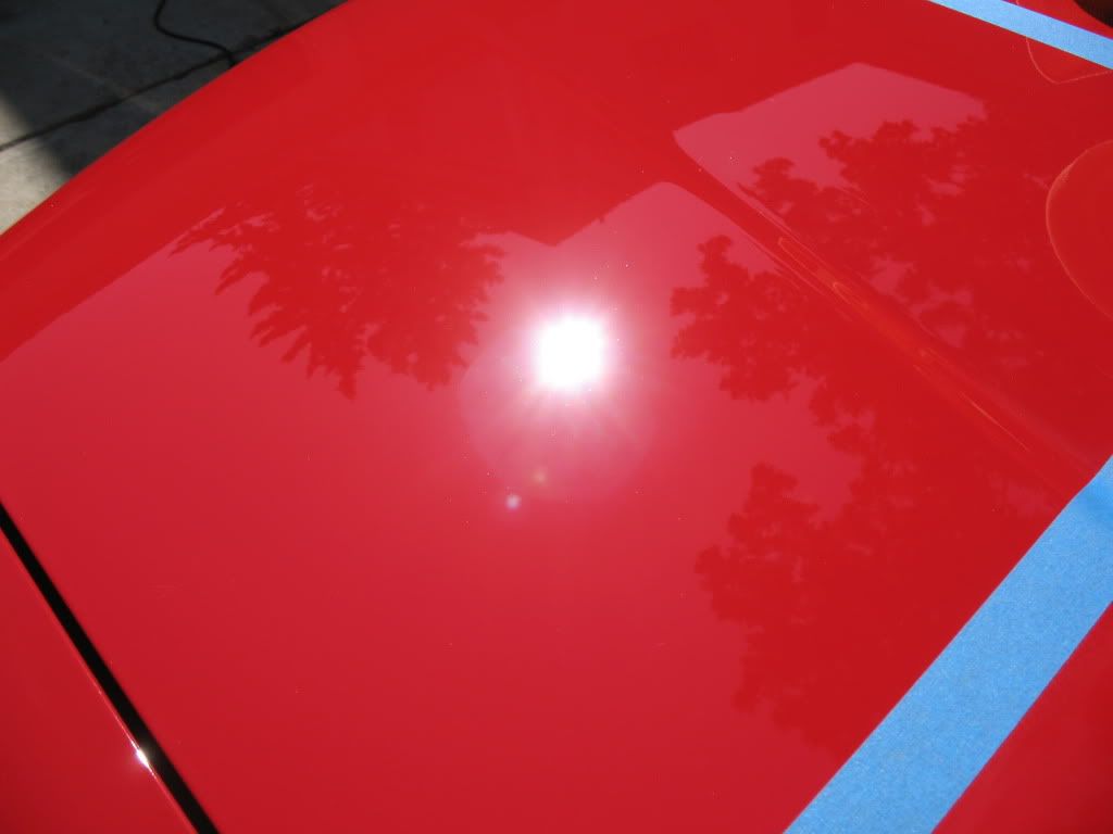

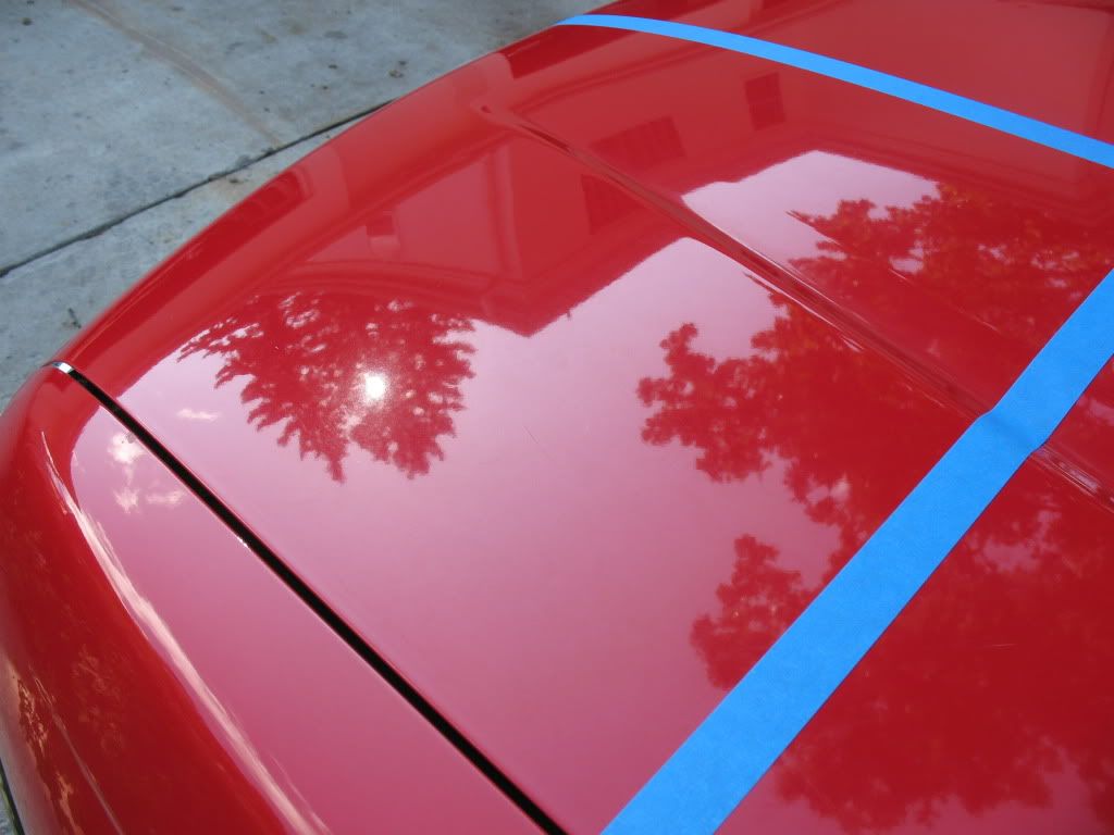

    OK guys...this was my first time EVER using a G110 or any of the products i had gotten in my ADS order. Heres my process and then pics

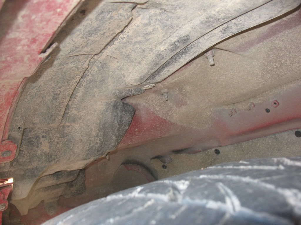

    • Wash Megs GC with grit guards
    • Wheels Brightener 10:1 on wheels, Westleys Blech-Wite on tires, APC+ around 6:1 or 7:1 (between 4:1 and 10:1) in wheel wells
    • Clay with SS clay and LT 1:1 for lube
    • Taped off exterior of truck
    • Ultimate Compound on speed 6 with Megs 2.0 polishing pad, 6-8 passes on all panels
    • M205 on Speed 6 with Megs 2.0 finishing pad 4-6 passes on all panels
    • M21 on speed 3 with Megs 2.0 Finishing Pad
    • M40 on all exterior plastics, vinyls and rubbers
    • Megs Hot Rims polish on bumpers and grille
    • Megs Hot Shine aresol spray on tires
    • UC, M205 and M21 by hand with foam pad on lower front valance, strip between bumper and grille and around rear window
    Im hoping im not missing anything.......heres the pics

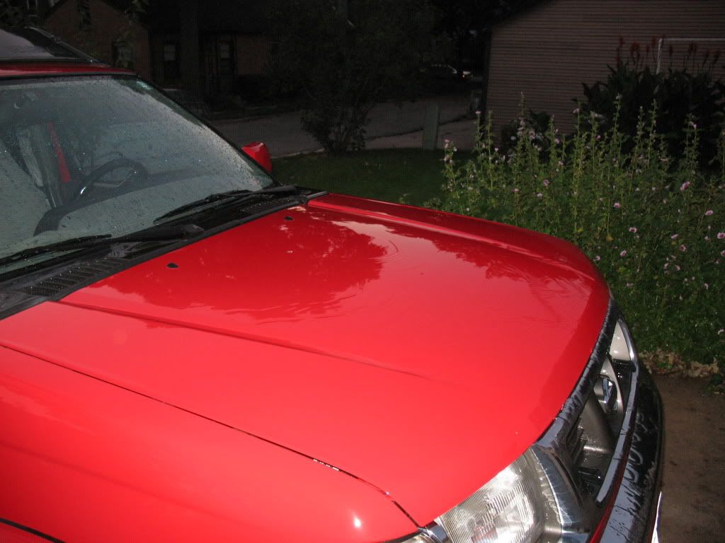

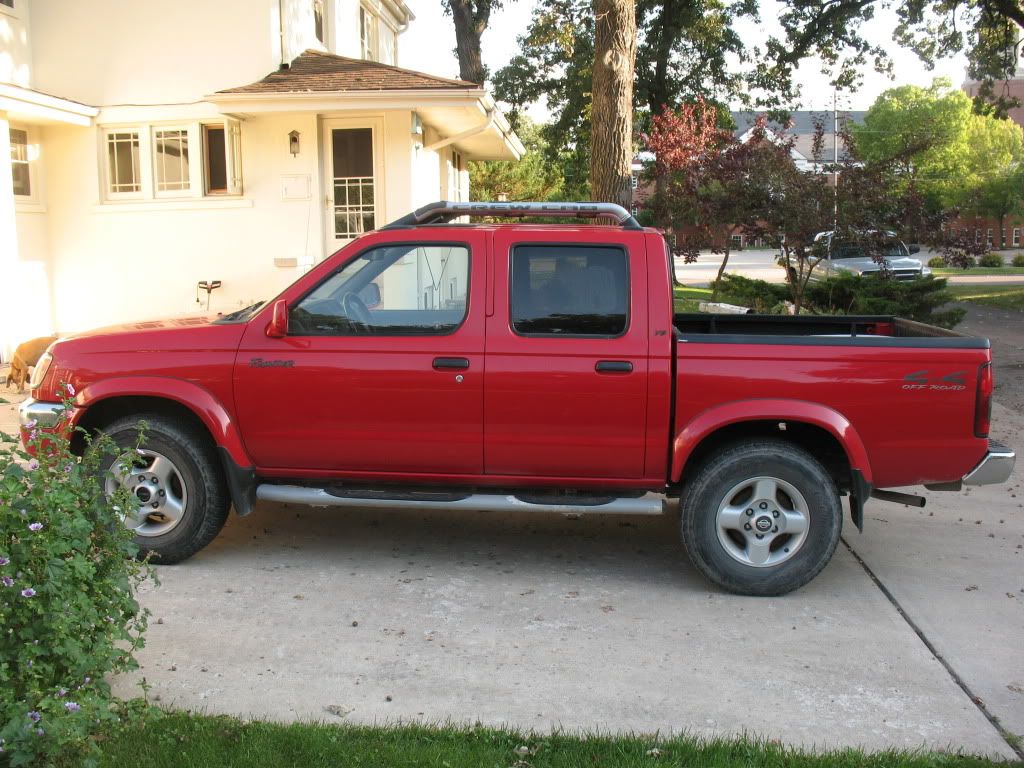

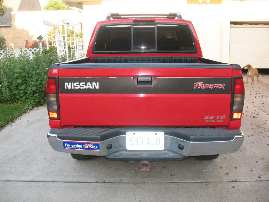

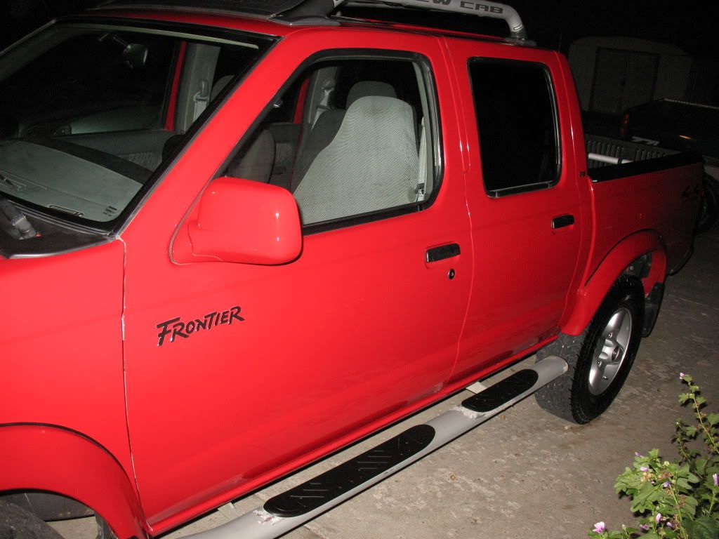

    Pre Wash Pics
    During Wash - Notice NO protection on paint....at ALL

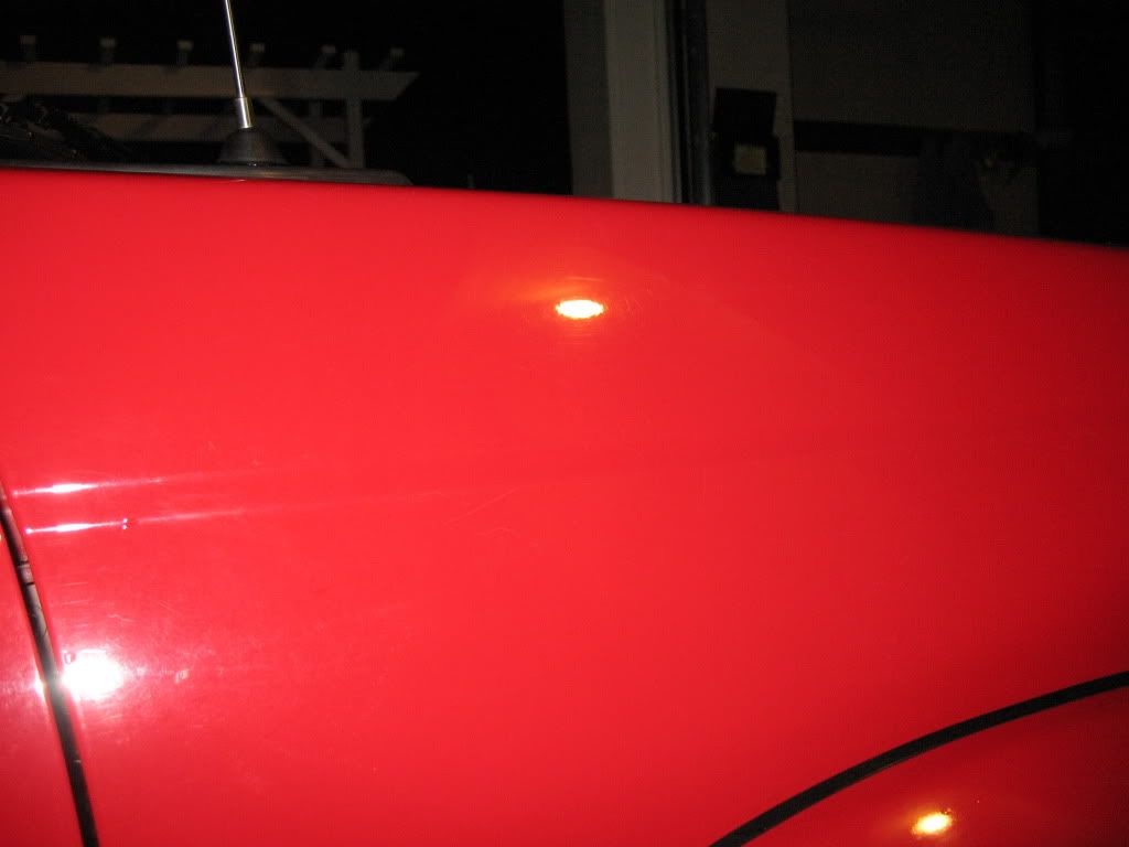

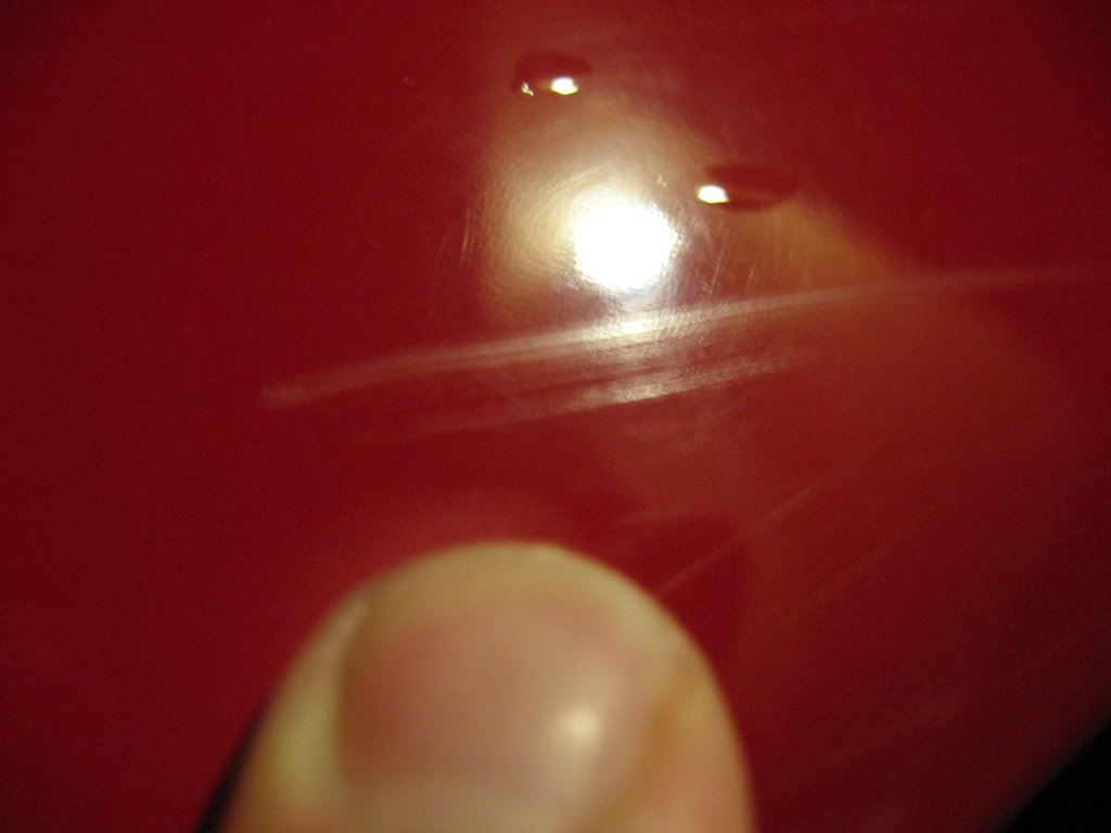

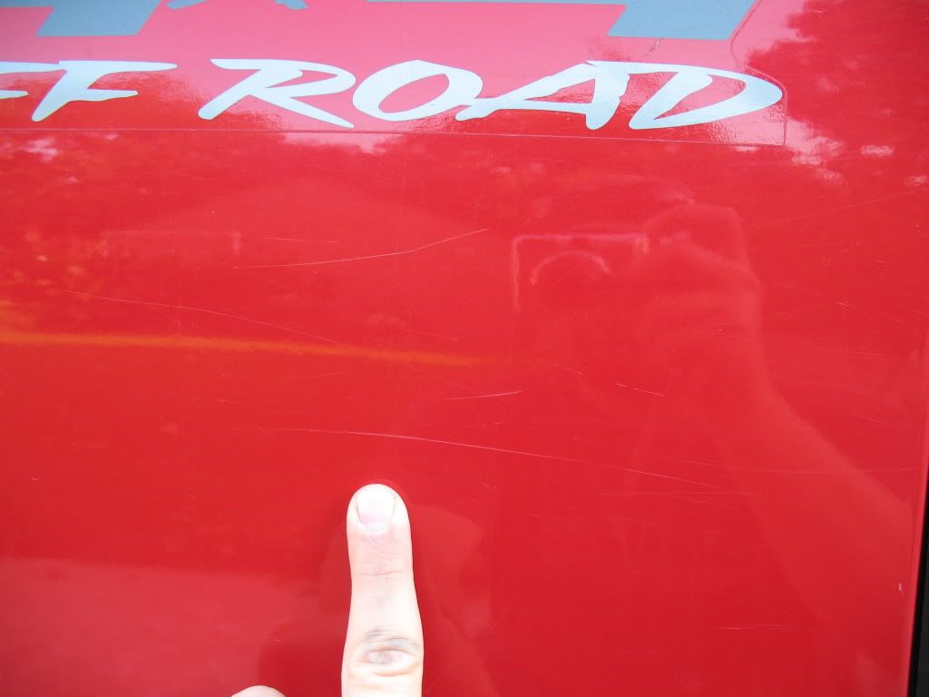

    Attempting to get some paint condition pics, post wash

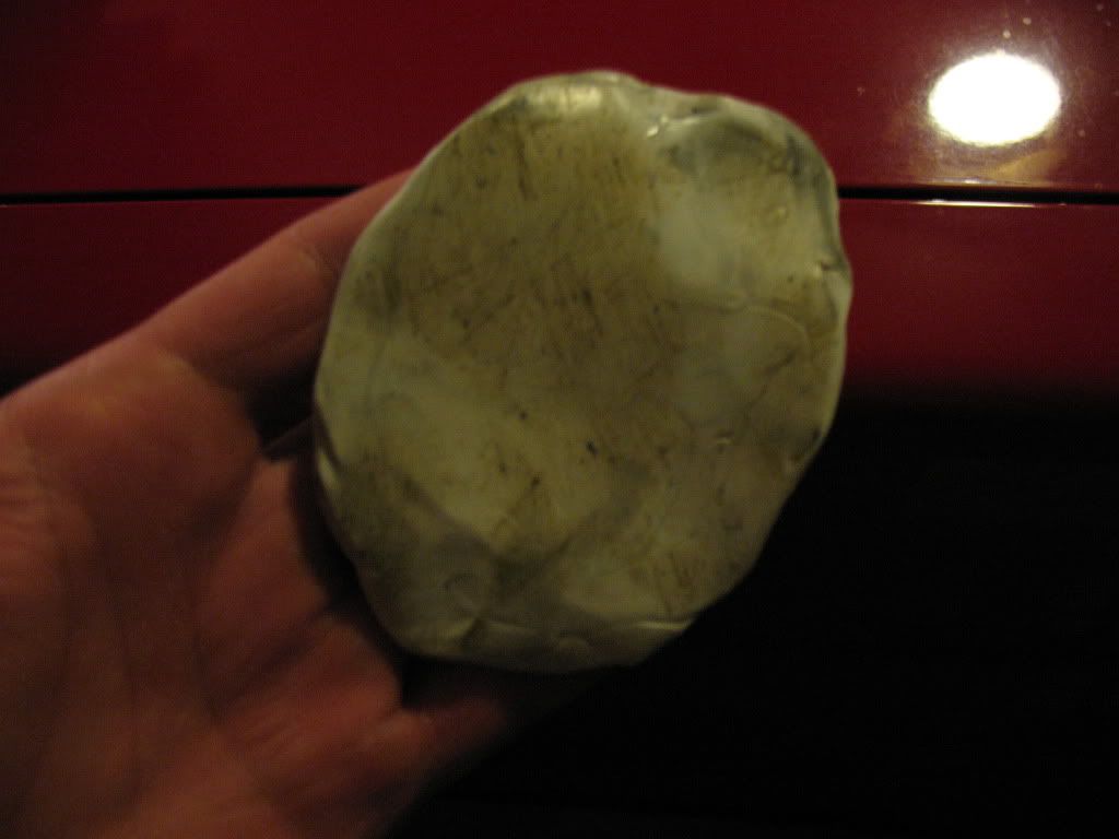

    Clay Pics - First pic is after 1/2 of hood, second pic is after whole truck

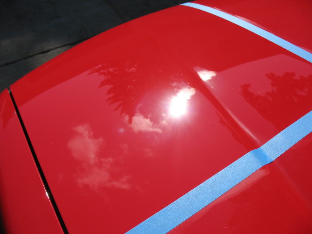

    Test Spot - 8 passes of UC, 4 passes of M205, spots in paint are baked on tree sap i could NOT get off

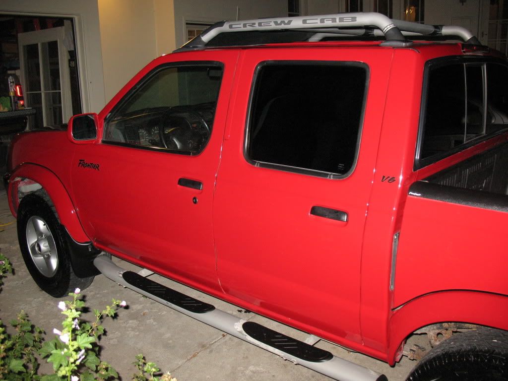

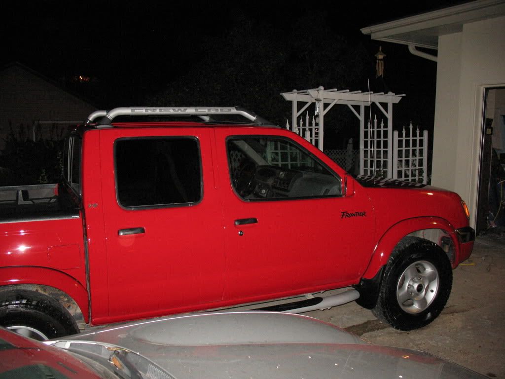

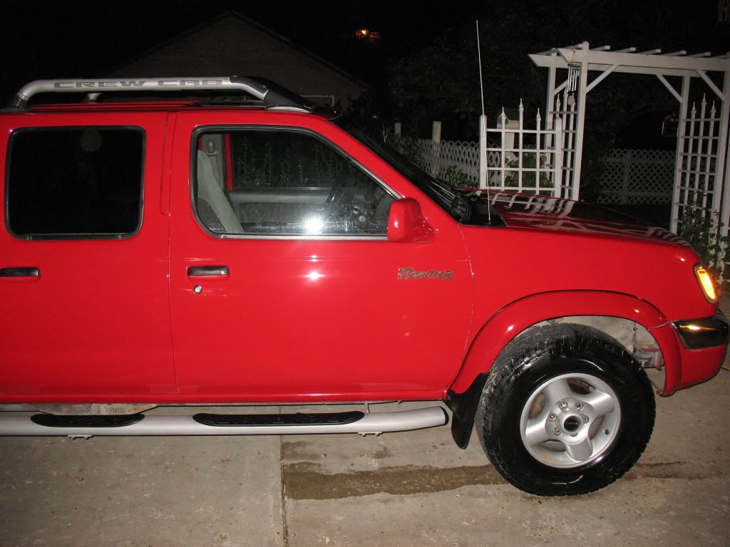

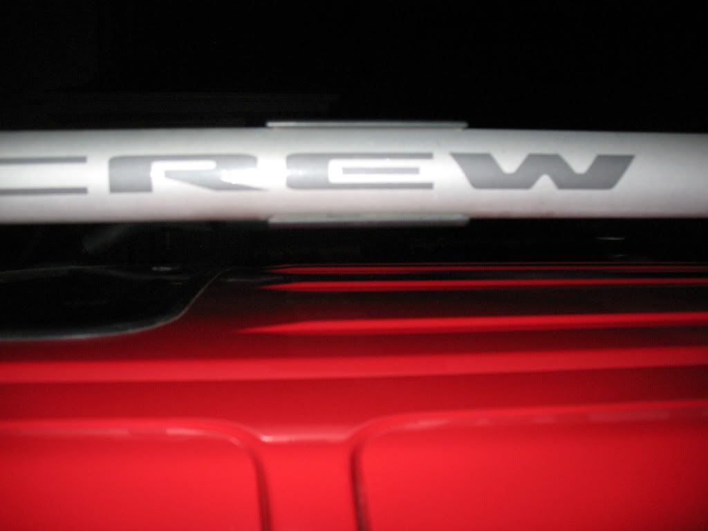

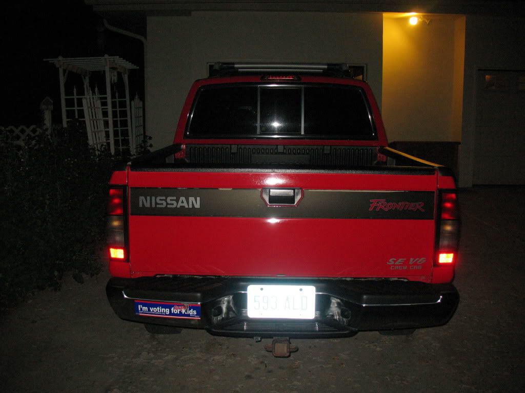

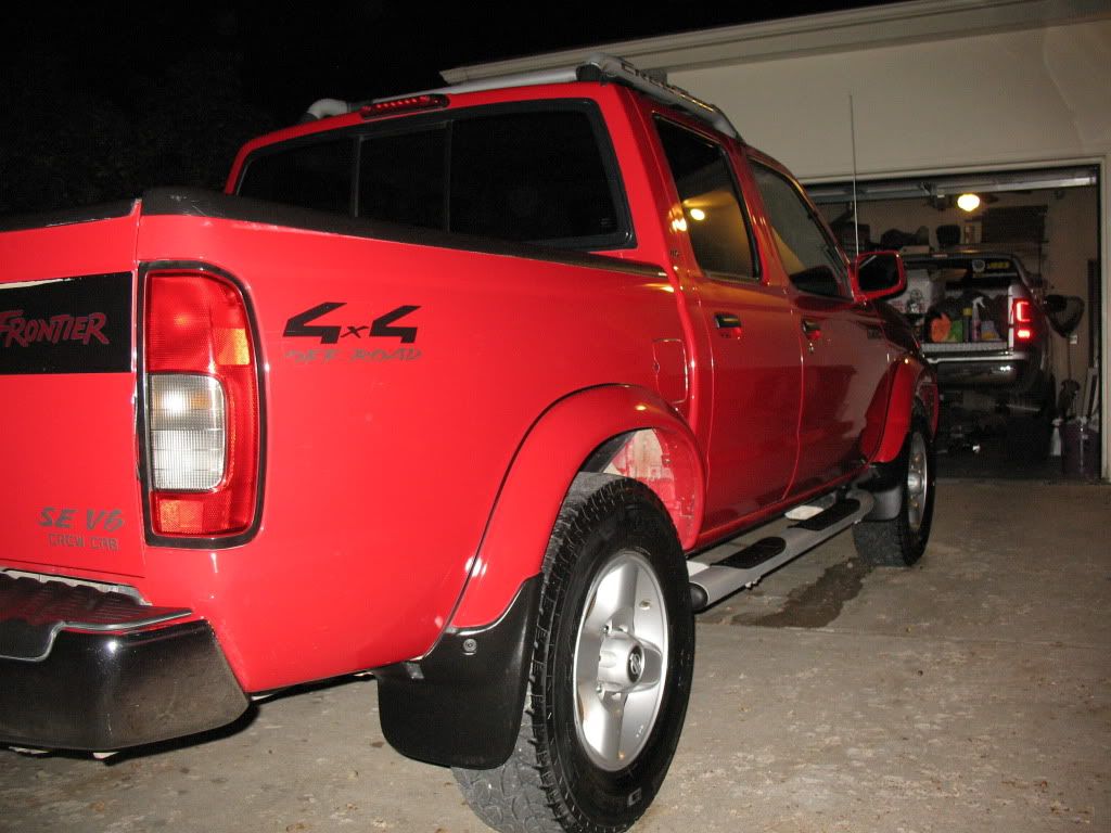

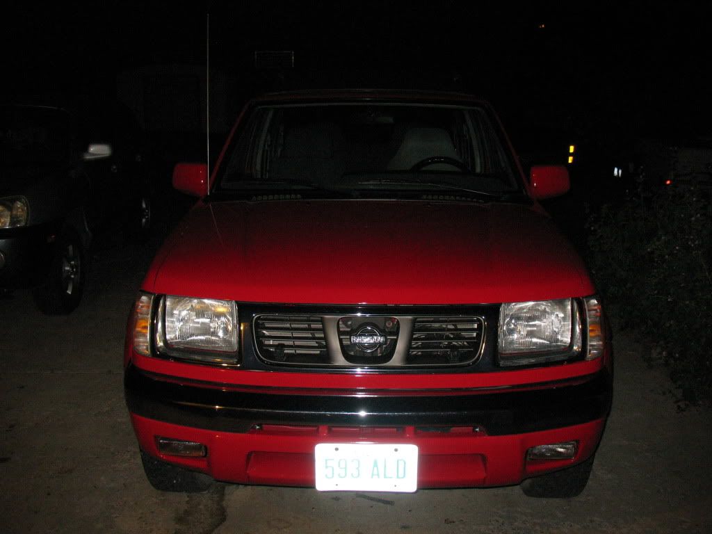

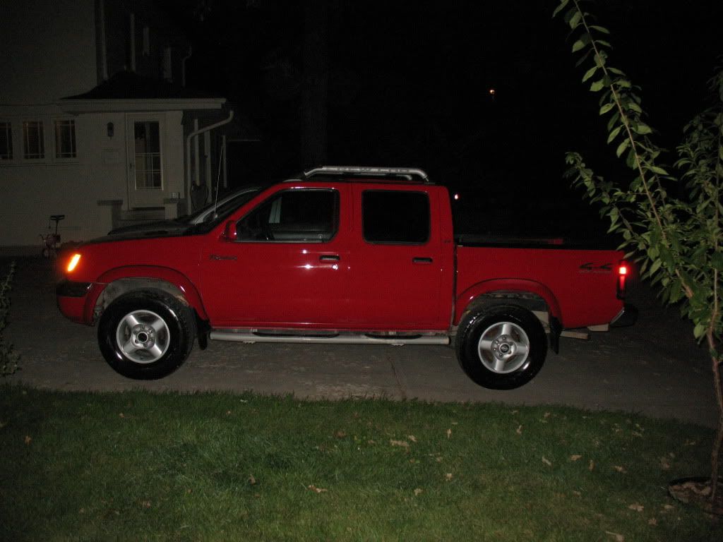

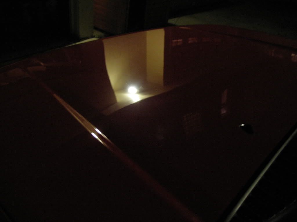

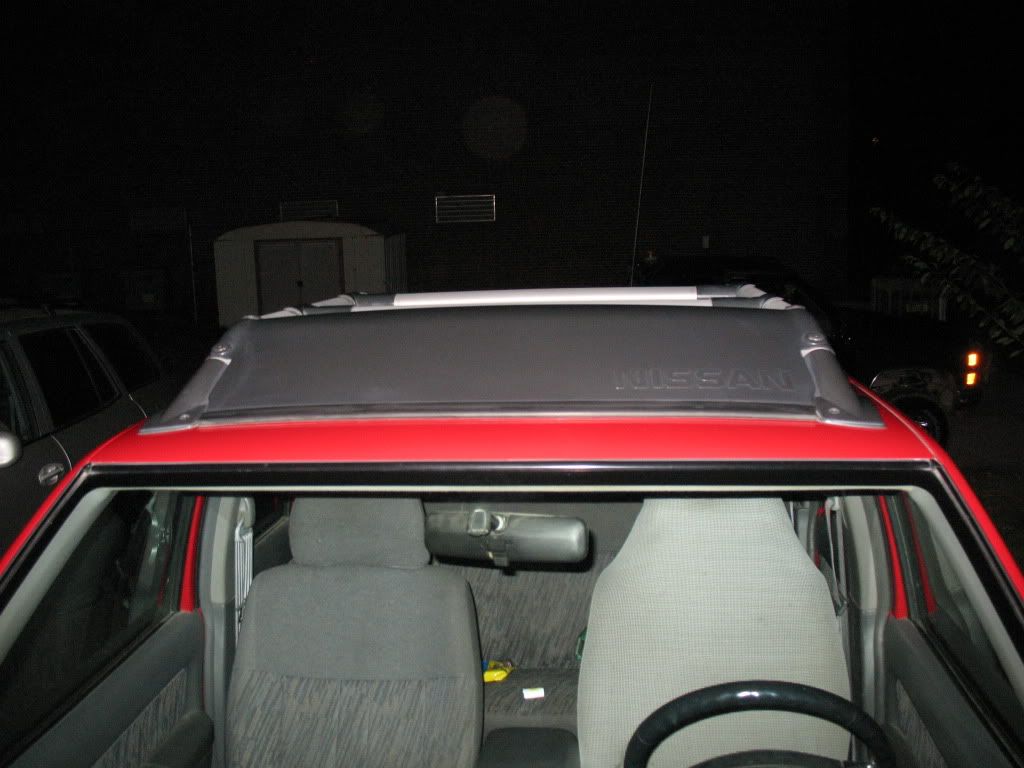

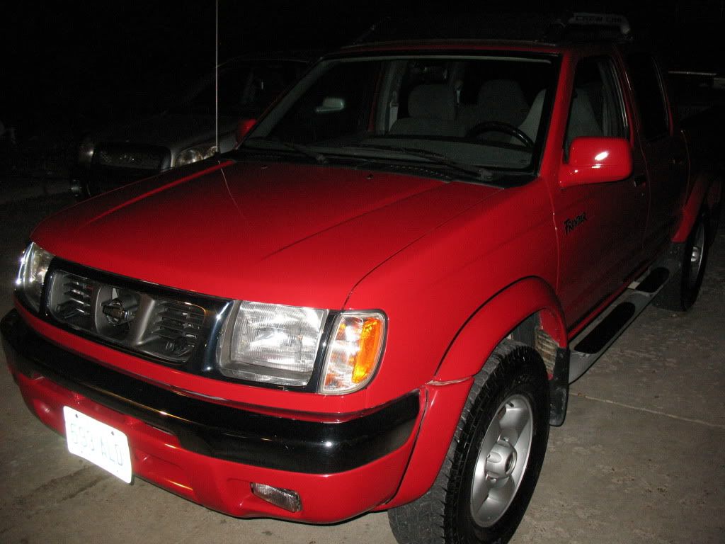

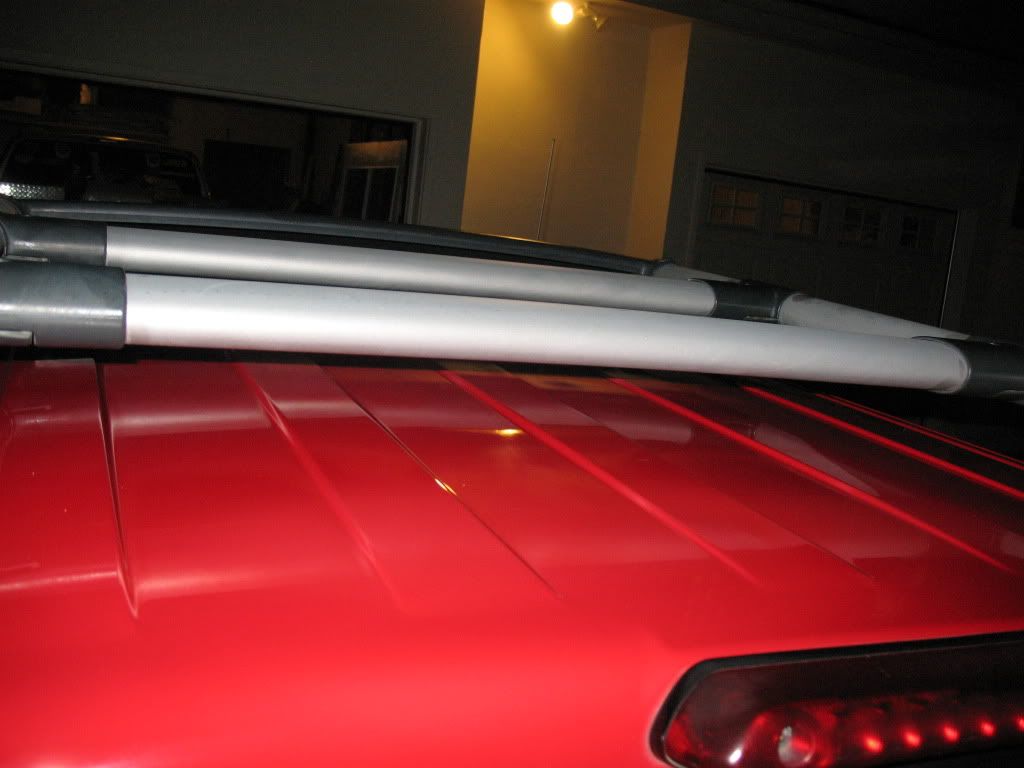

    Finished Pics - Finished after dark so please bear with me and pics until tomorrow!
    Let me know how it came out guys!!!!!

    Re: Dads 2000 Nissan Frontier Crew Cab
    Hey Zach,
    It came out great, Of course it will look even better tomorrow morning since the LSP has some time to setup overnight, you could even put another coat of M21 on tomorrow morning if you like.
    I also liked the sun shots displaying the correction work
    Be sure to post up some more sun shots tomorrow
      I'd be sure to check your crevices and such, because it looks like there's some polishing residue or wax in there. I can't quite tell from the night pics. Other than that, it looks great! Nice job!

          If I may make a suggestion, I think UC and a polishing pad is too gentle for this particular paint job. Trust me, I have three Nissans and I know how tough their OEM paint is. You may want to consider getting some Lake Country cutting pads and M105 to combat defects. Just a friendly suggestion. Hope you didn't take that as some sort of hostility.
          If tree sap is causing you problem, you can try using Meguiar's concentrated glass cleaner at full strength, and use the bug removal method explained by Mark Kleis to dissolve those tree sap.

              all suggestions are welcome bud, i was wondering if nissan paint was hard as it took quite a bit for me to correct even the amount i did. Theres still probably 25% more correction avaiulable from what i did, as i can still see pieces and parts of swirl marks among other things.
