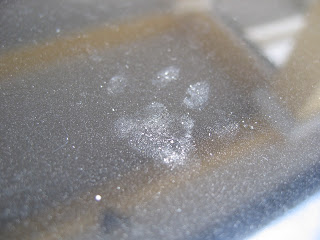

    then i started to clay section by section of every part of car body, Tar soiled mark mostly at the lower panel of the doors, there are many paws, domestic tiger(called CAT), claws was all over the place, birds dropping found on the roof, I presume these little tiger actually went up to
    prowls on them.....
    little tiger paws

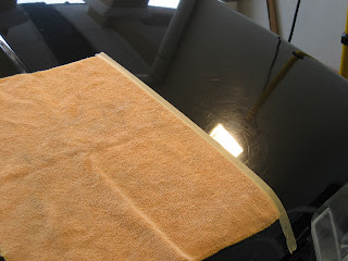

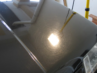

    i begin to tape of the trim. Cant help but notice how plenty is the swirls & all over the cars, the owner only realized when i pointed out to him under a sun light.
    i started to do a test area , with Mequairs M105 ultra compound with lake country yellow pads, minimized almost all spiderwebs.....
    i did the KBM method at 1st, was intro by Master Seech, although is effective, but pads need to be cleaned regularly,

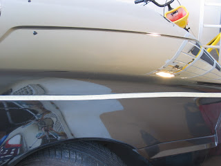

    later I switched to a wool pad for better cutting for the swirls on the bonnet with Mequairs M105 ultra compound, follow by ccs yellow foam pads with Mequairs M105 ultra compound and CCS lake country white foam pads Mequairs M105 ultra compound.
    Polish with Meguairs M80 polish with soft pads & finish off with Hand buff Meguairs NXT 2.0 sealant wax

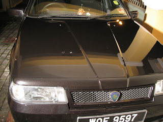

    very impressive finishing with M105
    Very tired but satisfied
