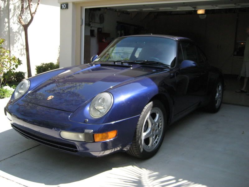

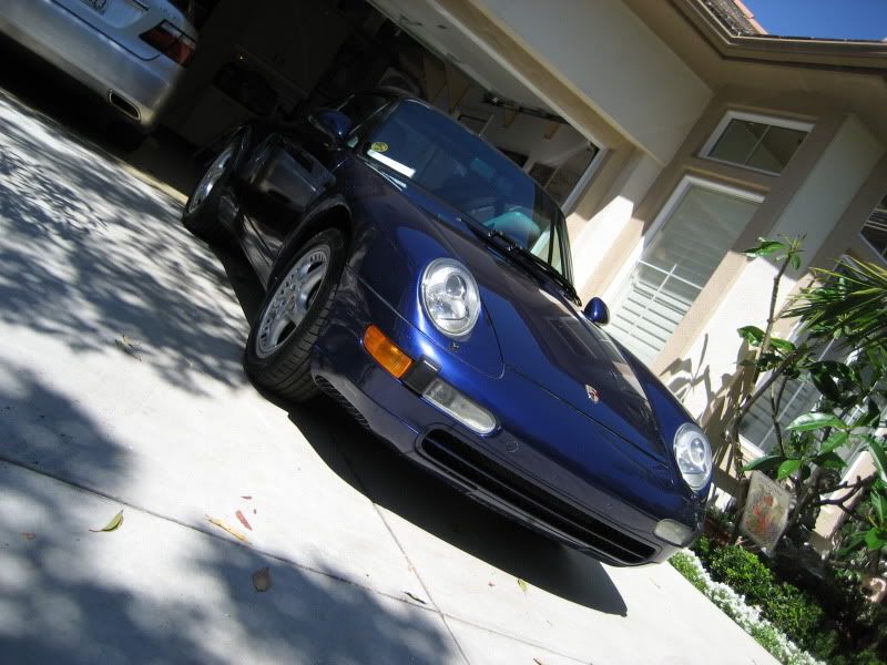

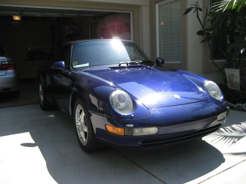

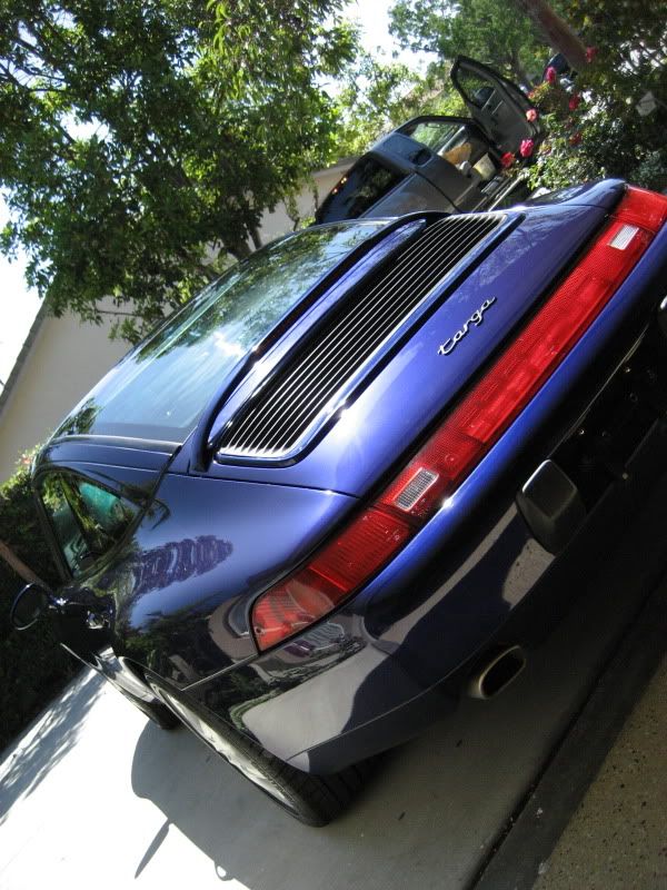

    I did a Porsche Targa over the weekend. Sorry I don't have tons of pics, but it was hot and I was tired from the 4th. Here's my process
    Wash: Megs Hyper Wash with Squirt of ONR
    Wheels: Megs Multi-Piece Wheel Cleaner
    Tires and Wheel Wells: All Purpose Cleaner with foam sprayer
    Dressed Tires: All Season Dressing
    Exterior Trim: Gold Class Trim Detailer
    Dressed Wheel Wells: Hyper Dressing 4:1
    Windows inside and out: D Line Window Cleaner (The Roof Was Glass!)

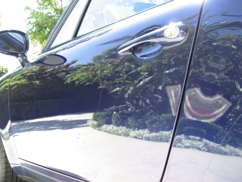

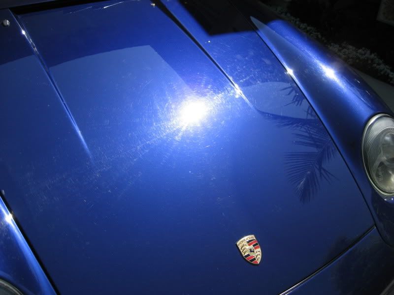

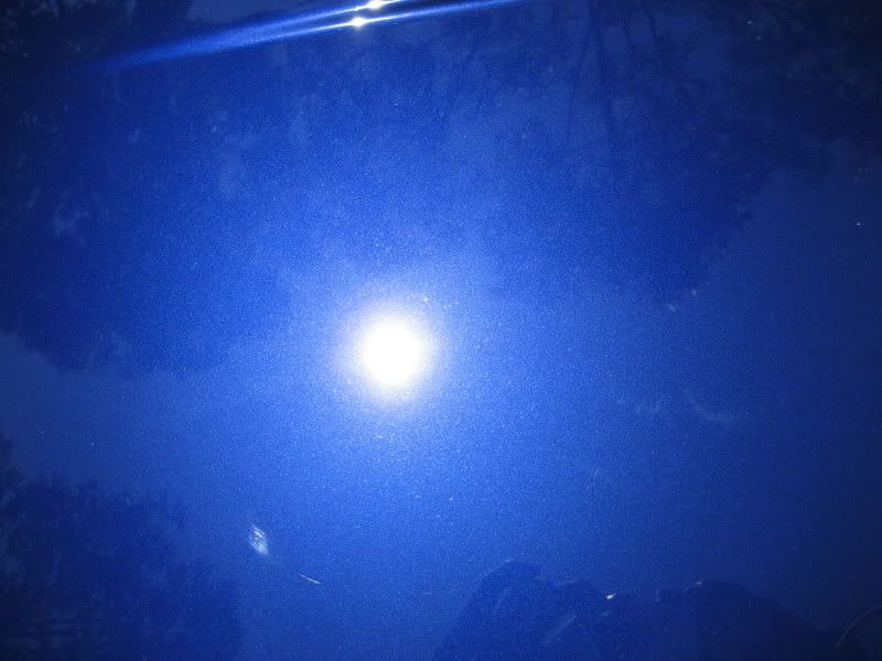

    Correction: 1 Pass of M105 on Megs yellow polishing pad
    Wax: NXT 2.0 by hand
    Plast X on headlights
    Vacuumed Interior
    Cleaned off Interior Plastics with M39
    Dressed with M40
    Cleaned leather and conditioned with D Line Leather Cleaner
    Shampooed Carpets with Bissel LGM and APC+
    Enjoy
    Yeah I missed a smudge of wax, I cleaned it up after the picture when I saw it:
    Sorry I forgot to snap interior pics.
    Remove swirls my friends.

                  It just looked so dull before with all those swirls.But you made it glow again.

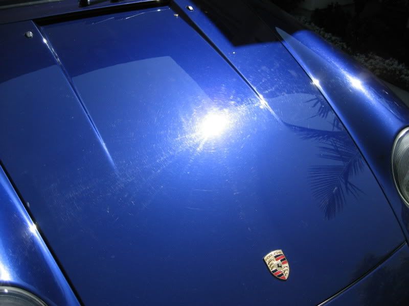

                            The paint was pretty hard, but in decent shape. Removing all the swirls made the rock chips more evident though.
