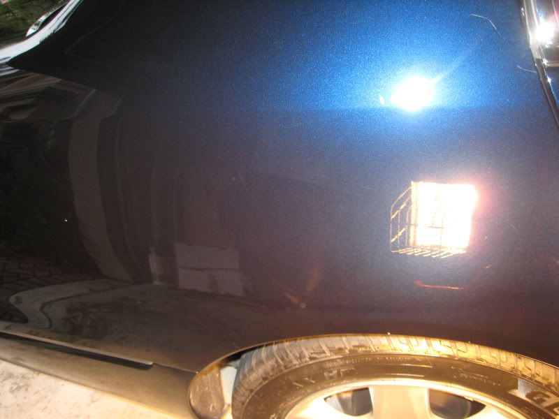

    Paint condition

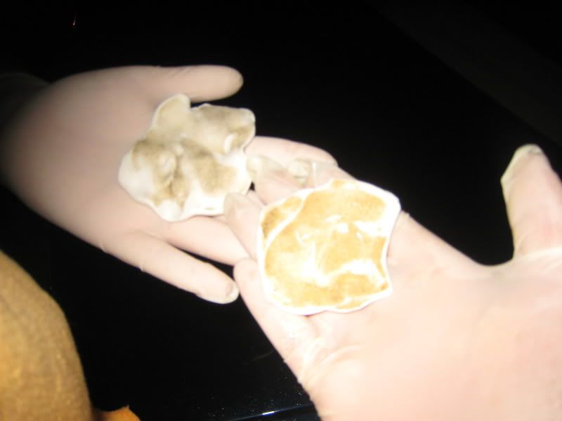

    Dirty Clay!
    Fogy lens yay!

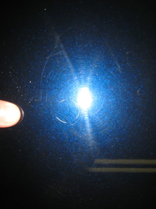

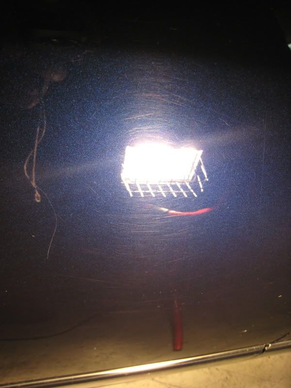

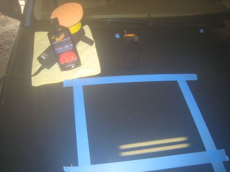

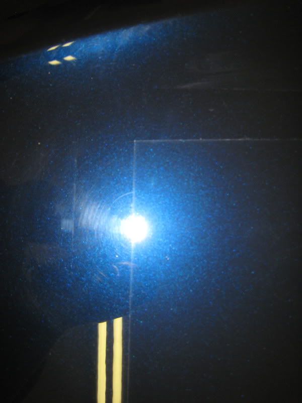

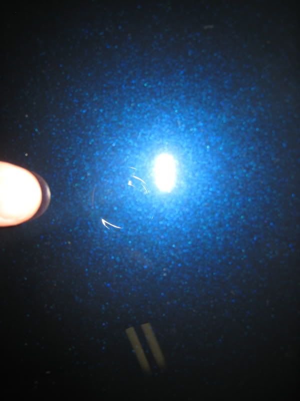

    Test spot

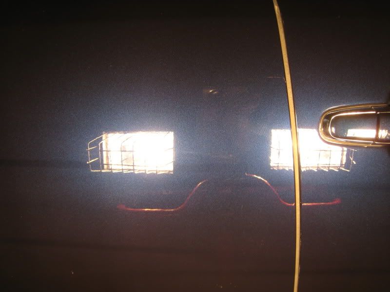

    Before
    After
    Before
    After
    Before
    After ( silver swirl is camera lens :O)

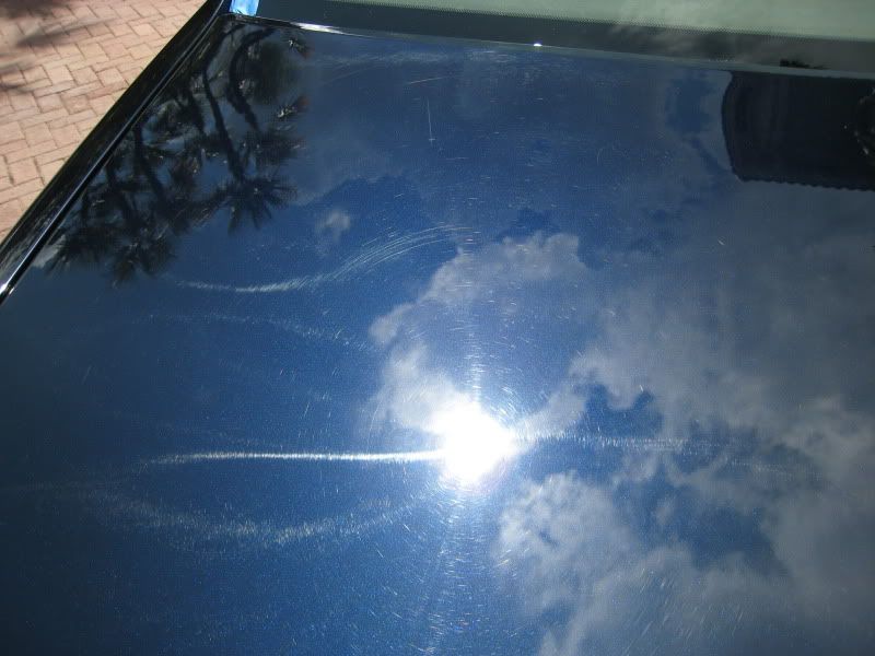

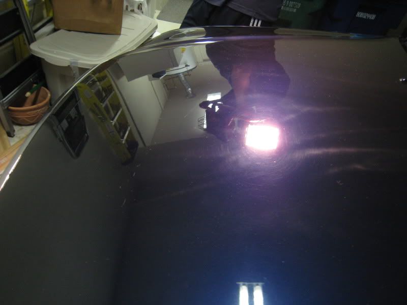

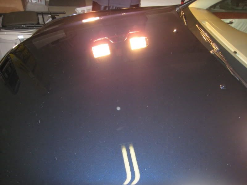

    Hood Before
    After

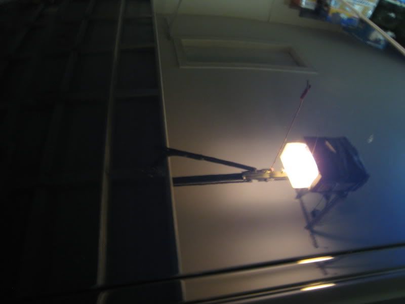

    Reflection

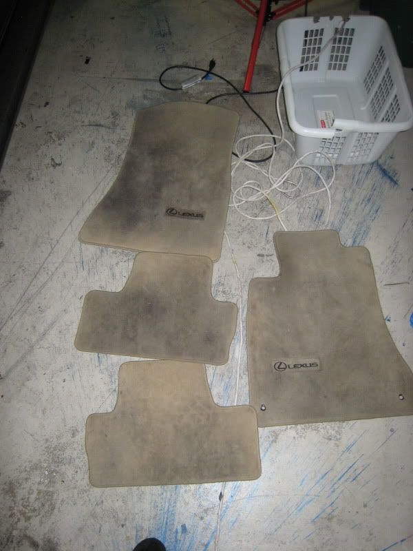

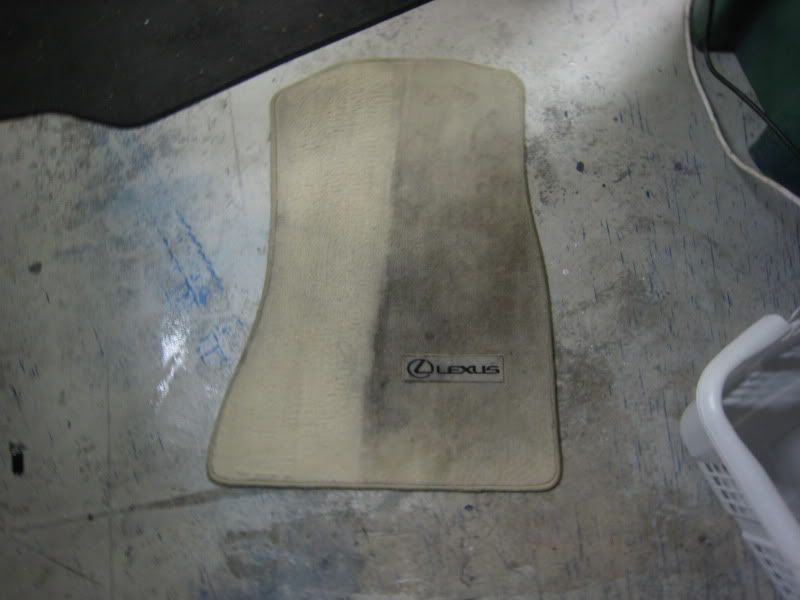

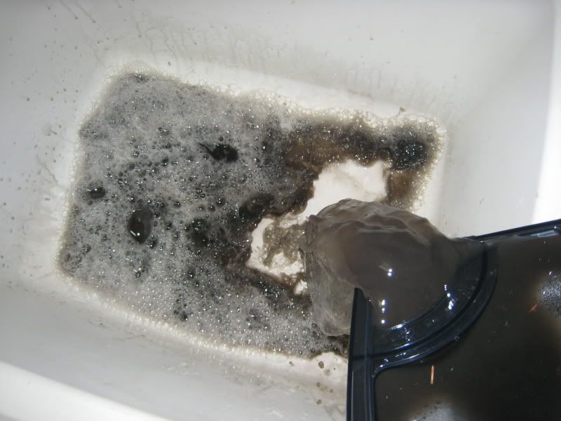

    All Interior Carpets (carpet below is Top left)
    Passenger Interior Carpet 50/50
    Any one want a cup?
    I don't know why some of the afters the blue color looks kinda faded but it does not look like that in person something to do with the camera :O
    Thanks again Bounty for the help and quick answers
    Thanks for looking

    My godness was this a construction lexus? Great work those matts were nasty
      Re: Detail Lexus LS430
      That carpet sure looks attractive. What did you use to clean it with?
        Its my Dads DD, he never really got it cleaned other then a quick vacuums. He had his 60k service the other day and they cleaned it up a little bit but not by much as you can see.
        I have a wet vac for the carpet we have in our house I just used the Hand tool with Some carpet cleaner

                If you could have went over it again with some swirl-x on a white pad or blue pad, it would have looked insane..you got it to finish down well though with the UC and orange pad..
                      It looks like its a bit of compounding haze. An orange pad will cut the defects out but it can leave the paint hazy. If you follow up with a white pad or black pad with a light polish it will remove the haze and really bring out the gloss.
                      Car looks good though. Nice job on those carpets.
