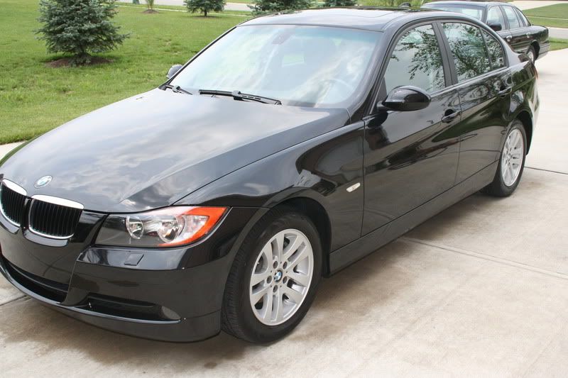

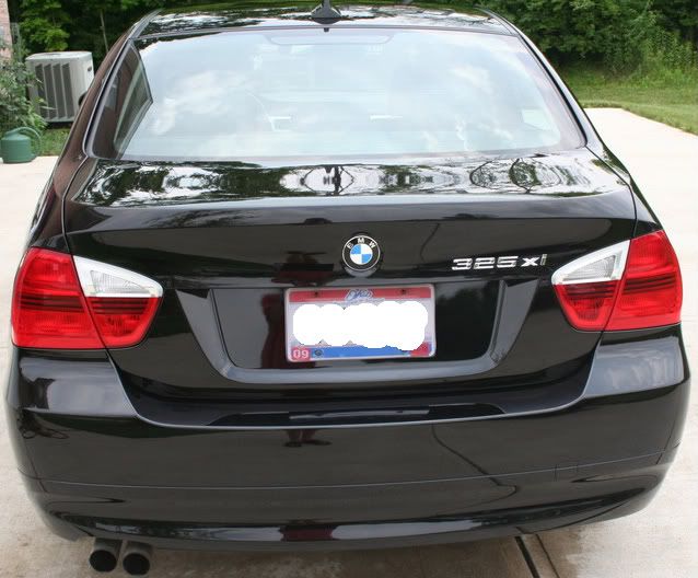

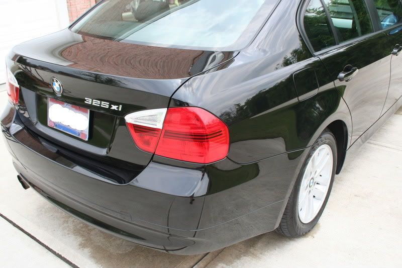

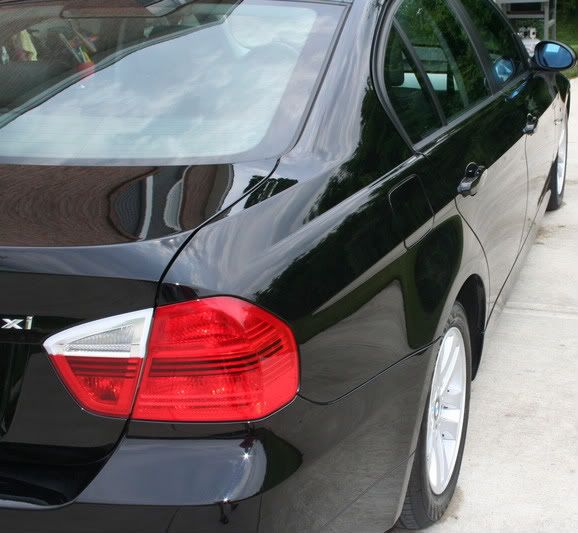

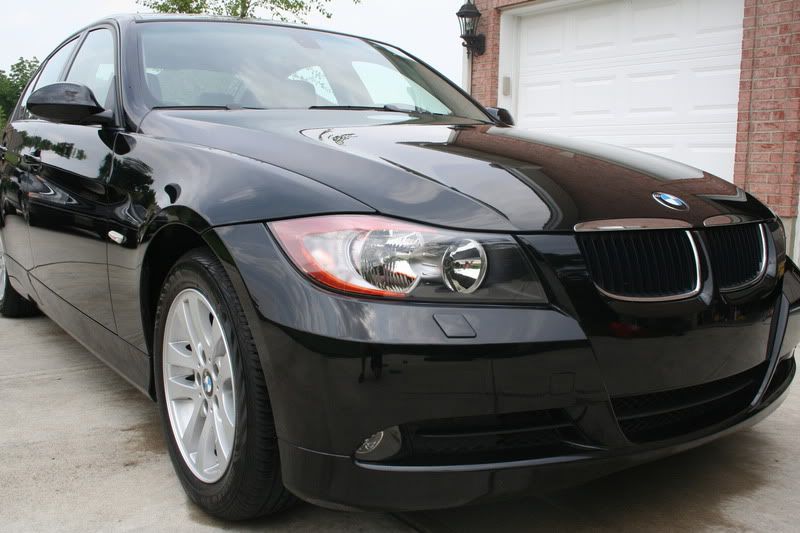

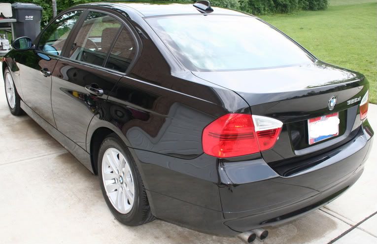

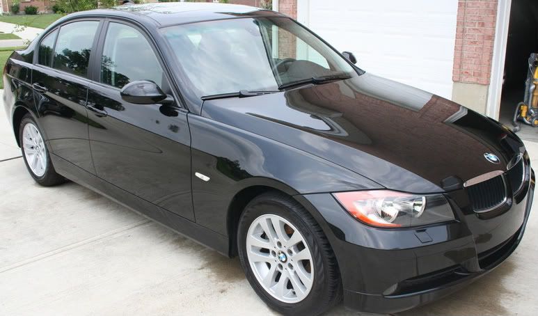

    Here is one of the cars I recently detailed. The owner keeps it in good shape. All I have is After Shots for this car. The car had some Swirls, and the paint thickness was hard.
    Process:
    Wash:Gold Class Wash, 2 Buckets, Grit Guards
    Clay: Smooth Surface Kit
    Polish: M105/205 by Polishing Pad/DA
    Wax: NXT 2.0 Wax by Finishing Pad/DA
    Finish: Last Touch

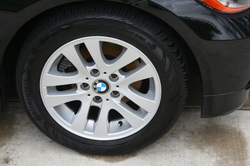

    Wheels: QWD, APC+
    Tires: Wesley's,Hot Shine Gel
    Windows: Detailer Line Glass Cleaner, RainX
    Headlights: PlastX By Drill
    Interior:
    Vacuum
    APC+--Little Green Machine
    Supreme Shine Protectant
    Detailer Line Leather Conditioner
    Here are a few pics, I was busy and didn't have much time with it, but here's what I got:

                    Thanks for your comments
                    Yeah, the paint was very hard. Instead of the normal 1-2 pass method I normally use, I had to do about 3 Passes with M105 and 2 with M205. Great Car though.
