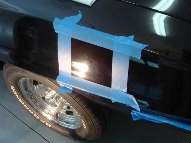

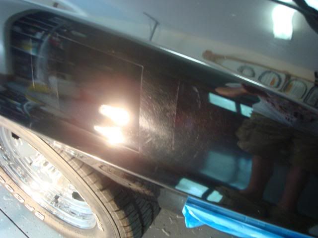

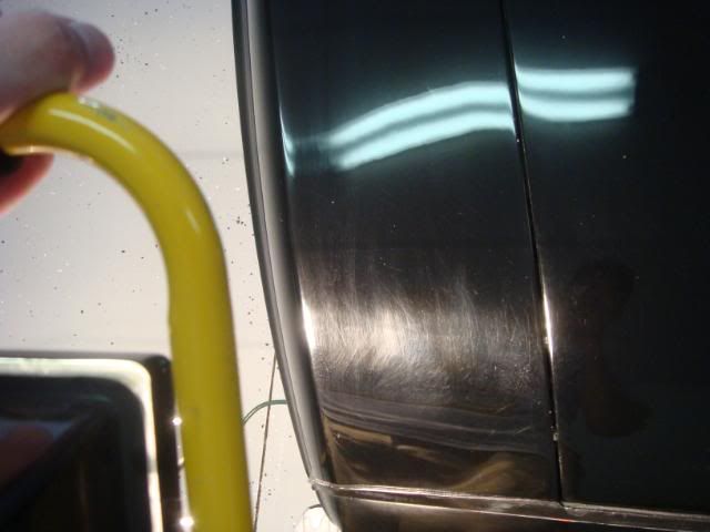

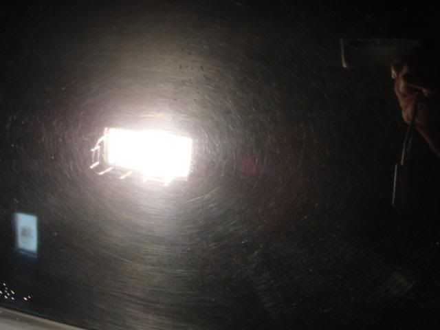

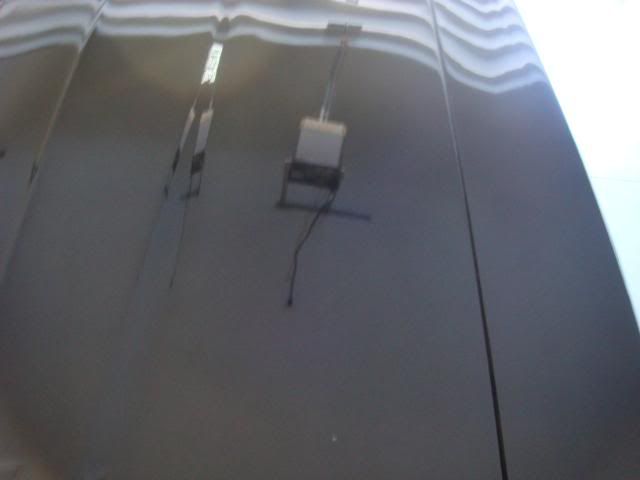

    This is my girlfriends uncle 1969 firebird.

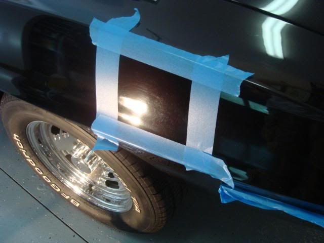

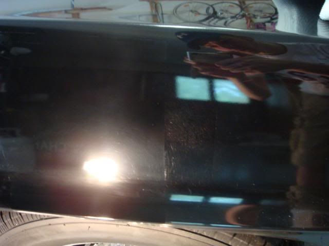

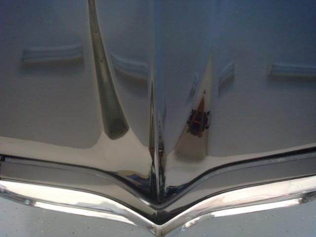

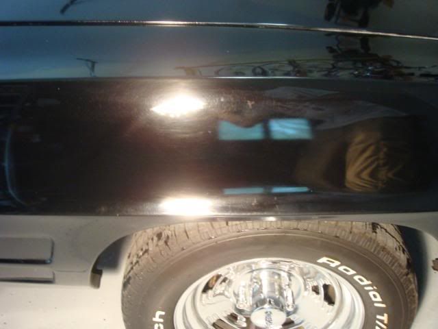

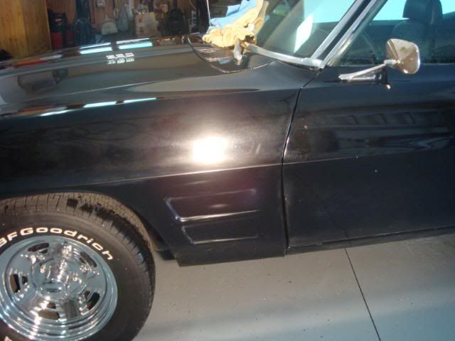

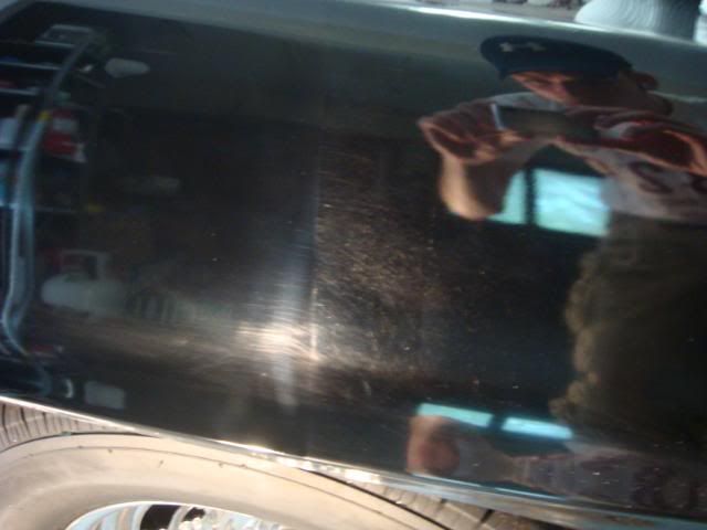

    Heavily swirled. I dont have much after shots, but here are some pictures non the less.

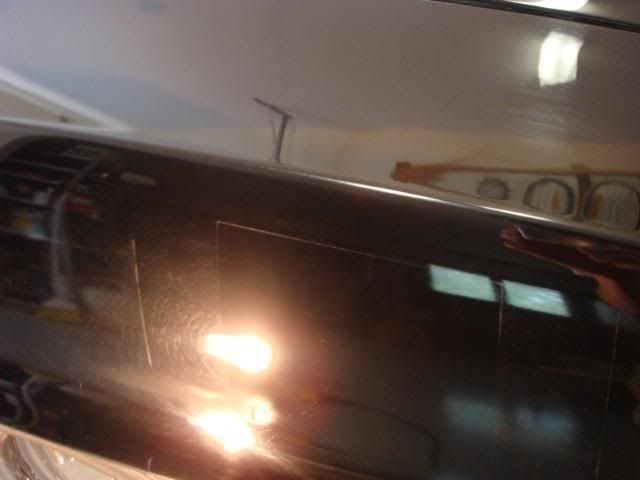

    \/ One pass of M105 with some LCCs pads and M105. The paint was soft so I had to follow up with M205
    /\ Finished with some 205...

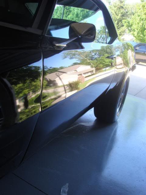

    And some final shots

            Great work! BTW what CCS pads did you use for the M105 and M205?
            Round House Kick...
              Re: 1969 Firebird.
              I think I used the white pad for M105 and red for 205.
                Re: 1969 Firebird.
                Thank you for the reply, I will try this process out. I've been working on my buddy's M3 and haven't noticed any major improvement using SwirlX,- Hopefully M105 will do the trick.
