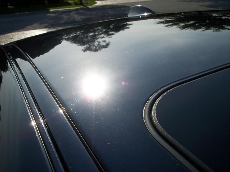

    Had another BMW sent to me for a detail prior to lease return. This one is a 2007 BMW 535i in pretty fair condition. Car is a deep Midnight Blue and had only light swirling. There were, however, some major spot defect removals required and its paint condition just had a dull apearance. We're still dealing with horrible weather down here in South Florida so this one won't be a full write-up but more of a "click & brag" type posting.
    Condition as delivered...

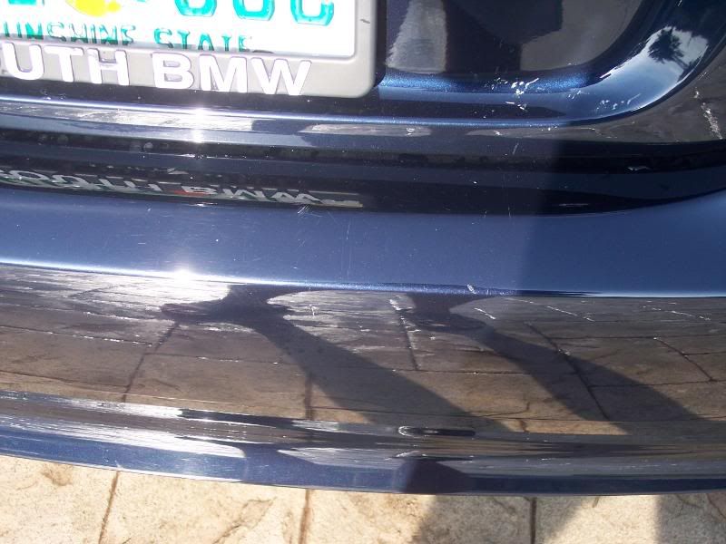

    Trunk/rear bumper area served as a bike rack for a year and ripped up the paint pretty badly...

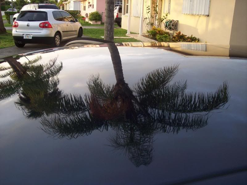

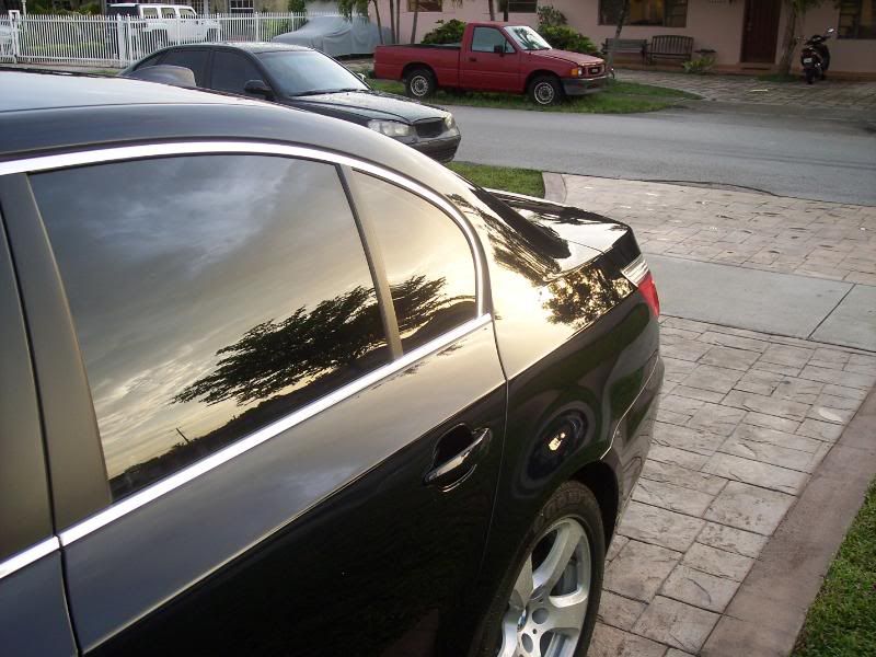

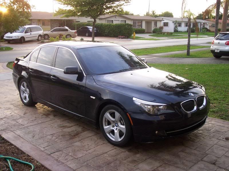

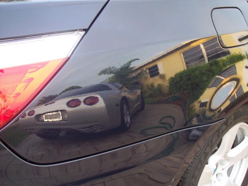

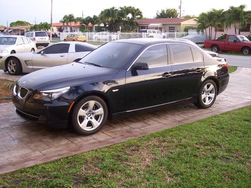

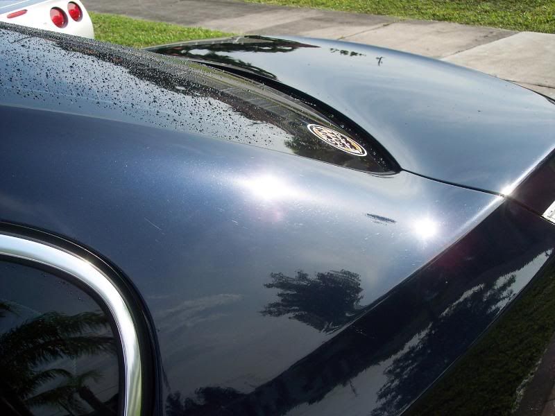

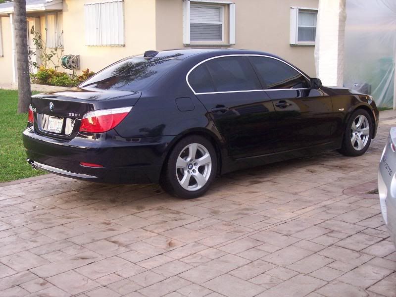

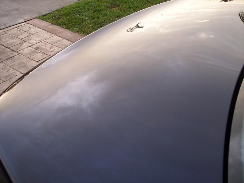

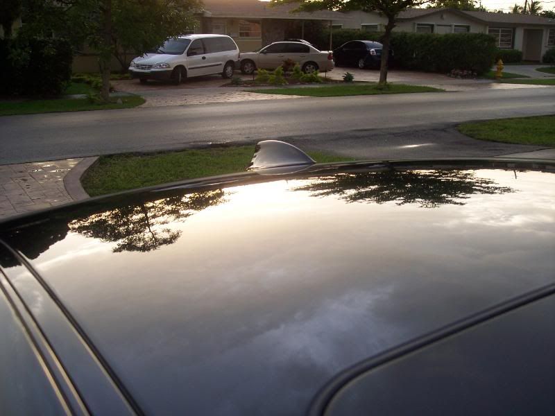

    Sun was setting on this job as I was wrapping up. Customer was pulling in just as I was grabbing the camera so had to stand there and do the usual post-detail rundown and walk-around. Here's some of the quick afters of the results and gorgeous reflections...

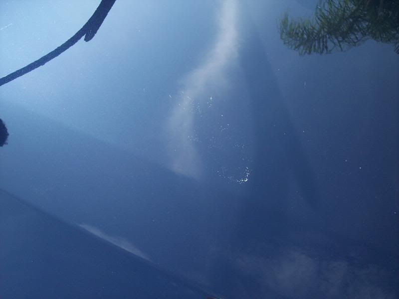

    And of course a closeup reflection shot of the detail rig in the paint...
