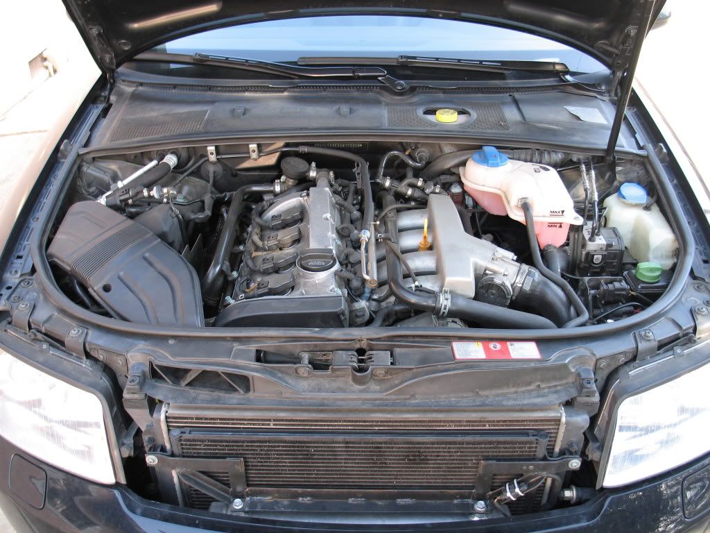

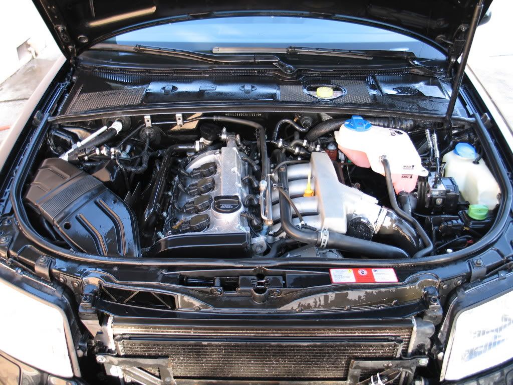

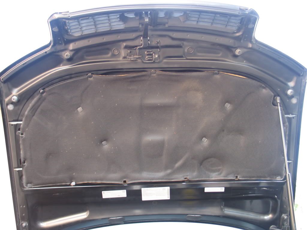

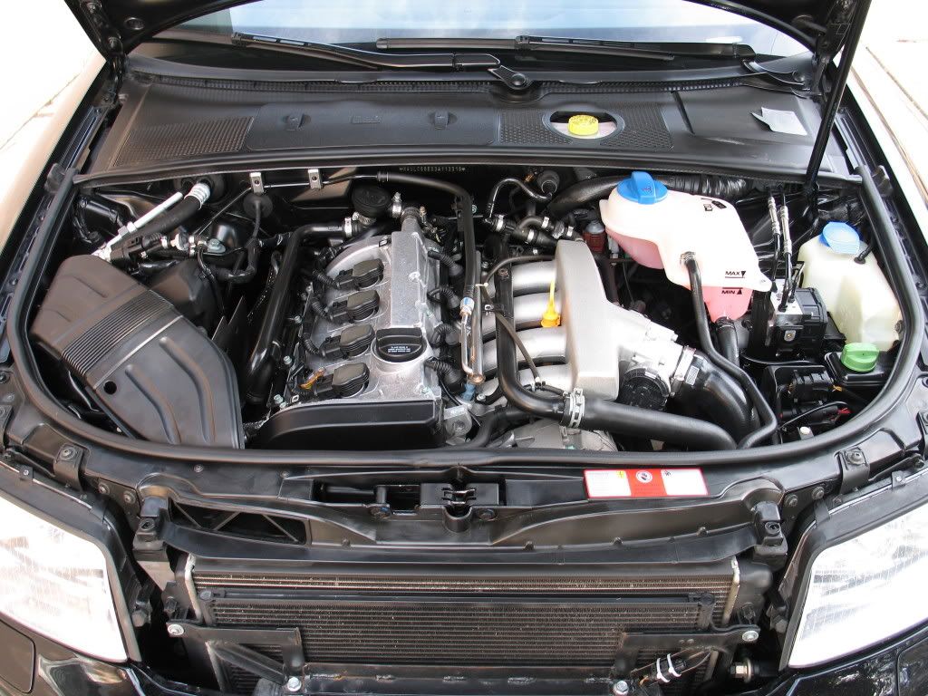

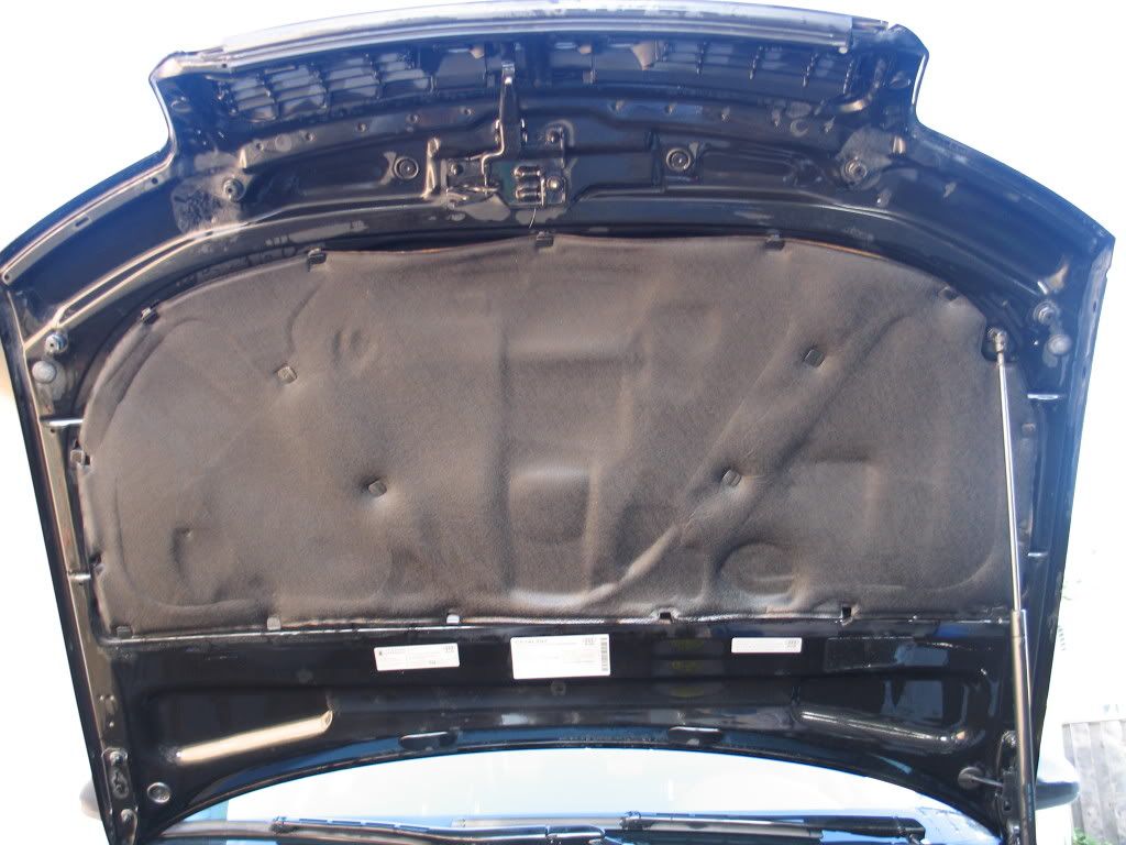

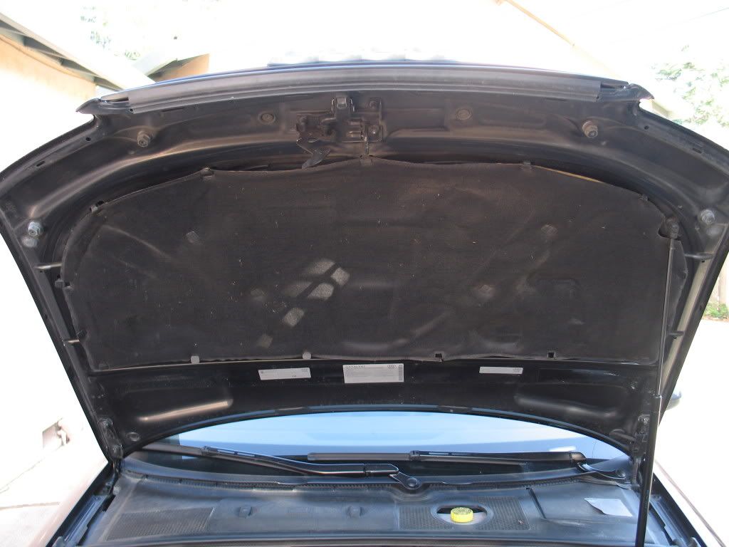

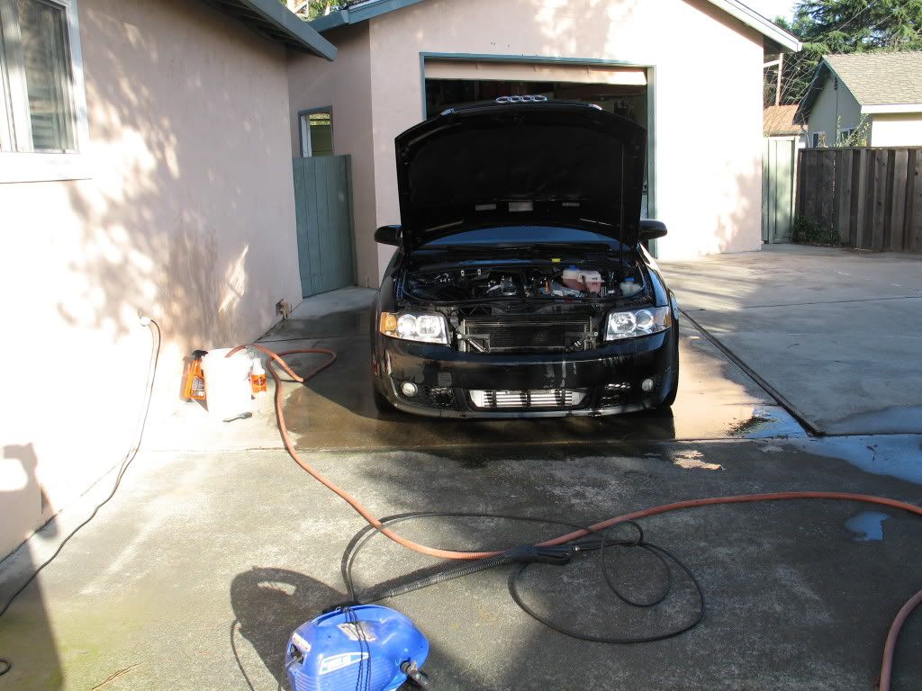

    This was a first time detail on the engine and you can definitely tell by the pictures. It had about ~95k miles on it.
    • Tools and Products
      • Campbell Hausfeld Pressure Washer
      • Megs D103 APC+, 4:1
      • Megs Slide Lock Detail Brush
      • Costco MicroFiber
      • Megs D170 Hyper Dressing, 3:1
    • Process
      • Pressure wash under hood and engine from a safe distance (i.e. ~2-3' away with constant movement, never lingering in one area).
      • Spray area w/ APC+ and let dwell.
      • Agitate dirty areas with brush.
      • Repeat pressure washing.
      • Dry with dedicated microfiber.
      • Start car to aid in drying process. Let idle for a several minutes.
      • Spray area w/ HD and let dwell. Wipe off excess.
    Before
    During
    After

                  Thanks everyone.
                  I've read different ways to detail an engine. IMO, if you don't saturate "critical" areas, you should be fine.
                  Critical areas would be electrical junctions, intake, and any cavities that would retain water. For those areas, an air compressor would be useful.
