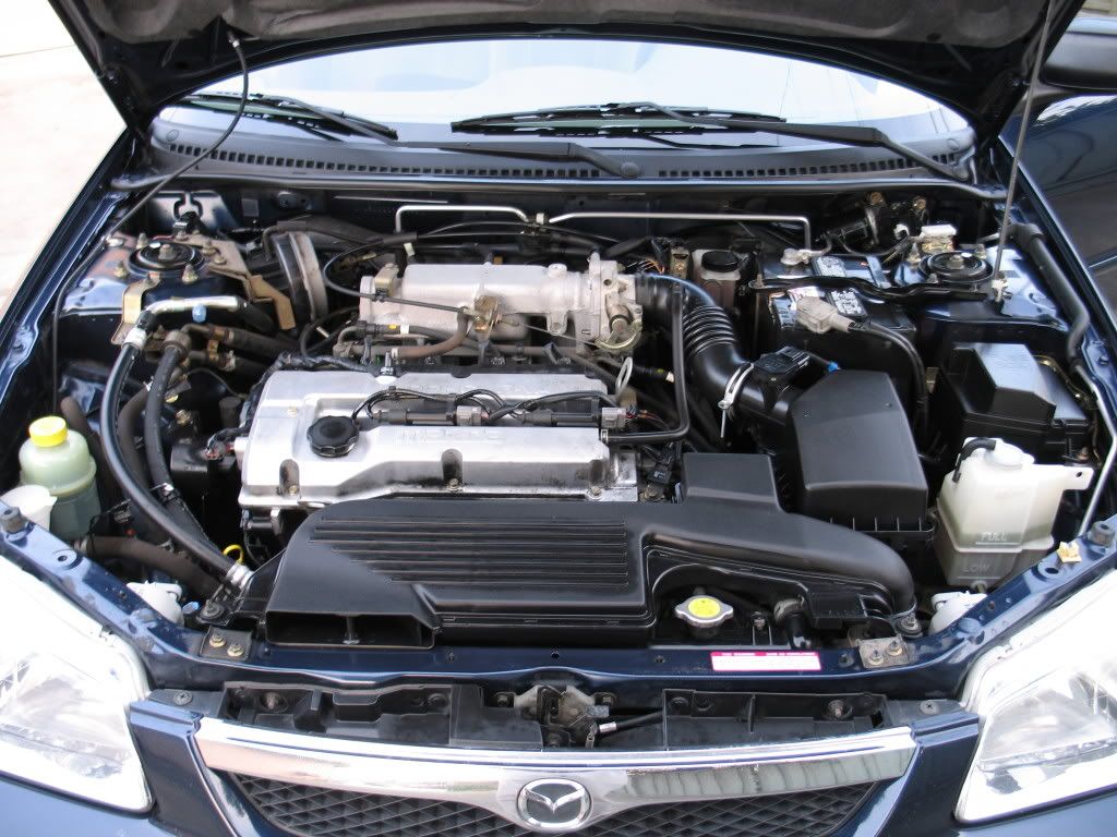

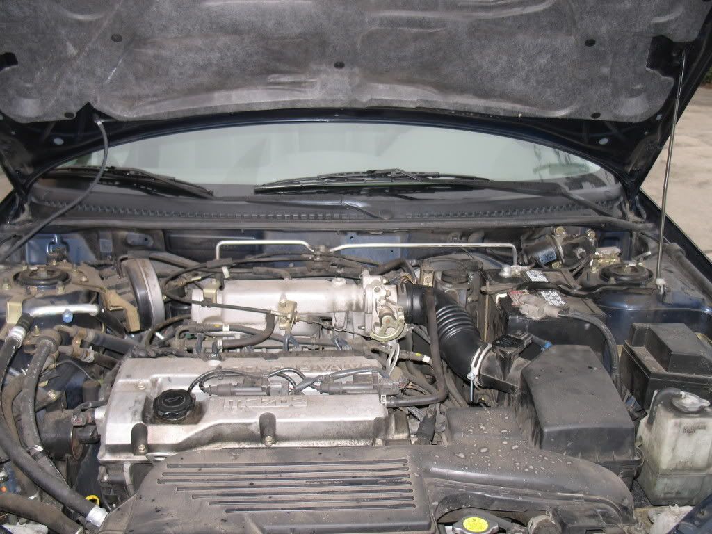

    This was a first time detail on the engine and you can definitely tell by the pictures.
    • Tools and Products
      • Campbell Hausfeld Pressure Washer
      • Megs D103 APC+, 4:1
      • Megs Slide Lock Detail Brush
      • Costco MicroFiber
      • Megs D170 Hyper Dressing, 3:1
    • Process
      • Pressure wash under hood and engine from a safe distance (i.e. ~2-3' away with constant movement, never lingering in one area).
      • Spray area w/ APC+ and let dwell.
      • Agitate dirty areas with brush.
      • Repeat pressure washing.
      • Dry with dedicated microfiber.
      • Start car to aid in drying process. Let idle for a few minutes.
      • Spray area w/ HD and let dwell. Wipe off excess.
    Before
    After
    Re: 1999 Mazda Protege LX
    Looks fantastic, nice work!
      WoW, great turn around on that engine!
      Looks better than new!
      Good show
