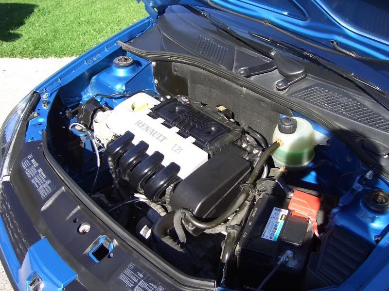

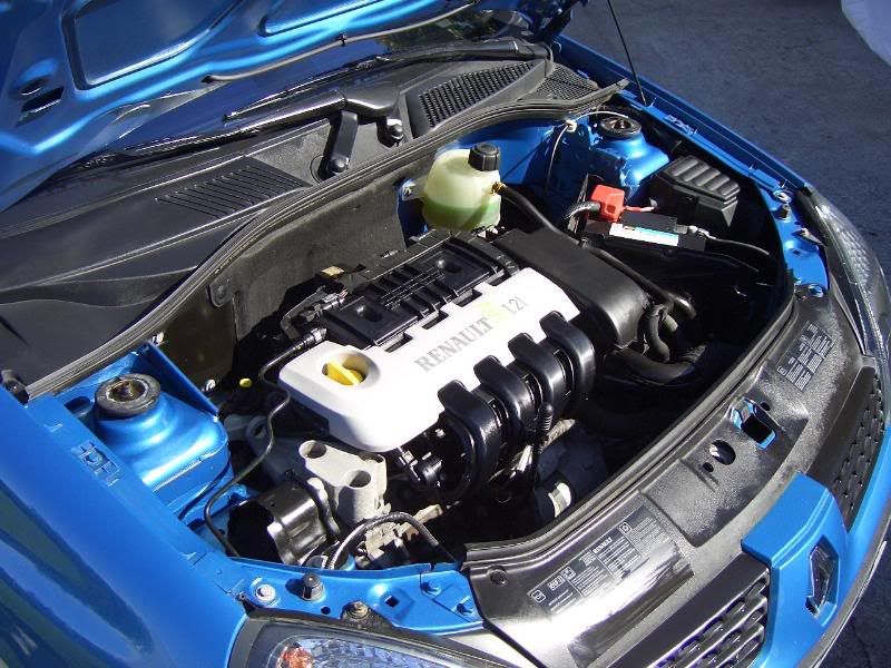

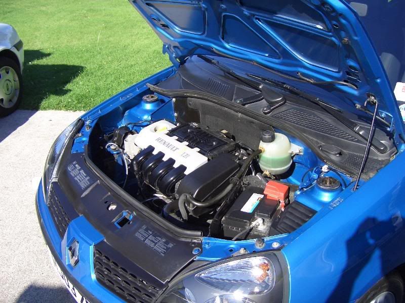

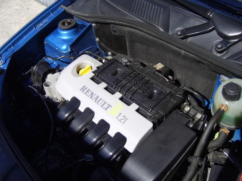

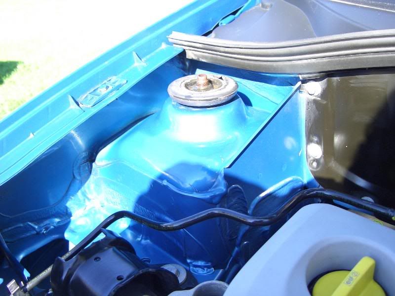

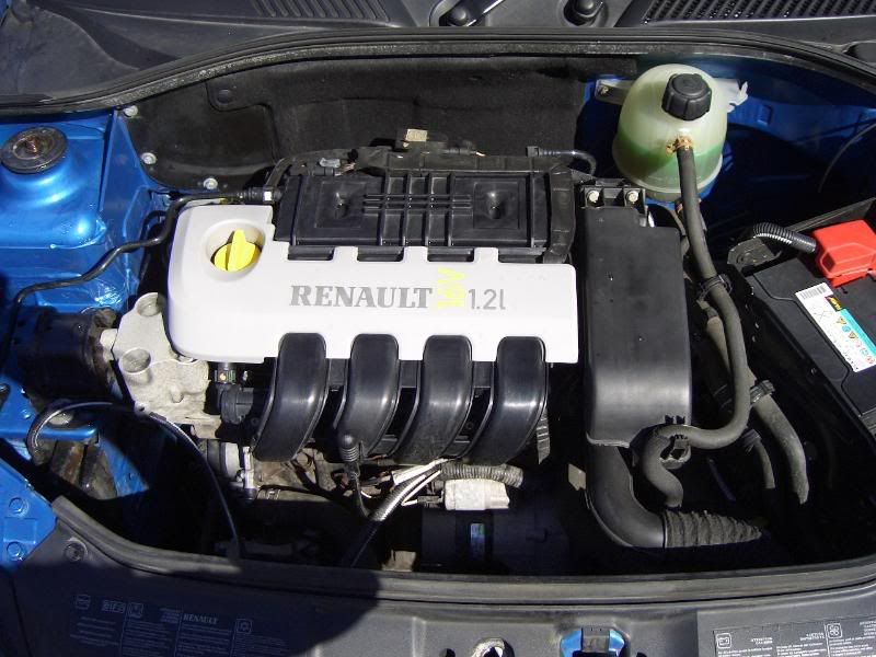

    Today I have had ago at tiding up the cars engine (seems to be worse now it lives outside to make way for my dads car, I tried a product I hadn’t used in a long while ‘Gunk’ an engine degreaser, I must stress time was short and it wasn’t a perfect job, but looks better I think.
    The process was:
    · Run Engine to warm, but not to normal temperature
    · Wrap all connection in cling film
    · Spray Gunk on and allow 5 mins to penetrate the dirt and grease and can agitate with a brush also.
    · Rinse, Then ran the engine while rinsing the drive way
    · Followed by a quick drive to aid the drying process.
    · Surfaces were spray waxed, and plastics or rubbers dressed where possible.

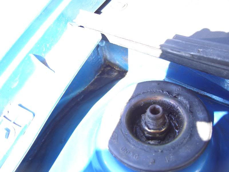

    Befores:

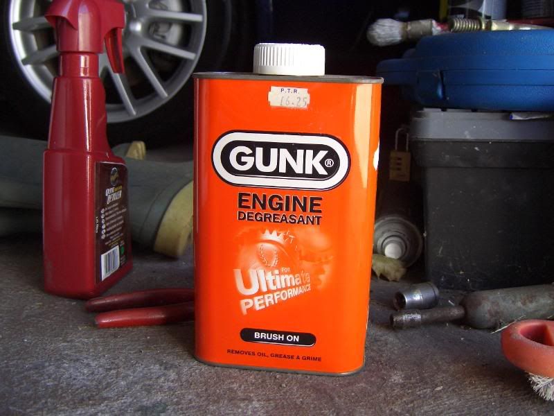

    The Product:

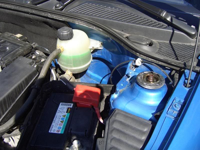

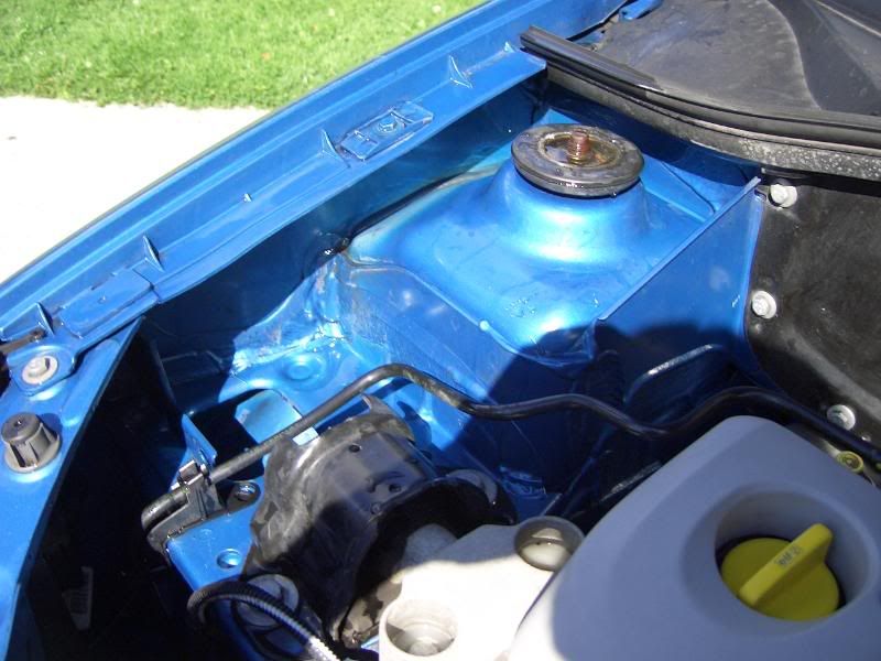

    Afters:
    Afters with Dressing / Wax:

          thanks for the comments, it was lookin a bit dirty for a car with sub 40k miles on, i used Autoglym Vinyl & Rubber Care for the plastics, it doesnt last as long as Trim Detailer on the exterior parts but as with all Autoglym is simple/effective and targeted for the average car owner

            Looks kinda clean for a car with 40k I thought. Then again my engine is often covered in mud..
            Engine sure has a small belt.

              on the engine clean. "gunk" - never tried that product before but does it stain white on the paint surface and/or rubber?

                thanks, yeah i assume the belt is quite small, its only a tiddly engine but cracking to clean with having so much space around, its got a 1.2 with 16v and a overwhelming 75 bhp! 0-60 in 13 seconds, it does the job when petrol is currently at 115pence per litre, so its advantages are group 3 insurance (out of 20) and does 49mpg.
                Cheer,
                Tim
                it does a good job of cleaning grease and grime from some places without agitation which is good, other need a bit of encouragement, i am a little uncertain as to whether it didnt rinse it of enough of if it the result of water drying in the sun (back to rain today usual weather of England), i wiped the plastics with QD, came up all right but the Gunk clearly removed any trim detailer from the last engine detail. i did the same with the paint wiped and then spray waxed.
                A word of Caution is it states not to be used on clear coated surfaces, i did a test spot, and the paint under the bonnet i am certain has no clear coat, its not the same quality as on the exterior.
                I have also been told by the Administrator on the Meguiars UK forum an Engine Degreaser and Dressing is on the way soon... (see bottom of post)
