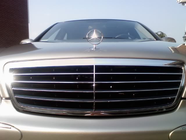

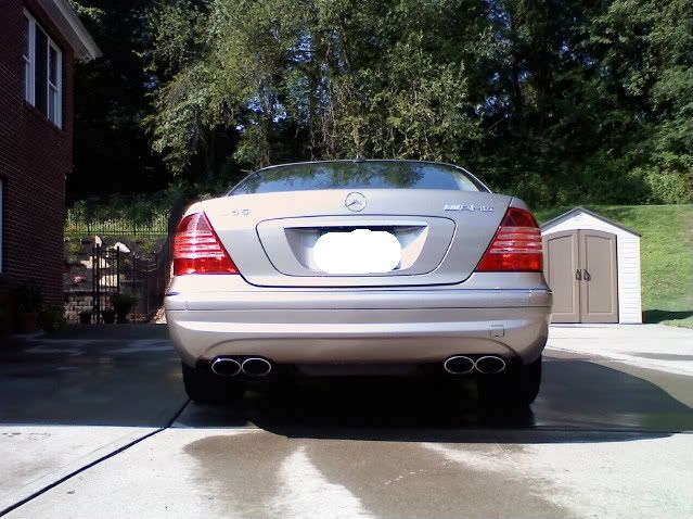

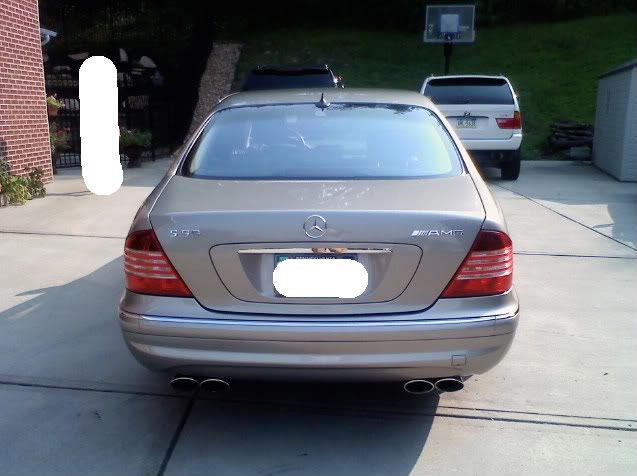

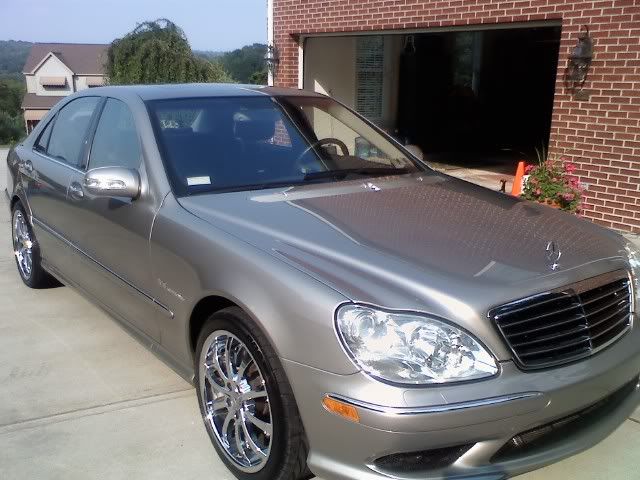

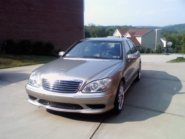

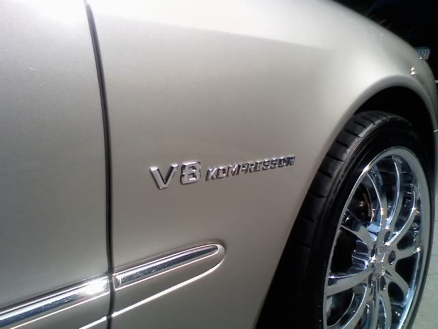

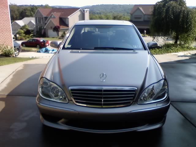

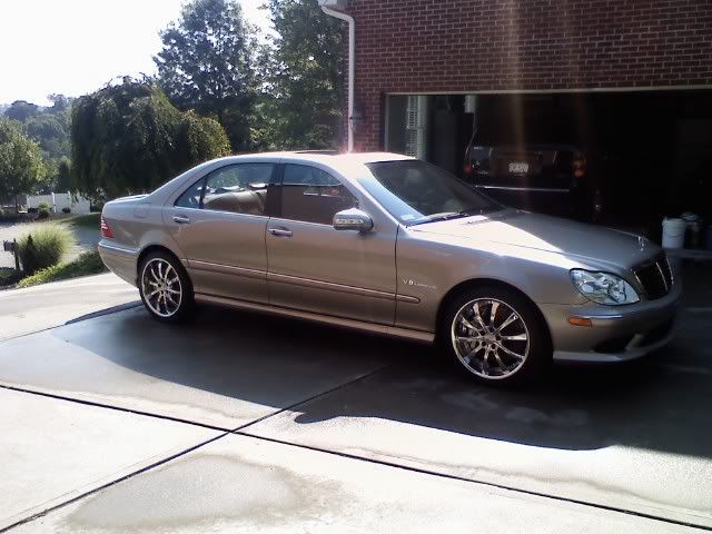

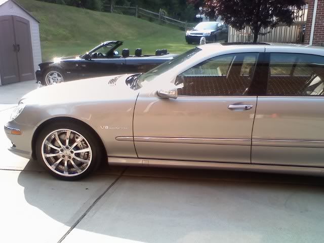

    Here is yet another car I have done. Now, this car was in great shape with very few defects. There were light swirls through out the paint though. This is by far one of my favorite cars I have done and this car had all the bells and whistles. your looking at a price tag of well over $150,000 for this car.
    Before shots:
    After shots:

    Nice work. Are those Alcon brakes?

            Good job on that! The wheels look a bit 50 cent for my liking!
