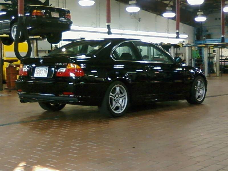

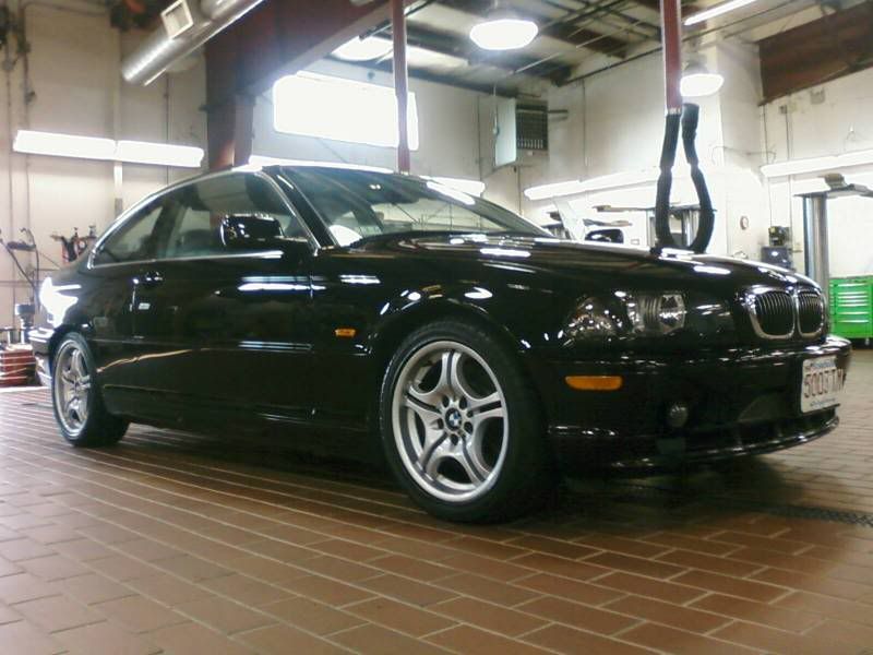

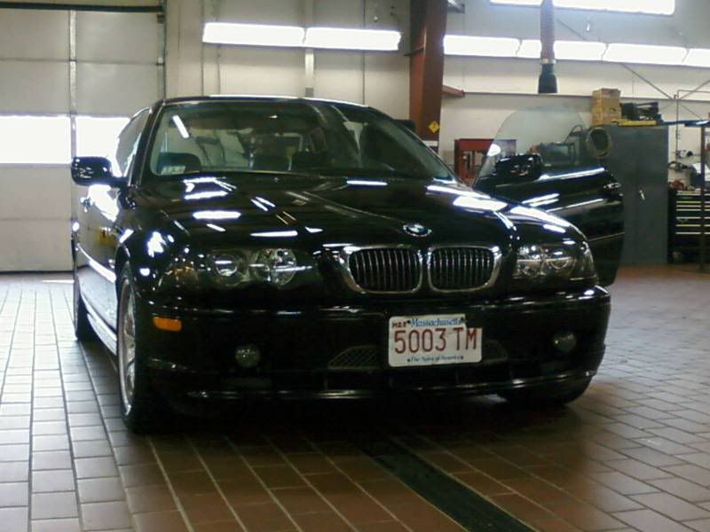

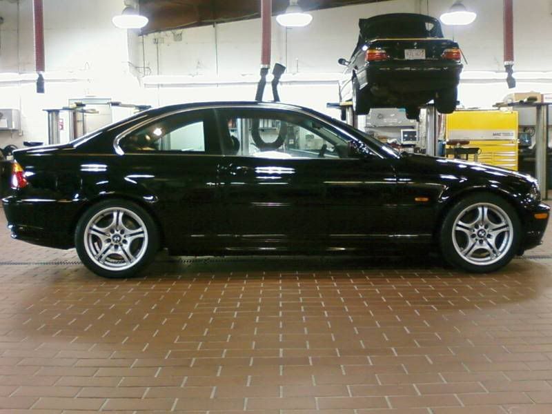

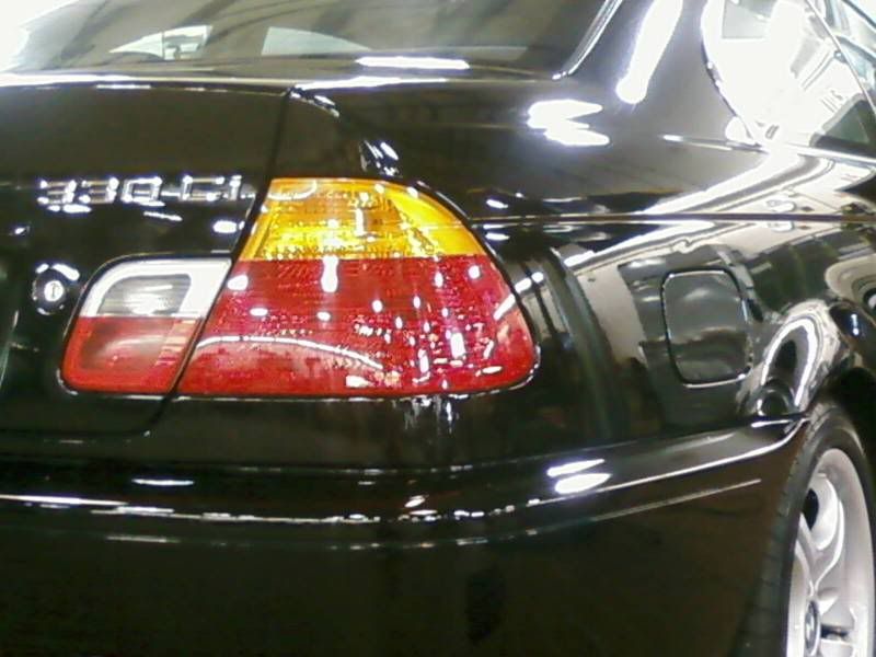

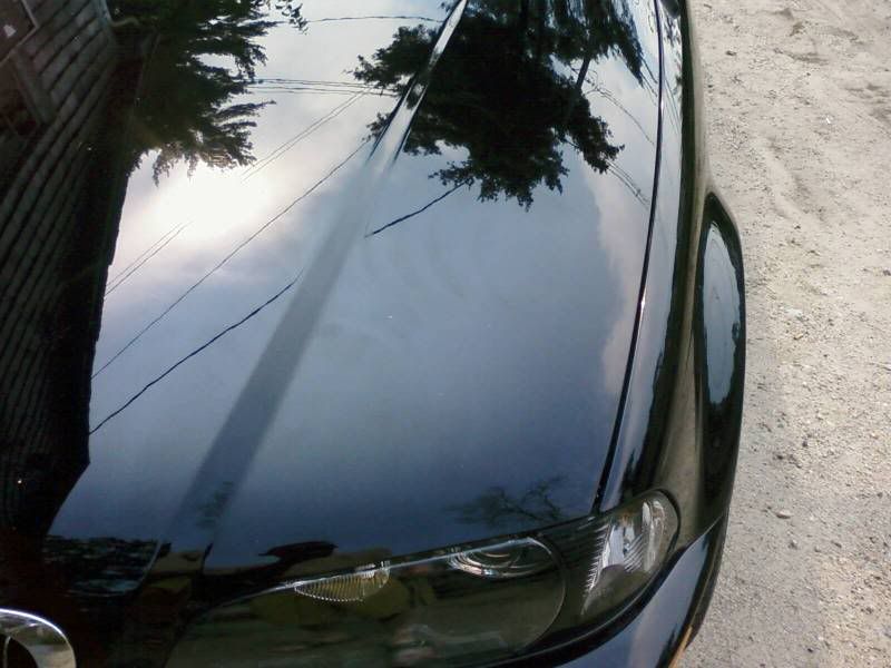

    so yea i felt like finally detailing the bimma by my lonesome and by hand w/o a buffa
    i feel i did a very good job for being my first time and by hand
    pix were taken with a cell phone so there not the best
    next car cleaning investment a cheap buffer for practice
    steps i did
    meguires gold class shampoo
    dry
    meg's ultimate quik detailer
    dry
    meg's deep crystal paint cleaner
    meg's clay kit
    meg's deep crystal polish
    2 coats nxt
    interior
    meg's quik interior detailer
    meg's gold class leather cleaner

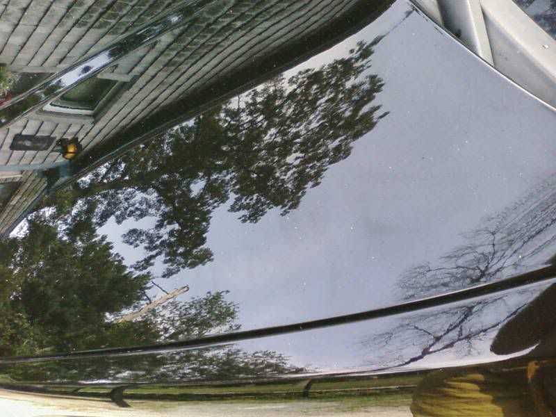

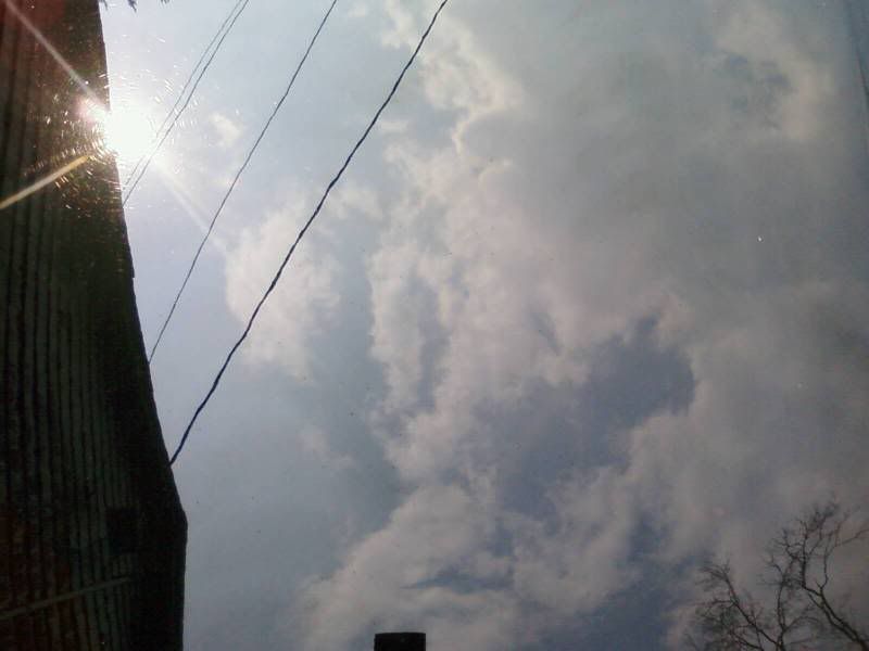

    couldnt make paint swirl marks disapear that well

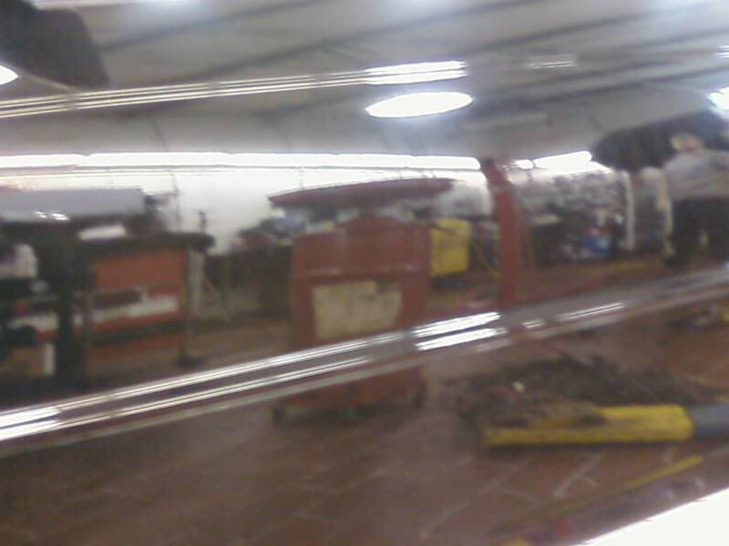

    the part that im a lil upset about is that inside where i cleaned i had no swirl marks under any light
    pulled outside and swirl all over darn humidity
    i was pointed out by a friend that i did one of the steps wrong because i read it wrong on here so ill be sure the next time
    time took about 7-8 hours but i didnt care about the time i had fun doing it and felt like i accomplished something
    + its nice to detail a car in a climate controlled enviorment

    The car looks good for your first attempt. If you want those swirls out, you have come to the right place!

      very nice esp by hand on solid bmw paints
        Re: first time detailing 01bmw 330ci
        Looks great from here. I have seen some good advice offered on MOL...
        Evaulate the customer not the paint. If it's a daily driver and not garaged swirls probably aren't on the clients mind.

          Looks good, looks like a pretty new BMW shop as well

            and thats where i work

            now the swirl marks are kinda hard to see but i took some pix maybe i cant be pointed in the right direction

              Looks good for being done by hand. What Bimmer dealership is that?

                Good job. looks good. Lot of work by hand.

                  A couple of comments...
                  Removing swirls marks is hard, especially by hand... that's why in the last 15+ years there have been thousands, if not hundreds of thousands of enthusiasts that have moved up to machine cleaning and polishing with tools like our G110 and the Porter Cable DA Polisher.
                  The machine does a better job than your hand and takes some of the work out of the job.
                  As for light... Meguiar's always recommends inspecting your work before and after in two kinds of lights and one of those is bright sunlight because it will expose swirls really well.
                  One of the things we preach on this forum ALL the time is doing a Test Spot, that is test the products and procedures you're planning on doing to the entire car to one small spot, (This is called the Test Spot), and then pull the car out into the sun and again inspect your results.
                  Make sure you can make one small area look good in two kinds of lights before going over the entire car. If you can't make one small area look good then you won't be able to the entire car look good and you'll be glad you did a test spot and inspected your work.
                  Make sense?
                  Test Spot - Test Spot - Test Spot

                    norwell ma
                    i also did do a test spot but not in 2 sets of lights
                    ehh im a newbie ill learn one way or another
