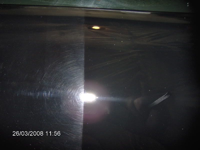

    Ok so i was only able to get one pic before my camera went out but it turned out so perfect. The little particles that look like dust are actually just the camera. The left side was washed, clay bar, and spray wax, the right side, got the works. all Meguiar's products. i will list the process later im in a little bit of a hurry

    That looks great. It almost makes you wonder if a Pro-Detalier should have their car looking perfect, or have it looking half and half. Or at least leave one panel looking half and half.
      Re: Perfection
      Very nice. We detailers should travel around with half panels polished out to show people what we can do. Like Murr1525 said.

        looking great..good job

          Nice job! Great improvement.

            Great job!
            I agree, we should carry half and half pictures.

              ok the process was
              1. wash
              2. claybar
              3. #83 with W7000 pad
              4. #82 with W8000 pad
              5. #7 with W9000 pad
              6. NXT Tech Wax 2.0 with DA only one coat for now
              i do tend to drive around with a section showing half and half just so i can show people the difference in a car wash and car detail which is needed because around here everyone claims to be a detailer but are far from it.

                And each time you can do a small demo for the customer on your own car if they don't believe you with the half and half thing.
                  Re: Perfection
                  Man, what a difference. That finished side looks better then new.
                  I like the idea of a half and half panel.

                    Great Work!
