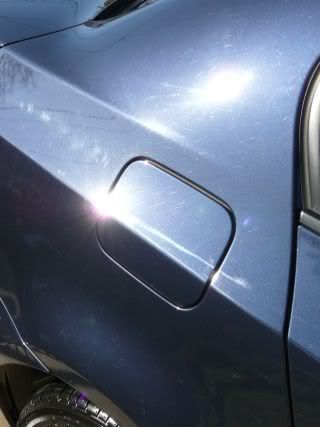

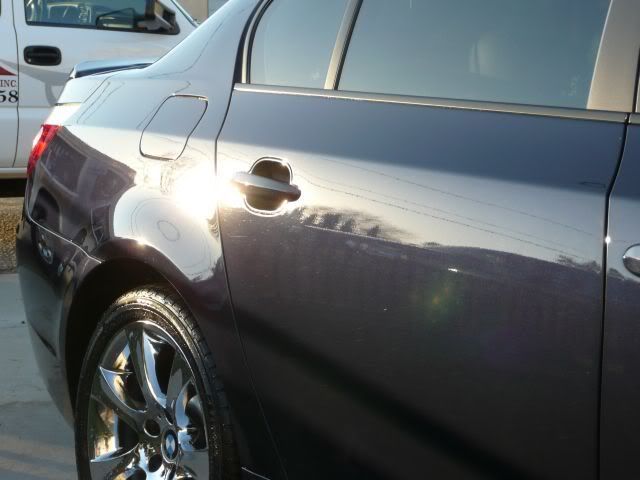

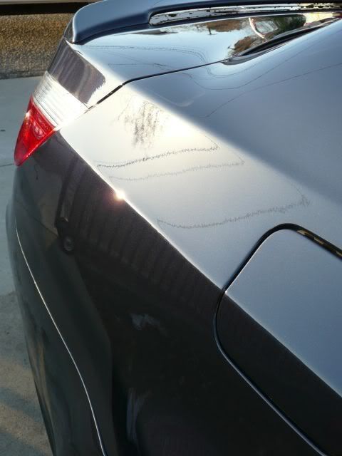

    This BMW 550i had some deep wool pad marks in the clear coat - looks like the detail shop buffed the car with compound and a wool pad and then put on some express wax. Hey, at least I didn't have to clay it!!

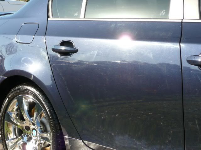

    Here is what it looked liked after a nice bath with Shampoo Plus -
    BEFORE:
    This guy thought his clear-coat was ruined...
    Think Again... and this was only after #105 and a #7006 pad.

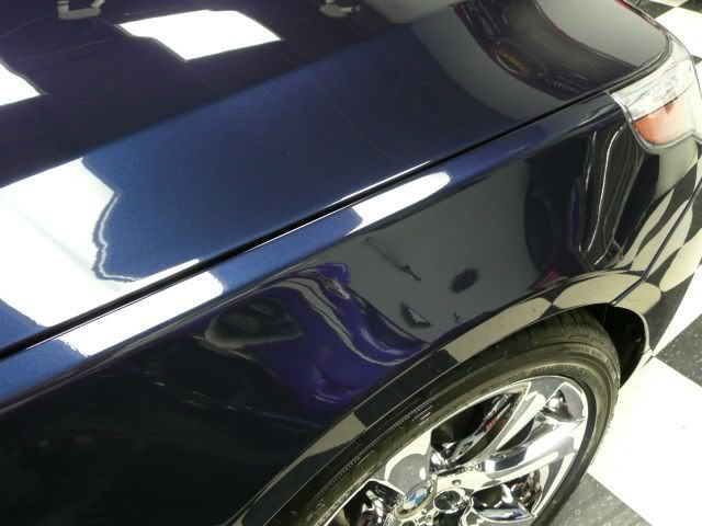

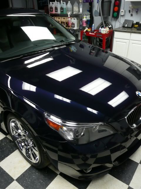

    AFTER:
    Here are some shots in my shop after a nice coat of #21
    (sorry, the sun had gone down.)
    Process:
    shampoo plus bath
    #105 D.A. w/ #7006 pad
    #21 D.A. w/ #9006 pad
    Tires got Hyper Dressing 2:1
    Wheel Wells got WBD 1:1
