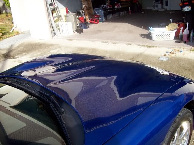

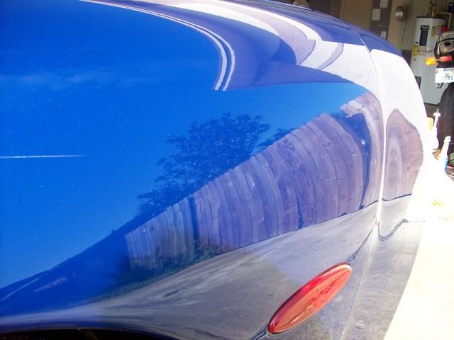

Some pictures of the moderate swirling...
The marring was much worse in person then the pictures depict...

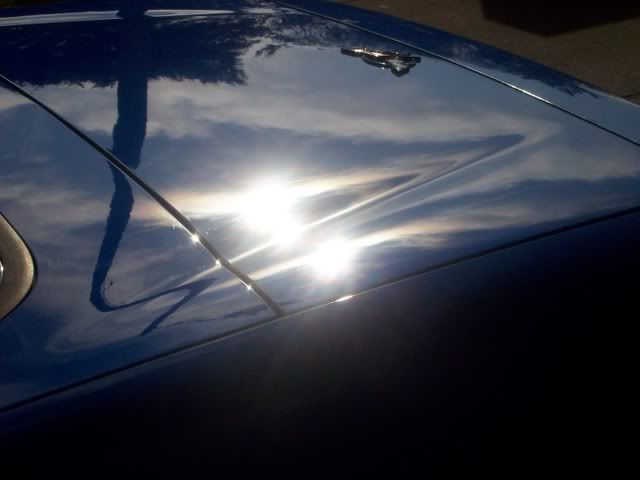

So I pulled the Vette inside and started working some areas. Here is the area after buffing with #83. You can see there is still hazing and light marring, though it looked much better.

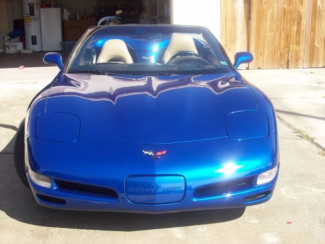

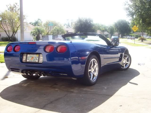

Some early morning pictures...

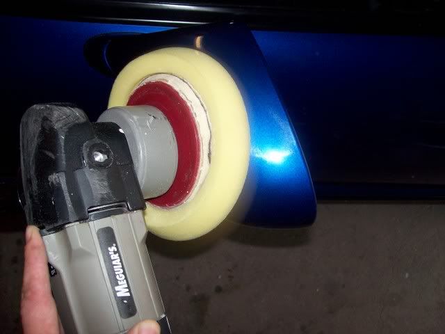

Then I decieded to finish down using #80 Speedglaze on the PC... A picture of me in action, polishing out the mirror wit the PC...

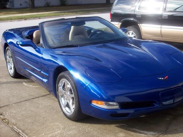

This really seemed to do the trick, as after polishing with the M80, the surface was liquid wet and deep...
and virtually flawless

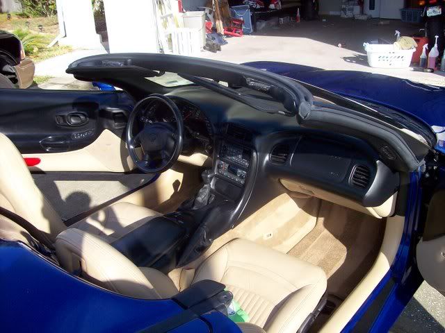

I wiped off the residue and applied a coat of #21 via PC. As the sealent cured I went to work on the interior, cleaning all the surfaces with APC. After vacumming I shampooed the carpets and floor mats and applied dressings to the apporiate surfaces.
Interior afters...
Interior afters...
