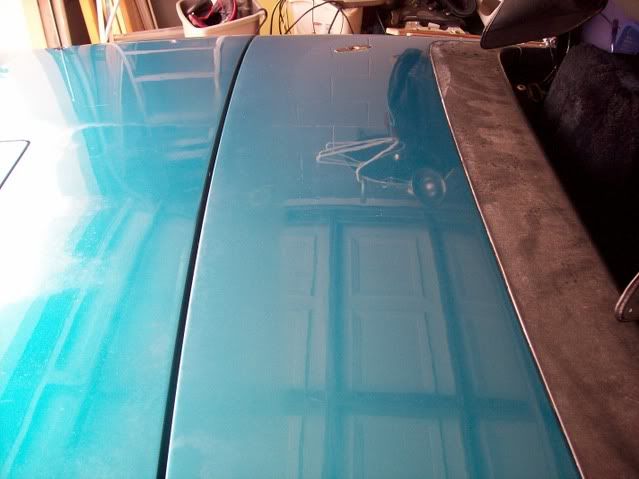

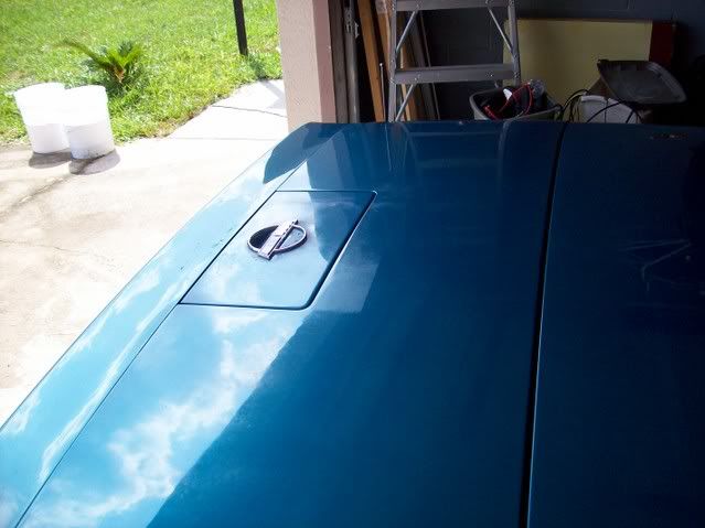

Some befores', it is hard to detect the oxidation in some of the picture.
If you look at the reflection in garage, it almost looks like the clouds continue in. Check out the area to the front of the area in front of the gas cap. Its perfectly square because I tapped the area to test a section, but it cloudy and no reflection. Also you can see some of the oxidation on the gas cap. Again it was MUCH worse then the picture shows.

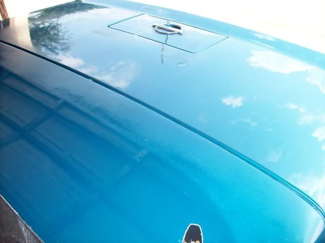

Here is better picture. You can see how the reflections just die halfway up the decklid. (the garage door just disappears)
Again you have to look close to see the oxidation, but you can see some of towards the top of the car in the picture..

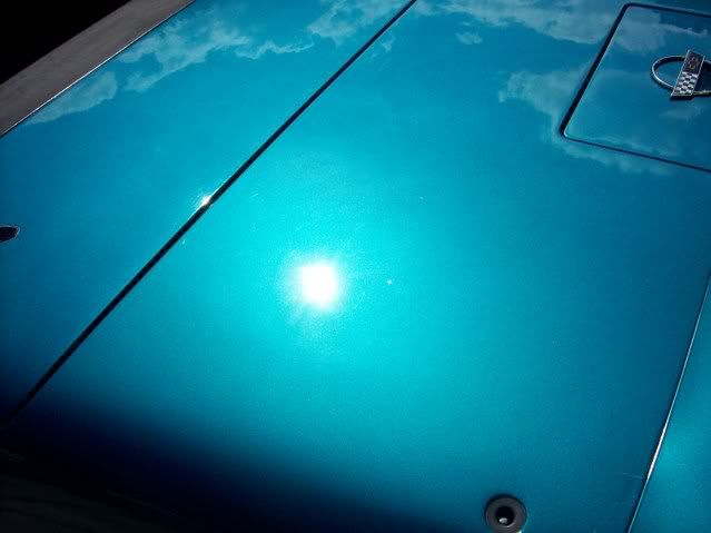

Afters, direct sun shot

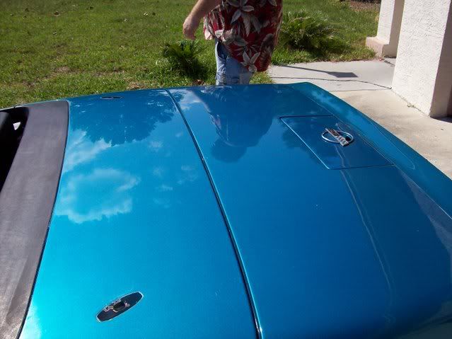

Bruce (Gazpar) inspecting the work

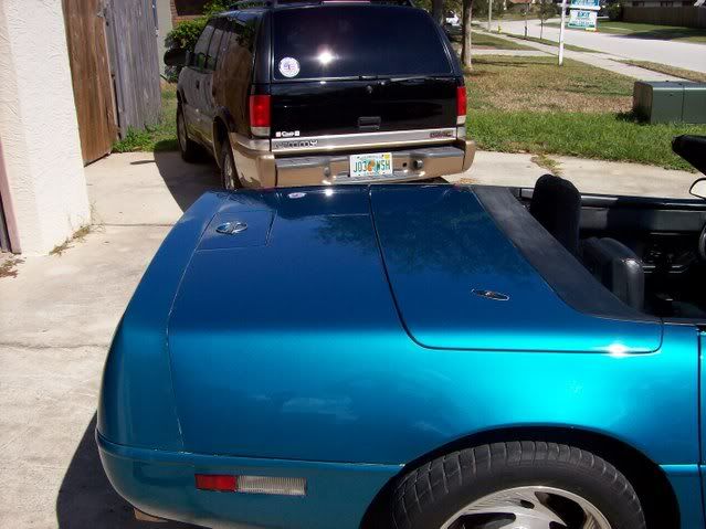

All finished up...
