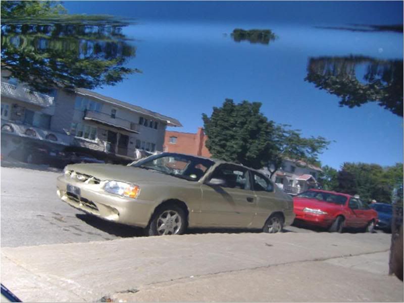

On to the pics...
As you can see there were lots of cobweb scratches and swirls all over the finish.
There were some deeper scratches that I was not able to remove, so it's not perfect, however I am happy that I was able to make it look much better than before and bring out the maximum potential of the finish. My mom and dad have always been great and have always supported me so I think the best feeling of all was being able to give something back to them.
