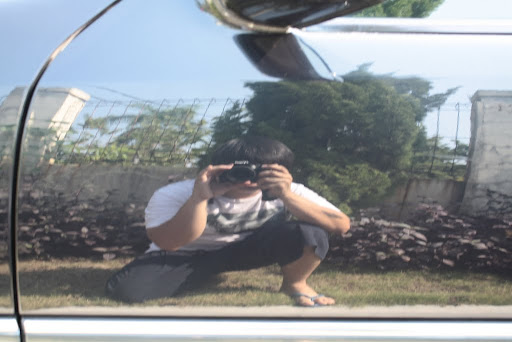

Anyway here are some pictures of the finished product
First, some close up shots of some panels of the car inside the garage and under lights (halogens, fenix led, and camera flash)
Some reflection shots inside the garage
It was early in the morning yet dust have started to build up
Under the sun
I think my exposure settings were off here, the sun was shining brightly , I missed judged the exposure
It got better on this one
In the end the owner (a friend of mine) was very happy with the results and was reinforced with the importance of proper washing regime.
