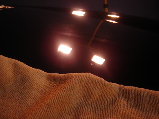

50-50 of the hood / bonnet under the halogens

In the end, between pursuing perfection, balancing it with the owner’s time frame, and doing my day job, it took me around 34 hours to complete this detail (excluding time taken for short breaks and dinner) spanned over the course of 5 days.
Thanks for viewing. As always, comments and criticisms are welcome
