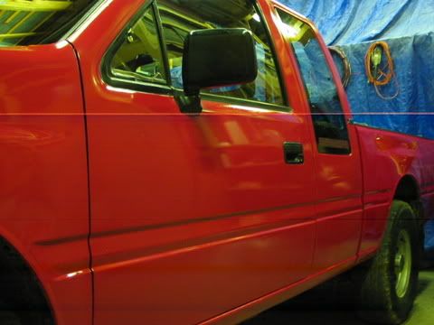

    I'm new to the forum, loved all the before and after pics so i decided to try it out. I did my first detail on a small mazda pickup that a guy from work owned...it was nasty. Its acrylic enamel, except for the left rear panel cause the body shop did it (accident related) and the paint has dust and water bubbles which are not removeable. the paint was exposed to the elements for about a year and a half or so and felt like sand, even claying it only helped a little bit, it needed a major cut/polish in some spots. not bad for 6 hours though.
    BEFORE SHOTS
    the hood was pretty bad
    the roof was worse
    AFTER SHOTS
    this was after #2 cut/polish
    finished product
    Cant remember the details of what i used...but here goes
    Quick clay detail system
    #2 fine cut/polish (#1 Medium, where necessary)
    #6? cleaner wax
    i must confess that i used 2 mothers products in this because i had the stuff and i didnt want to lose too much $$ on this job...
    mothers- scratch remover
    mothers- glaze and protecter
    used the meguiars ultimate wipes for most of it.
    most likely wouldhave gotten a nicer shine with proper meguiars products, but that will come a bit later. As it is this guy has lined me up to detail his brothers car and to paint his dads mazda MR6...(also getting into painting and bodywork and custom fiberglassing) I did this mostly by had but used a rotory buffer (cheap kind) for the cut/polish on the roof and for the final polish)
    once i have a prober PC or something and a good line of Meguires products i should be doing fairly well. I only charged this guy 100 bucks for this cause I'm repainting his truck anyways later this year. his brothers car will be done for 130 bucks but it wont take as long to do.

    Nice transformation. The Pick-up is actually a Isuzu Space cab.

      LOL...o my goodness. That was bad...sorry about that. I always thought for the longest time that it was a mazda so i never bothered to look, lol...oh well. I'm doing his brothers car on sunday so I'll sure post more pics later...i think its an accord, but i think i'll actually make sure this time before i post, lol.

          thanks man. Next project will be able to test the clay out since it has tree sap on it, its supposed to take off sap so if that doesnt work then i'll probly end up doing something else to get it off.

            Clay will remove sap, but there is some varibales. Depends on how old the sap drop is, kind of sap, type of clay, condition of paint. Clay should remove some or most, if not you will employ other methods.
