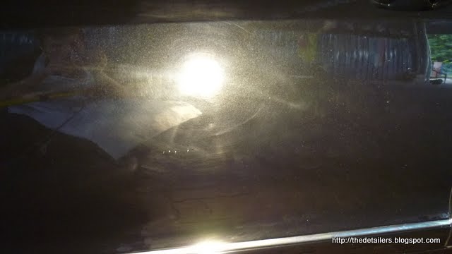

    swirls & later sent to a wrong hand..it got buffing trails (AKA HOlograming)
    another paid to wack Job
    in the worng hand
    this is what happen when it ended with a person with the wrong technic, marring the paint

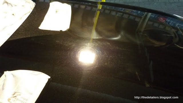

    led torch is good to shine our hologramming
    halogen light is good shine out swirls
    look at the damage

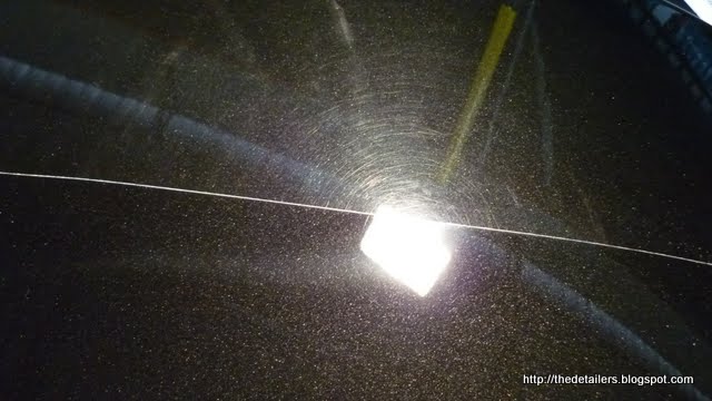

    there are 3 isssue here
    the swirls caused by improper techniques & material use
    2ndly it was sent to detail instead the clear coat get burnt
    3rdly the pad could be dirty or the detailer did not wash & clay prior detailing...look at the round deep scratch..even rounded scratched
    pay pay attention to the hologram
    every pic depicts diffrently
    different strokes

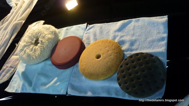

    For body corrections, swirls & rids...i used Makita rotary LakeCountry wool pad with Meguiars M#105 speed 1 to spread & speed 3 / 3.5 to correct
    a multiple passes on different area
    Then step down to Makita rotary with Meguiars Cutting pad with Meguiars M#105 speed 1 to spread & speed 3 to polish
    Polish with Makita rotary LakeCountry CCS polishing pad with Meguiars M#205 speed 1 to spread & speed 2 to polish & speed 1 to finish
    finishing Polish with Makita rotary meguiars polishing LakeCountry CCS Glazing blue pad with Meguiars M#205 speed 1 to spread & speed 2 to polish & speed 1 to finish

    1st 50/50 % comparrision area set
    tad a
    before
    after
    2nd 50/50 % comparrision pics
    look at the before dullness & after brightness
    before look like grey more than black
    wack by the detailer
    ta da, look at the before & after
    eliminated & corrected
    extreme close up pic before & after
    before
    after M 105 2 passes with wool, ticks is still visible & later corrected further
    going
    gone
    this was my choice of Pad combinations
    if anyone can tell u they can do it with just one....alone..he is either a superman or lone ranger
