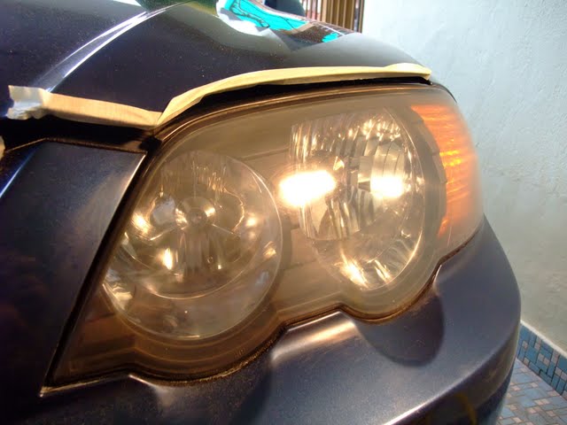

Head lamp & plastic correction by Seech - i will leave it to him to share

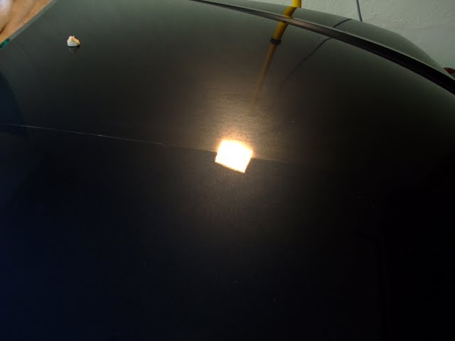

as you can see that there is some heavily oxidation & clear coat wearing out - whitish spots in the centre
cloudy murky surface.......remind me of the song
NOW after touch by Seech TLC
extreme close up shots - seech at work
ma ma mia
ta ta ta
The roof
closer pics
as the neighbour paint his porch & even ignore these damages
pics before
more tiny little spots
pics after

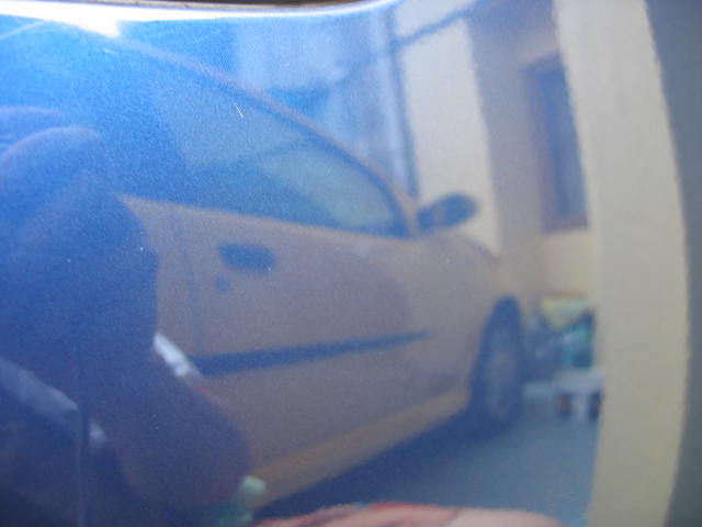

another dents & paint removal
before pics
pics after- ta ta ta

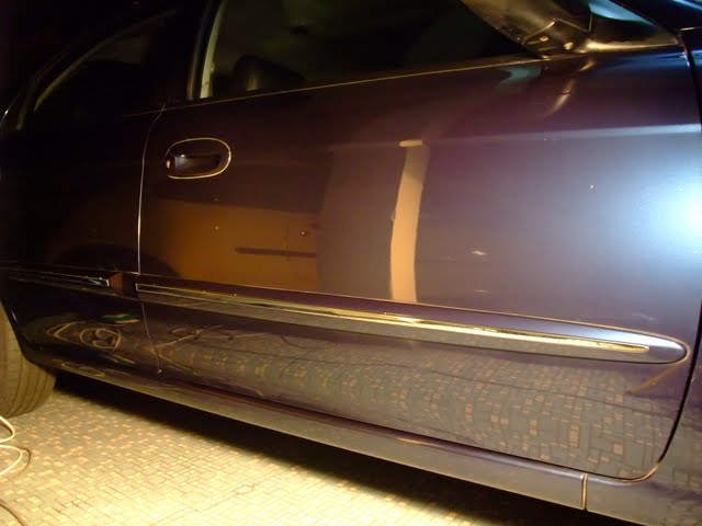

some of the side door
after corrections

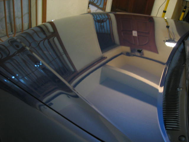

pics of the roof after
