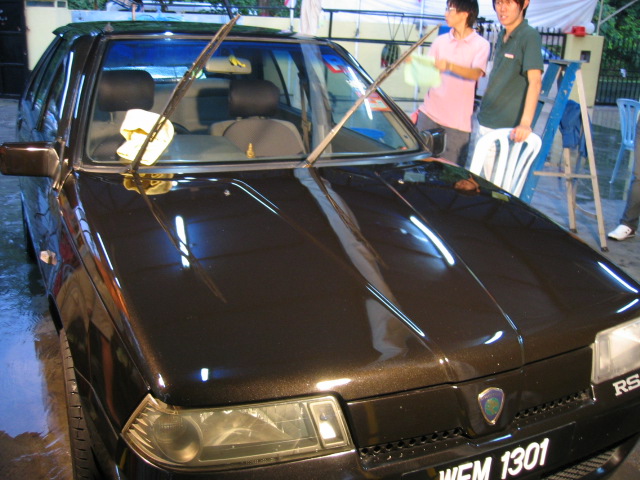

    the front hood was not so bad but some spider attacked & left some signature there
    front bonnet
    claying begin Detailing fanatics Seech did the whole bonnet
    Megs M105 with solo burgundy wool r/speed 1-3-2-1
    wash down with ONR & dry by 2 microfibers
    Megs M205 with Megs soft bun with r
    NXT ed with 2.0 by hand

    Menu for this ride
    Quick was by ONR optimum rinseless wash & dry by 2 microfibers
    Quick clay by Osren Magic clay

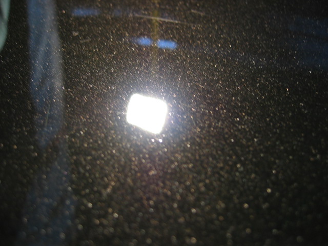

    roof - Hitachi, Fishbonez & me
    compounding with single sided wool/r speed 3 - very minimal effect
    wet sanded with ungrit Megs sand paper 1500
    continue with 2000 grit sand paper
    Rotary/speed 3- Osren Nano Cut 1.1 - with Lake country single sided wool
    continue 2nd sanding, as the oxidation is so severe & our experience detailer suggest go further, as it doesnt have paint transfers on all our wool & pads, mean to say this is repainted
    wash down by ONR
    Meguiars 205 with soft bun to polish /rotary speed 1 -2 -1 - by Fishbonez
    NXT 2.0 hand wax
    initial attempt
    tried to compound off
    but shown no different
    AKA dead paint.....

    self taught legendary detailer aka fishhbonez begin sand off with unigrit 1500 sand paper
    ressusitation begins
    master art at work
    a couple more compunding passes but still alot of pittings - not much of changes
    continue sanding for 2nd time
