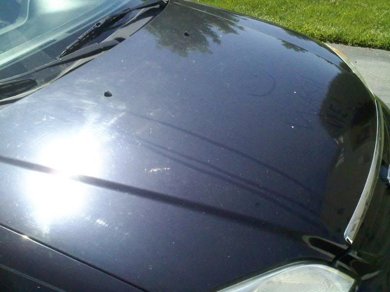

    This is the first complete paint polish job that I've done. I've done a few spots before, mostly on hoods and trunks, but never a complete car. I was a little afraid of doing a black Civic. It scratches effortlessly. Wiping a MF over the paint too hard would scratch it. It took me about 13 hours to do the interior and exterior. Here is the story.
    Proces:
    1) Gold Class Wash with sheepskin mitten
    2) Clay bar every surface
    3) M105 with G110 and polishing pad
    4) M205 with G110 and polishing pad
    5) #7 on the trunk as a test
    6) Tailpipe sanded and polished a little
    7) NXT Tech Wax 2.0 w/ applicator pad
    Insane Swirls
    Video of the walkaround
    [IMG]http://i25.photobucket.com/albums/c61/maxrezn/0521091955a.jpg[/IMG
    The car had about 5 dings before I started so you may see some imperfections in the pictures. The owner was extremely pleased and loved the work. I am now doing her mother's Toyota Avalon.

                    That is a top rate job you have done on youer civic! I have a blue met. civic with swirls.What made the difference for you? The G110? I have trouble getting hold of a G110,let alone swirlX!
                      Re: Black Honda Civic- Swirled to heck and back *Pic Heavy*
                      Without the G110 this job would have killed me. The G110 made easy work of the swirls on Speed setting 5 with M105. Yet I noticed holograms 1/4 way through the car so I reduced the speed to 4. It still removed swirls and left no holograms. I then proceeded to M205 on speed setting 3.
                      Good luck on yours.
