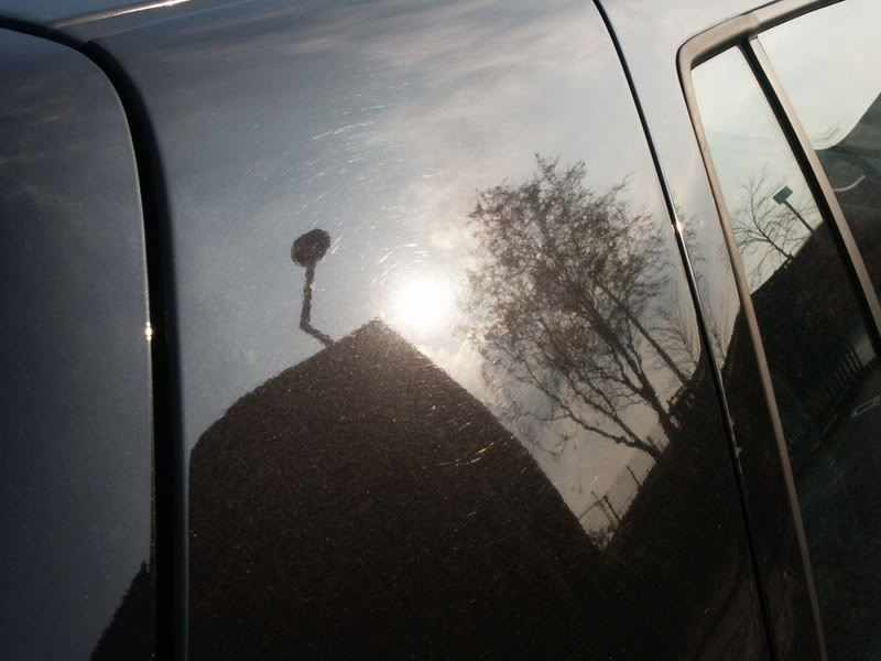

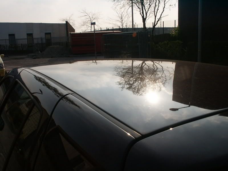

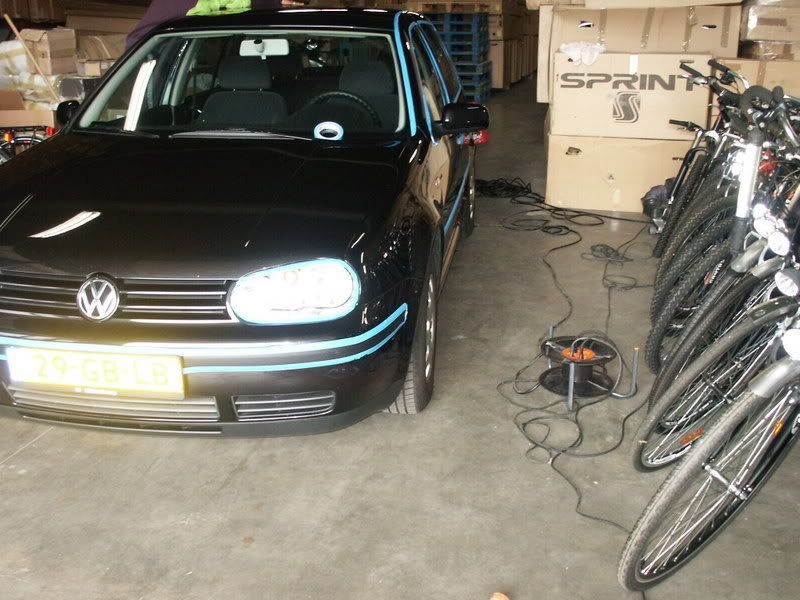

    Yesterday I did a full detail on my neighbours car, a black VW Golf Mk IV. Here are some before pics:

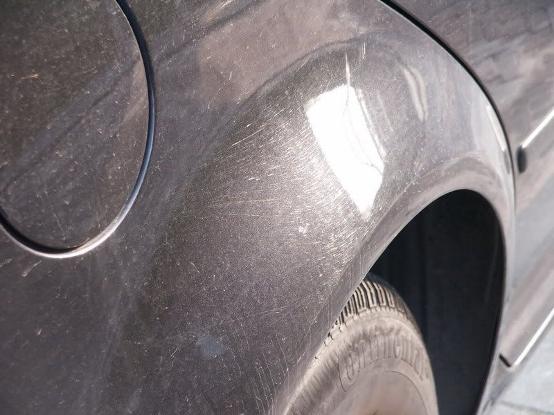

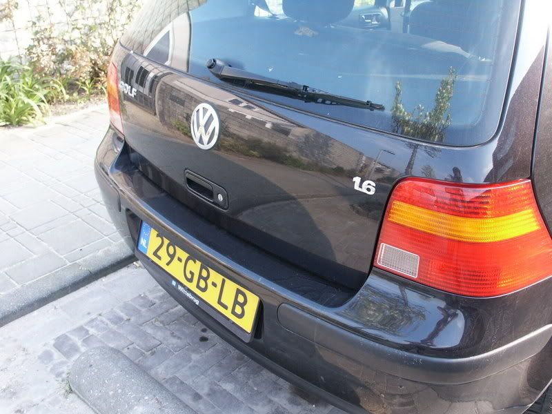

    The car looks in pretty good condition on first glance, but the sun brings out it's hidden secrets:
    Steps taken:
    - Washed the car (the owner did it)

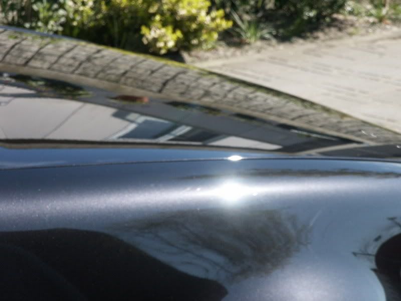

    - Did a testspot on the hood of the car, with #80 and a DA machine (AEG EXE 460 for those who want to know), and #80 did the trick.
    - Started claying the car, and oh boy, it needed that! On some places we had to clay the same spot 3 times to get it smooth! Unfortunaltly the picture of the clay didn't come out that good...
    - Taped the car. The owner started detailing the inside of the car.
    - After the #80 waxed the car with the NXT wax and let it cure for half an hour.
    - Topped it with the Gold Class Liquid Wax
    - The unpainted bodyparts are done with NXT Tech protect, tires with the tire gel, headlights and rearlights with Plast-X
    Here are the pictures!:

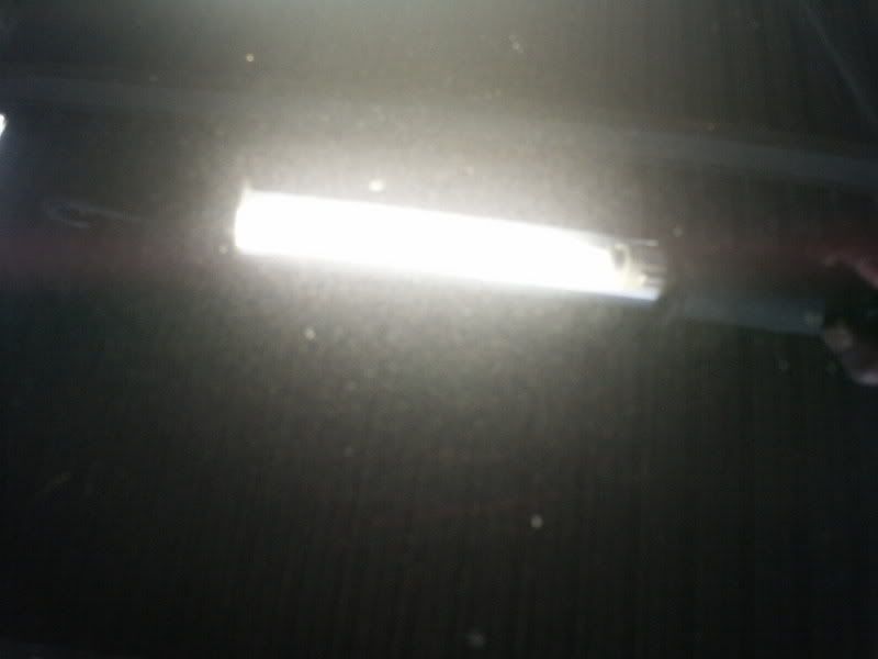

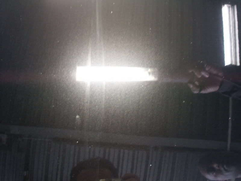

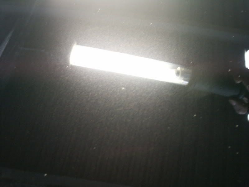

    Testspot:
    Before claying

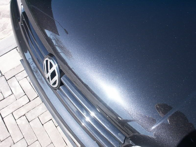

    After clay and #80:
    Taping:
    After #80 and before waxing:

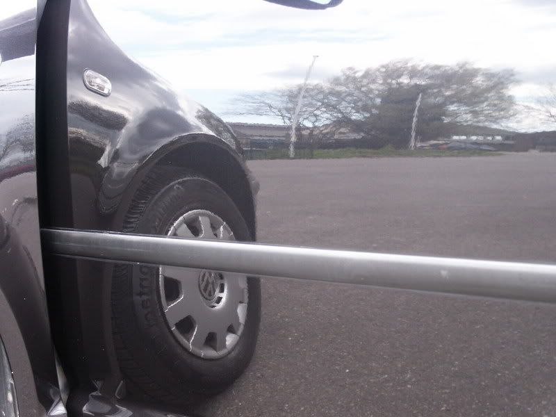

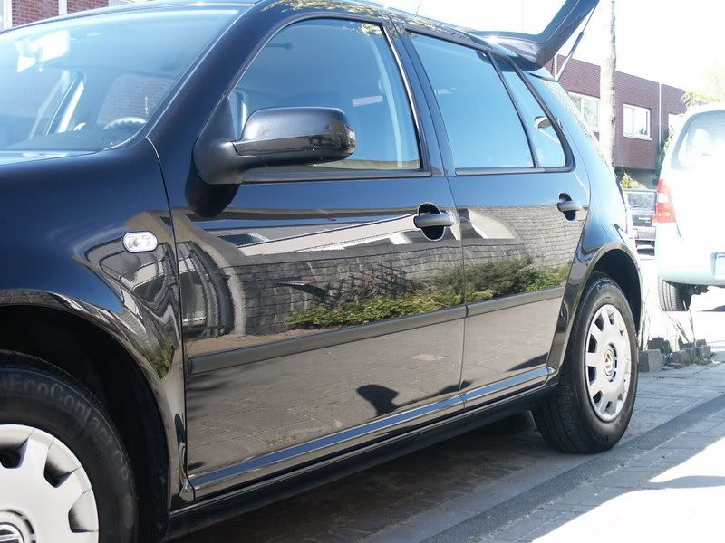

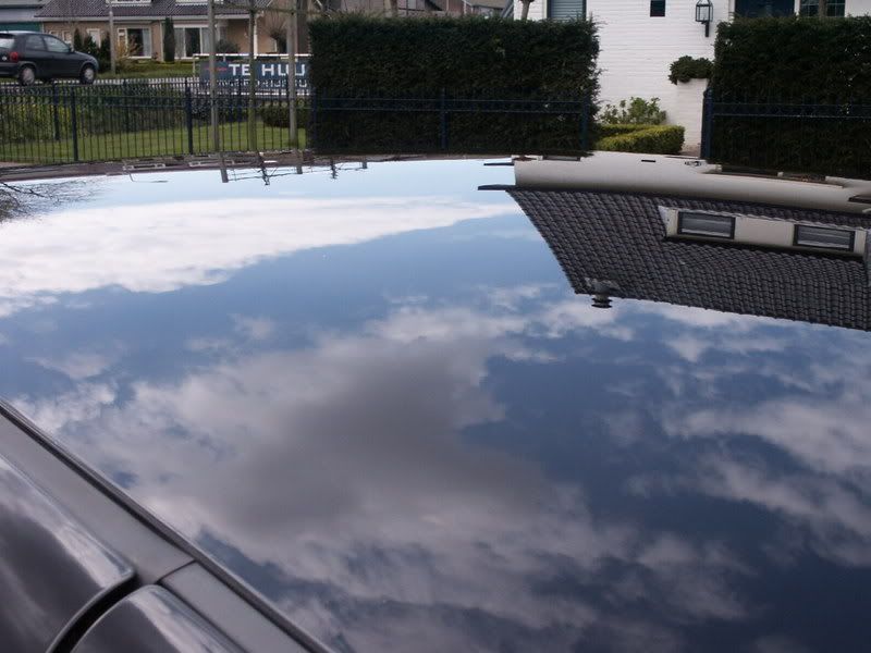

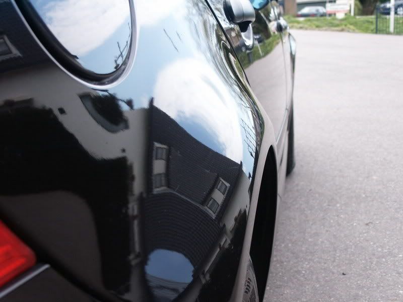

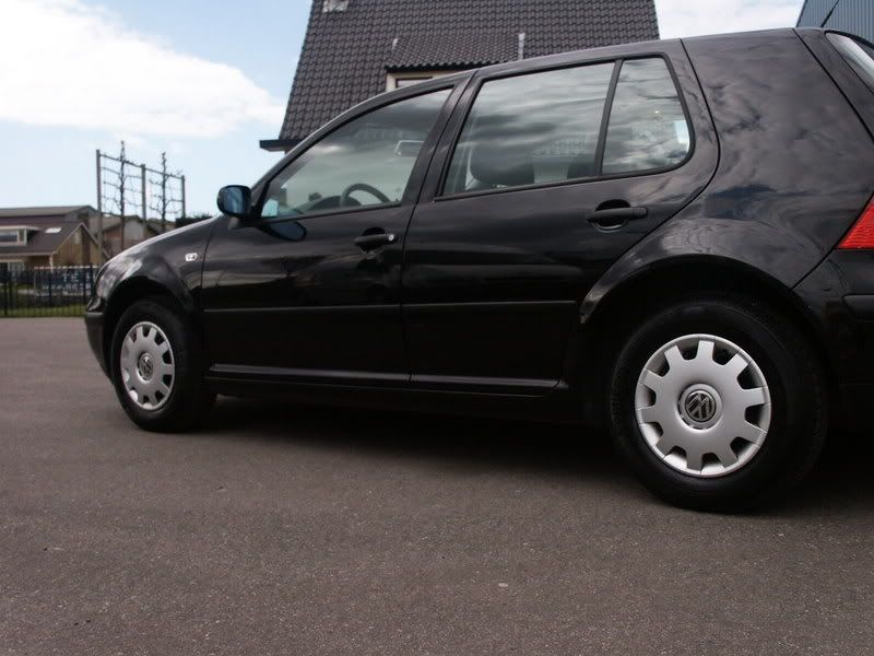

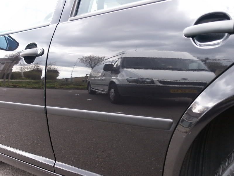

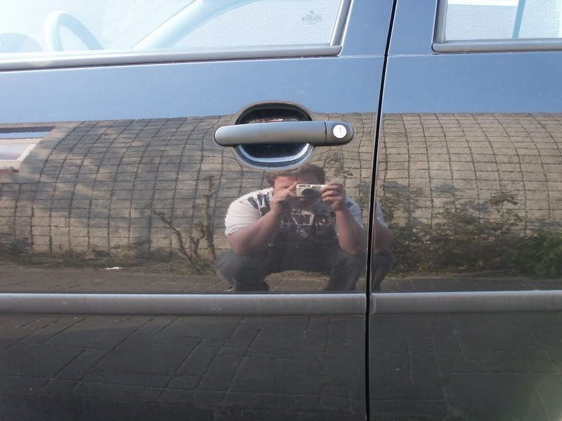

    The after shots and some reflection shots:
    The swirl problem in the earlier pictures is gone:
    Didn't get all the swirls and scratches out, but it's a 90% improvement!

              Very nice work, excellent reflections... I like the cloud reflections!
