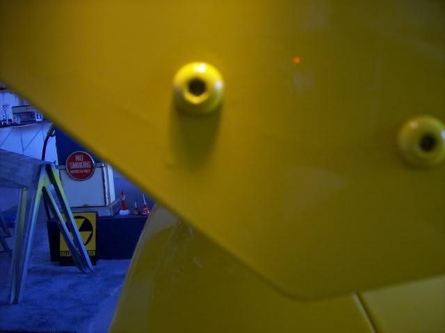

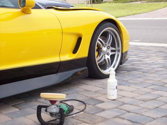

    I taped of a section and made on pass of #83 on the rotary and found that 80 percent of the blemishes came out @1500 RPM
    Different view of the same thing. You can see some specs in the two pictures. These are tiny bits of yellow overspray in the paint from the bodyshop. Again the entire Corvette felt like sandpaper.

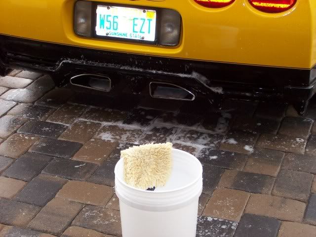

    Day two started out early with an intal wash using the two bucket method...

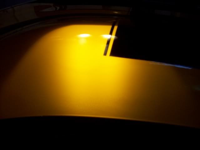

    Some of the marring in the sunlight...

    Then I began by buffing the entire car 3 times with Meguiars DAC/P (#83) on a 8006 polishing pad using the Hitachi Rotary. The first two times @ 1500 rpm, and the time I made my intial passes at 1200 rpm and throttled down to about 600 rpm for the final pass to refine the polish.

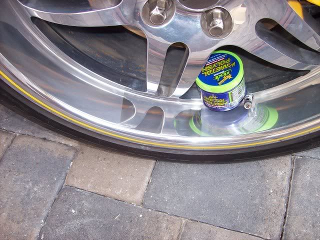

    After washing, claying, wetsanding, buffing and polishign I was getting burnt out on working the paint so I turned my attention the CCW aluminum rims. I taped off an area (to the right, about 3 inchs long) and worked Meguiars NXT All Metal Polysh real well to see if I could notice a difference....
    Side by side with the unfinished areas

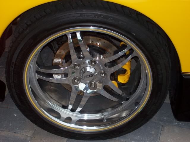

    Seeing a big difference I set off to polish each rim by hand but after spending the better part of an hour on the first rim I had to increase my efficency. I put a Meguiars 9006 finishing pad on the rotary and loaded it with Meguiars NXT All Metal Polysh. Then I polished the rim at 600 rpm until the rim was covered in black paste. I wiped clean and repeated for 2 passes per rim. Then I used a microfiber and polished all the nooks and crannies.
    End result was a chrome like finish that was haze free and deep...

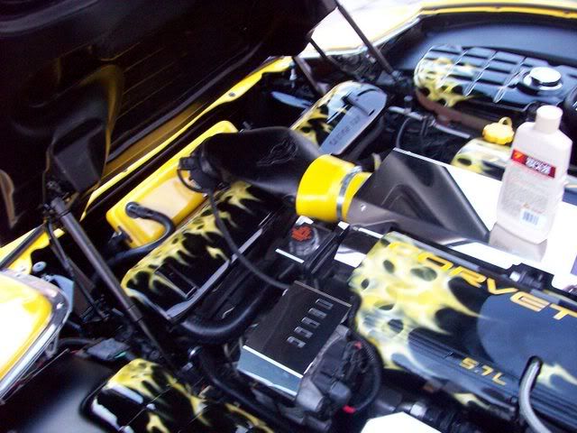

      Day three started with a detour into the entire bay. The engine bay and paintwork was first wiped with a damp chamios then Last Touch Detailer spray and a microfiber. After all was clean the rubber and plastic was treated to Meguiars Hyperdressing cut 3:1. The paint work under the hood including the covers and jams recieved Meguiars #7 and Meguiars #21.

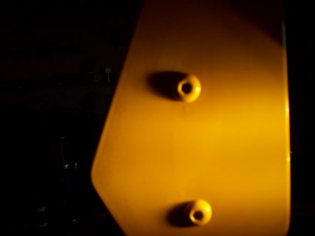

      After finishing with the #82 the once scratched and rough paint was now perfectly smooth and defect free (to the 99th percentile). I am not sure why the glare appeared in the picture as there where no defects...

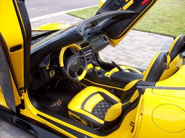

      I also started on the interior by vacumming and shampooing the carpet with APC. Then I used qtips and interior detailer to clean every crevice.
      Then I applied a second of #21 and went back to the interior. Meguiars Natural Shine on the plastics and leather conditoner on the expansive leather that covered the interior...

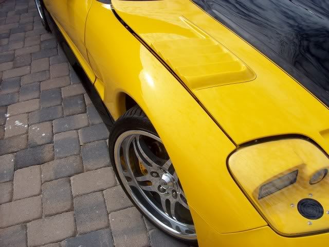

      I pulled the car into the garage for the day and snapped off a couple pictures to show the awesome reflectiveness of 21 on a properly prepped surface...

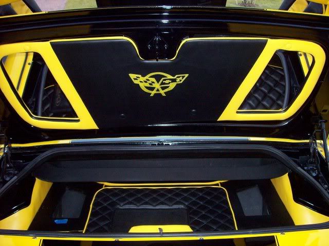

        Then I remember that I forgot the trunk.
        Okay, the afters..

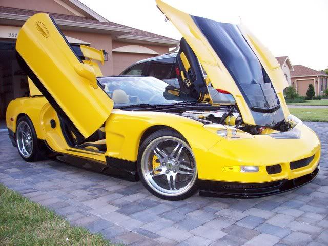

                        The custom body is hand laid fiber class and is one of a kind. His son had built it before passing away tragically at the age of 22. Its a six speed transaxle with a 4:10 final gear.
                        The engine is a stoked LS1 with a STS twin turbo set up.

                              question...whats the little fan thing in the head light?
