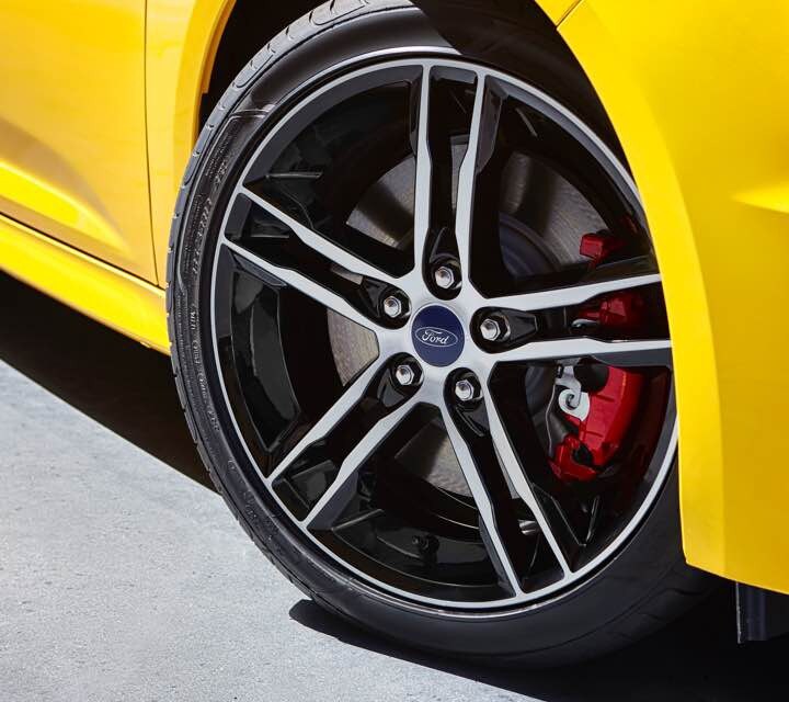

            Oh, and one other thing - I've already asked Brian this but will put it to the group as well. Can anyone confirm that Hot Rims is safe for factory painted wheels, specifically the alloy & black factory-options on the new Focus ST? After this experience with our old MR2, I'm highly paranoid of using Hot Rims on the car that we're actually making payments on...
            Here are the wheels in question:
