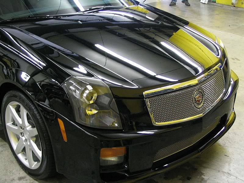

                        Here is just one of the many examples that I have of #80 in action. I love it and buy it by the gallon.
                        Whether it fills or not, I don't know. Honestly, i don't really care either, it works I know that.
                        Only on eapplication od M80 with the PC and meguiars polishing pad, no wax. BTW, this car still had drive-out tags on it, it was delivered this way.
                        Finished product.
