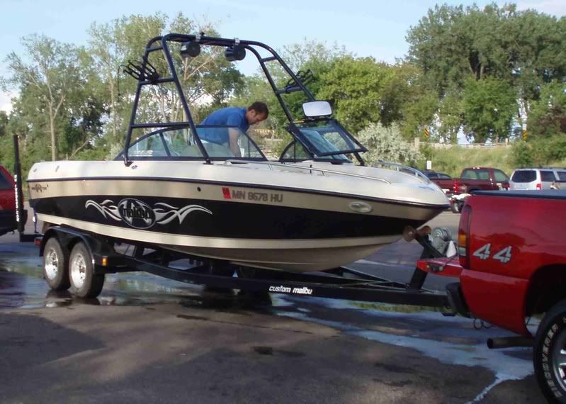

    So my friend wants to polish out his boat Thursday and I was wondering what you guys thought would be the best approach for him. It only has some light oxidation and I was able to make a noticeable improvement using M49 by hand in a small spot last year. He only has 4-6 hours to polish it and will be using a PC 7424 with W-8006/W-9006 pads.
    I was thinking M49 followed by the Flagship Premium Marine Wax since he has both. I don't think there will be time for M45.
    The boat is a 2000 Malibu pictured below...sorry, only pic he had.

          Hey Mike. M49 with a W8006 turned out to be the best combo. M44 was working but was still leaving the finish a little hazy.
          I actually ended up working on it with him for about 3 hours and was able to get about 75% of the black done before I had to leave. He was very impressed with the results and by the time I left seemed to have a good hang of the PC. I left my PC behind and showed his roommate how to use it as well, so he also helped out.
          The owners camera had gotten wet and wasn't working properly. I snapped a picture with my phone but the quality is very poor. He was going to have someone bring a camera over an take finished pics so I should have some next week.
