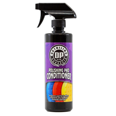

          I recently acquired some XMT Polish pad conditioner. I haven't used yet but hopefully it will aid in my detailing jobs
          DP Polishing Pad Conditioner - Dont forget, your pads need some conditioning too! With detailing, no step is too small, that includes making sure your polishing pads are ready to go. DP Polishing Pad Conditioner primes new and freshly washed pads ...
          Opinions on this product??
