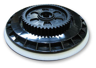

    No - Flex uses a proprietary backing plate system for the 3401 so a "traditional" D/A backing plate won't work on it. They did recently introduce a smaller backing plate that is being referred to as a 4" plate, but it measures more like 4-3/8" and is designed for use with 5.5" pads.
      Re: Is it possible to use 4'' Pads on my Flex D/A?
      If by Flex D/A you mean model XC 3401 VRG then the answer is no. You need to use the special backing plates and S3BP doesn't fit.
      There are only two backing plates which fit into 3401: 5.5" and 4 3/8":
      FLEX XC3401 Mini 4.5 inch Backing Plate - Now you can use 5 or 5.5 inch pads with your FLEX XC3401 Dual Action Polisher! The FLEX XC 3401 VRG Mini Backing Plate is 4.5 inches in diameter and allows you to use 5 or 5.5 inch pads with your FLEX ...
      Flex XC 3401 VRG 5.5 inch Backing Plate - Genuine factory replacement backing plate! The Flex XC 3401 VRG 5.5 inch Backing Plate is an authentic factory replacement for the original backing plate included with your FLEX XC 3401 VRG Polisher. The ...
