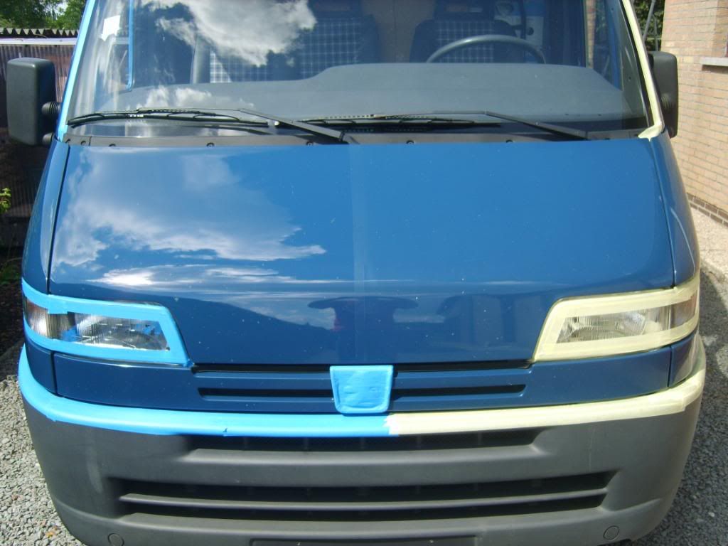

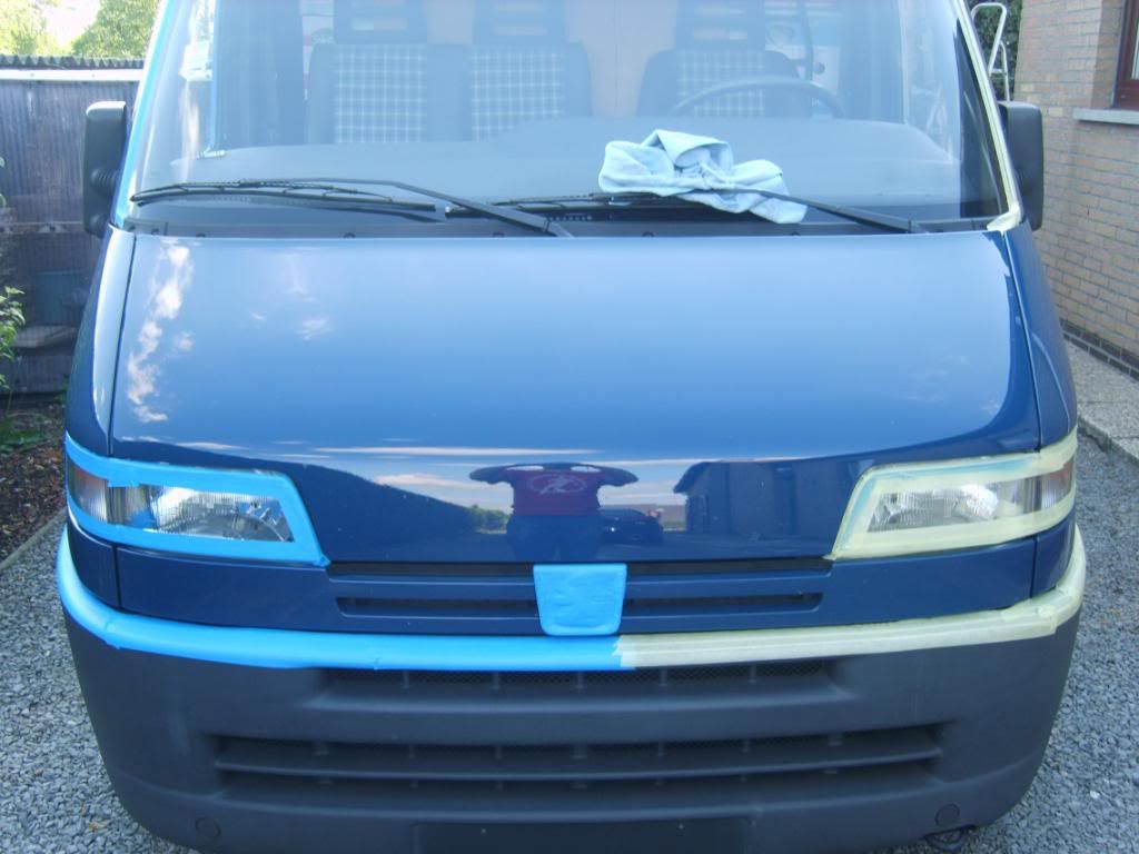

          Cuttingpads work very well on a DA ,i use them on heavily oxydized paints in combination with M105 .
          Look what you can achieve with a DA & a cuttingpad & M105 !
