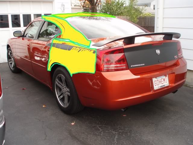

    The 2006 Dodge Charger Daytona R/T was washed to remove dirt and grime from its Go ManGo clear coat finish. Next the areas highlighted in yellow were cleaned, polished, and waxed using the Porter Cable 7424 dual action polisher, Meguiar's DeepCrystal System, on an orange cutting pad, and finished with a gray finishing pad.
    The Meguiar's DeepCrystal System consists of three steps:
    Step 1 = Paint cleaner safely removes light swirls and surface blemishes
    Step 2 = Polish creates a brilliant high gloss finish
    Step 3 = Caranuba Wax delivers brilliant shine and lasting protection
    I used the orange pad on speed setting 4 for Step 1, followed by a fresh orange pad on speed 5 for Step 2, followed by the white pad to apply Step 3, and finished with the gray finishing pad.
    Nice, but needs more of a deep lustrous shine.
    Areas in yellow cleaned, buffed, and polished with DeepCrystal 3 Step system:

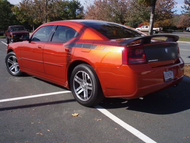

    Results:

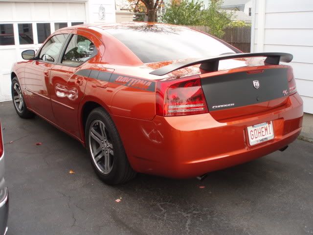

    Wow, what a nice shine!

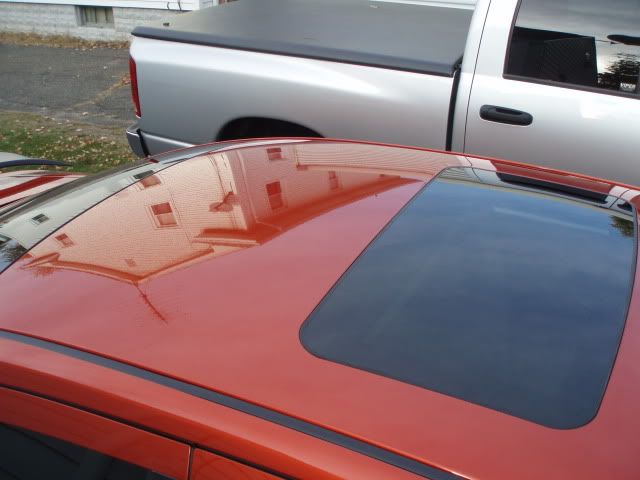

    That roof is like a mirror! I could do my hair in it.

              Nice work, nice reflection shot of the hood...
                Re: Go ManGo PC Dual Action Polisher Fall Makeover (Pics!)
                Love that color!
                Roof! LMAO.

                          You can really tell the difference. It is more of a true vibrant and wet looking color.
