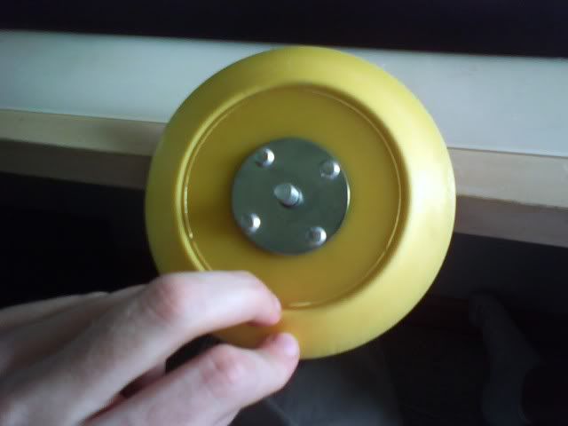

    I recently purchased a Porter Cable 7424 along with a DAS Flex 5' backing plate. Well I finally got a chance to use it and had a issue with it. As soon as I applied pressure to the buffer, it began to lose power, I took it apart and found that the 4 round things on the backing plate were desteroyed from most likey the counter weight.
    So my question is, did I order something wrong or am I not doing something right?
    EDIT
    Here is a picture of what I mean,

    The design of the backing plate varies depending on the manufacturer.
    To correct your problem with this plate you will have to but a spacer on the threaded stud before attaching the plate to the PC. Porter Cable supplies a hard fiber washer for this when you purchase the Porter Cable 7336 sander-polisher. The one they supply is about 1/8" thick; not sure what thickness you will need for your plate.

      Would it be possible to just make my own spacer?
        Re: PC Backing plate, issues
        You probably could be it would be better to just get the right backing plate for the tool. The store that sold you the DAS pads should carry them and we offer a really nice one that is manufactured in a way that makes it a one-piece unit so the Velcro cannot de-laminate.
