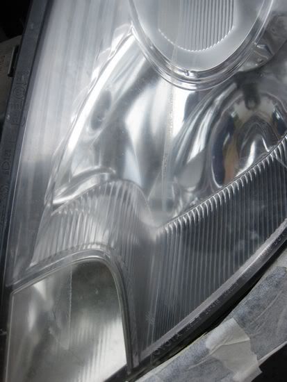

    Did this for a friend of a friend. Im not sure what he tried to do before, but you can see he tried to scratch the oxidation out. I could've gotten all the deep scratches out if I had more time, but I only had an hour..long story.
    I started with 1500 grit horizontal motions, then followed with 2k vertical motion. Once even, I followed with M105, then full throttle, then PlastX, and sealed with Rejex.
    pass side:
    1500 grit:
    2000 grit(I did another pass after the pic because I noticed some spots were missed):
    Final Product:

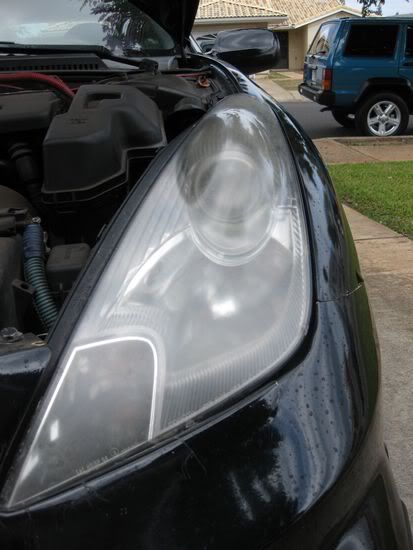

    here is the first one I did:

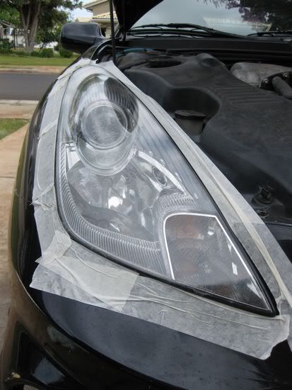

    My neighbor's friend has a Celica. The headlights were pretty hazy. I told my neighbor to let his friend know that I'd like to try and clear them up for him. Well, he decided to let me do it.
    I used a PC with a 4" orange pad and a combo of products.
    Here is what the driver side looked like before I go a hold of it:

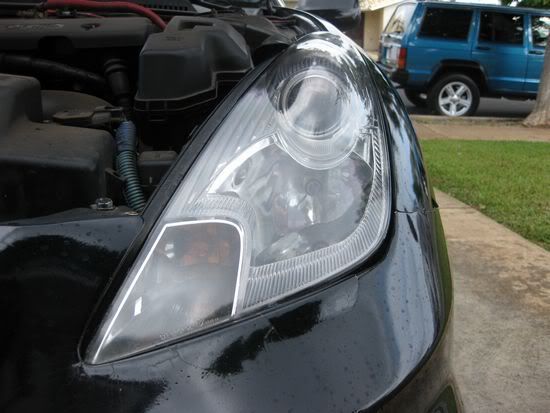

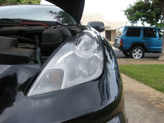

    I used MX7 metal polish on 1/2 of the light so I could do a 50/50. The results:
    After a couple passes of that, I cleaned the residue off and applied some Rejex to seal it:

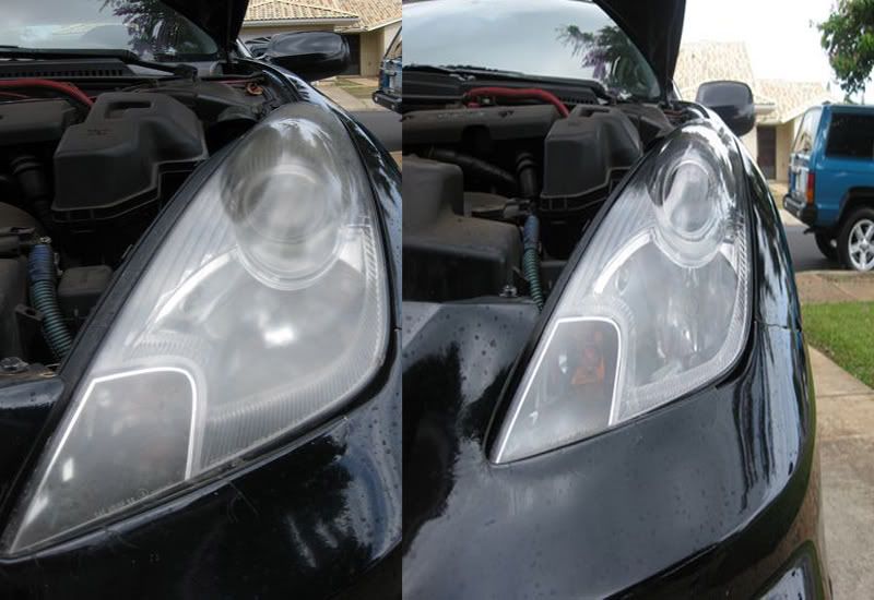

    A side by side:

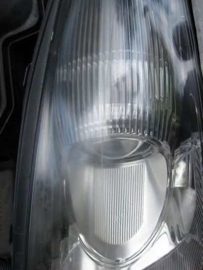

    This is the passenger side:
    I initially started out with just PlastX and it did a great job, but there was cracking and I wasn't sure if it was inside or outside of the lens. I used some FT to see if it would cut it down at all. No luck, it's on the inside.
    Overall, the PlastX and MX7 metal polish worked very well on their own! He and I were both very impressed I honestly thought that I was going to have to sand them down, but 10 minutes later, done!
