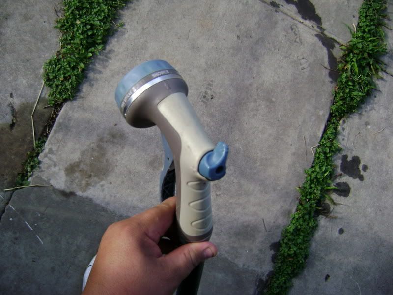

            Ok well i have never covered anything and have never had any problems but at the same time i don't attack an engine bay with a pressure washer or any kind of high pressure water. I use a simple attachment on the end of my hose that lets me adjust the over all amount of water it puts out as well as the type of spray with a pressure sensitive trigger to manually adjust the water pressure even more. With this attachment i can make the water flow very very light as needed when working around wiring connections. I don't have any pics of engine components to cover up but i will post some pics of the products and tools i use along with a pic of the hose attachment. Ok well alot of people use a product like APC for there engine bay but i prefer using super degrease, you can use it around 4 parts water 1 part super degreaser. When using this product you will want to make sure to spray down the side panels of the car to and do it a couple of times during the process of the detailing. This is to make sure no degreaser sits on the side of the car staining the paint. First thing i do is rinse off the engine bay getting rid of any large particles but don't set your attachment to pressure stream and aim it at a wiring connection. Avoid doing that and you should be safe. Just try and keep the flow light just to be sure. After rinsing i mist areas that need to be scrubbed with the super degreaser working one area at a time so the super degreaser is not sitting on one area to long because it can also stain plastic as well but you can let it sit for at least a minute or so with no affects when diluted to this rate. After misting down one section scrub the area with a light brush to not damage anything like the blue brush shown in the picture below and then use the paint brush to get into those hard to get areas as well as on the paint since the other brush is a little more harsh and can scratch the paint. After you go over the area give it a light rinse down and then proceed to the next area but don't forget to periodically rinse the side panels of the car and anywhere else you might get the degreaser. Once the engine bay is finally complete give the engine bay one last rinse down and then i recommend hitting it with a leaf blower or air compressor to help dry off the bay and remove any sitting water in those cracks and crevices. Now you should be ready for a product like Hyper dressing which works great on Engine bays and can also be diluted to your desired shine. Which i like using a little foam brush for the application of the hyper dressing. Don't forget about all that metal so make sure to polish off any polishable metals with something like NTX all metal polish or Hot Rims mag and aluminum polish. OK well here is a pic of all the things i recommend under the hood. As i have stated in other post the only thing missing that i use under the hood is Turtle wax Ice polish just because it is easy and you can really get to all the painted surfaces in the engine bay without worrying about getting the wax everywhere because the ice can go on just about anything and be fine.
